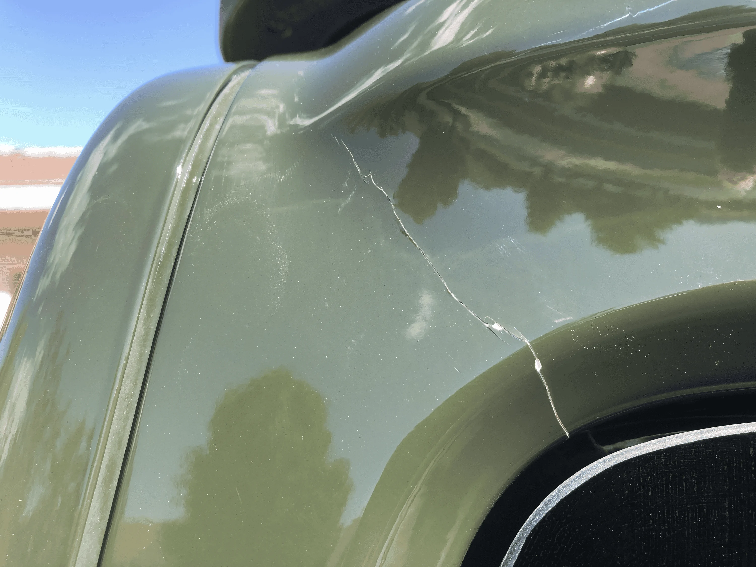

I post a thread the other day showing I have a exactly same crack on my 2018 JLUR with 42k miles no impact no roof rack.

I don’t have anything on my roof, yet it still cracked.

I was also at a recent event, The Rubicon Jeep Jamboree and several people were talking about this. I did check my roof and there is a small crack in the upper back corner of the hardtop. I don't have a rack system. I also have a whistle noise from the front of the roof which drives me crazy, I have a freedom three piece roof. Does anyone know of this is a warranty issue? Thanks!

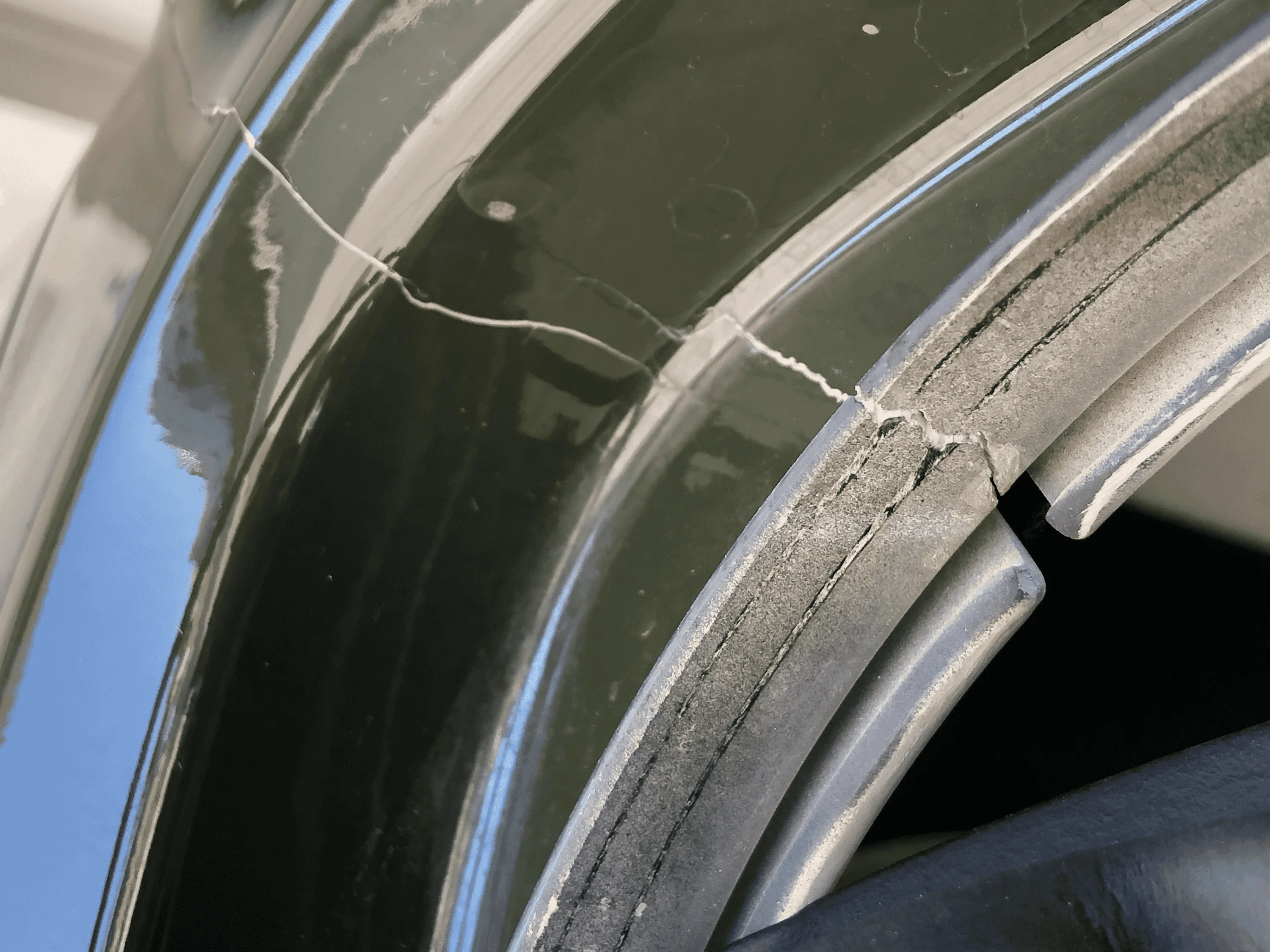

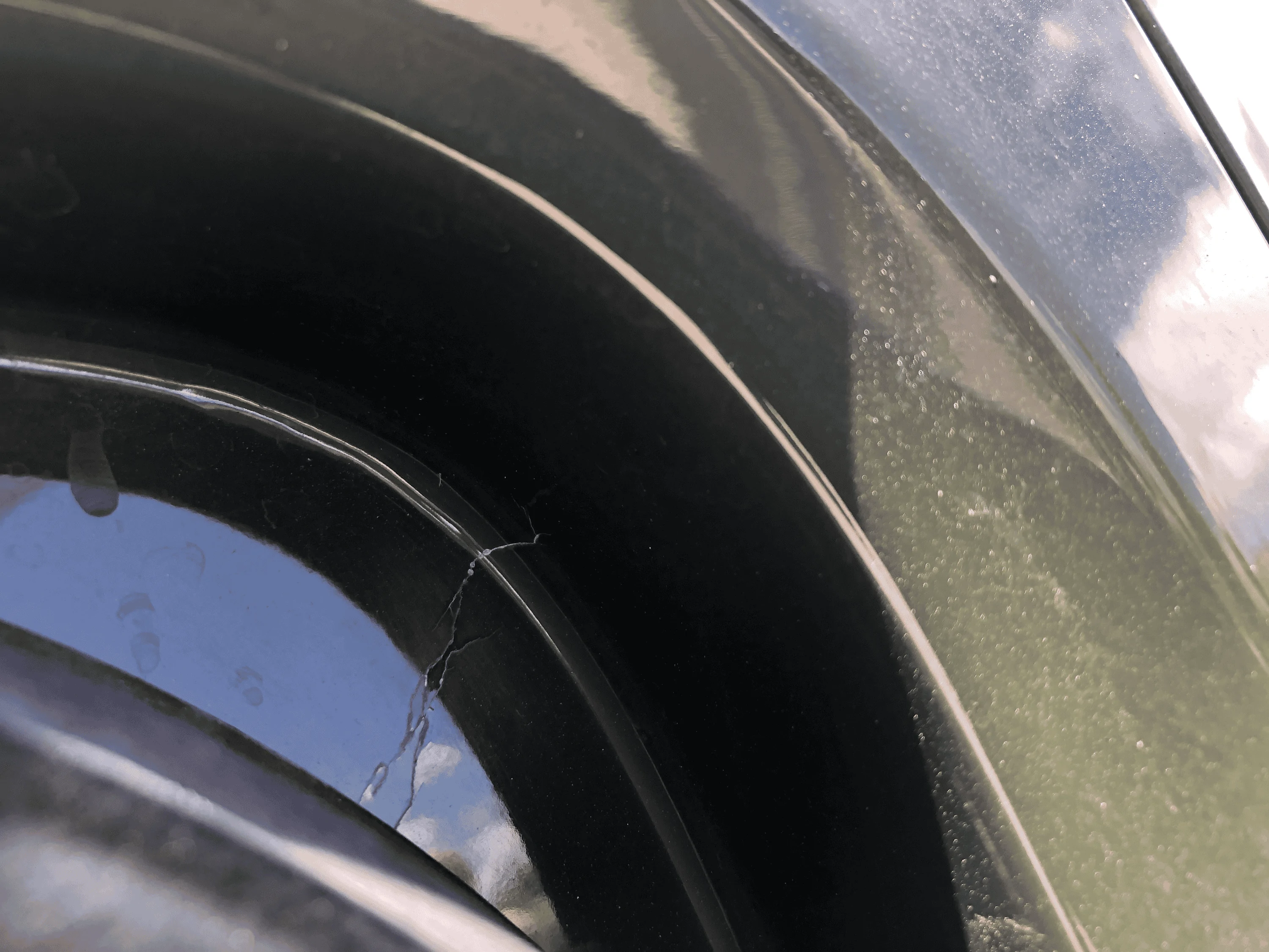

I have a '21 JLU Rubi with Rhino platform and Maximus-3 support system. This is happening to my top as well. Cracks on both the driver and passenger sides of rear window frame. I have never had more than 50 lbs of cargo on roof. Fought this with Chrysler Jeep to no avail. A new painted top delivered and installed is $5,700.
My first observation is that the cracking/stress is occurring on the rear window area; not the side windows, or anywhere else on the top - yep, just the rear window area. Ask yourself - why this location? There doesn't appear to be any direct weight on the rear of the top. There are no bolts tying down the rear of the top, just the sides. Is the tailgate with tire pushing or stressing the back window in some way? FYI, There is a tailgate adjustment - could it be that adjusting this to the extreme, causes the tailgate to constantly put pressure on the back window, thus causing a crack at the corners?
Has anyone figured out what is causing this? Same type of cracks on both racked roofs and non-racked roofs. Cracks are in same location. Cracks all begin at joint. Ideas? Resolutions?
