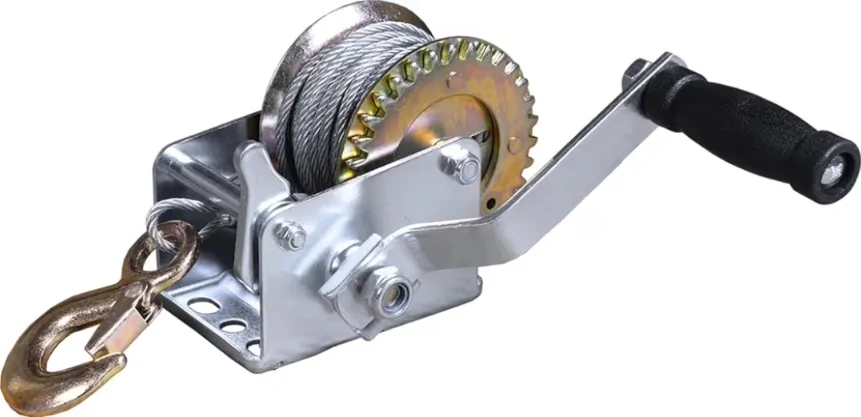

For my camper top install, I used the wood from the delivery container to build a hoist frame and added a ~$20 Amazon hand crank winch.
Jeep Wrangler JL hard top hoist for adding a camper top 1000005661
