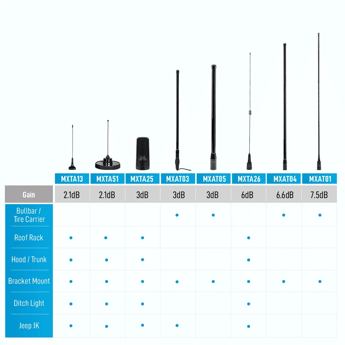

Any recommendations for a mobile half wave (no ground plane) GMRS antenna I can install on my spare tire carrier/rear gate? Not concerned so much about cost, prefer better performance. Mounting ideas appreciated too.

Have you looked at Midland's micromobile offerings?

I think I would ask them directly. They have come up with this, I think to help folks, but they don't use the standard language (wave). It's probably the same, but they have tried to dumb it down, and then made it ambiguous. Bullbar means no ground plane?
