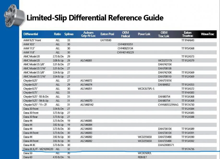

I can't say what my jeep would have come with had it been ordered with a LSD from the factory. When I decided to add an LSD to my jeep, I did not find a Trac Lok for an M220 rearend. I was today years old before I learned that it was possible. When I was shopping for my LSD all I found was Truetrac. My understanding is that even though many after market sources list my rearend for a JL as a DANA 44 the ring gear in the Dana 44 and the M220 that is in my JL are not the same size and the carriers will not interchange. The list below was one of my primary sources of information. It is a differential guide list from West Coast Differentials.. Even though they list the Trac Lok for the Dana’s, they don’t list one for the JL’s M220.
https://differentials.com/limited-slip-differentials-application-guide/
You have to look at more than just one company to find it.
Basically, no one buys the TracLoc aftermarket so few retail companies even list it.
And yes, the M220 is not the same as a Dana 44. The M220 is what the 44 evolved into, with a halfway step being made with the JK axle.

If you're talking about the Truetrac it's not a clutch based LSD. As the image below indicates it’s a helical design. The Spicer Trac-Lok is a torque-sensing, clutch-style limited slip differential.
Truetrac
Truetrac
The truetrac is not installed in the JL from the factory. I think the Power Wagon had an option for this maybe, that's about it.
