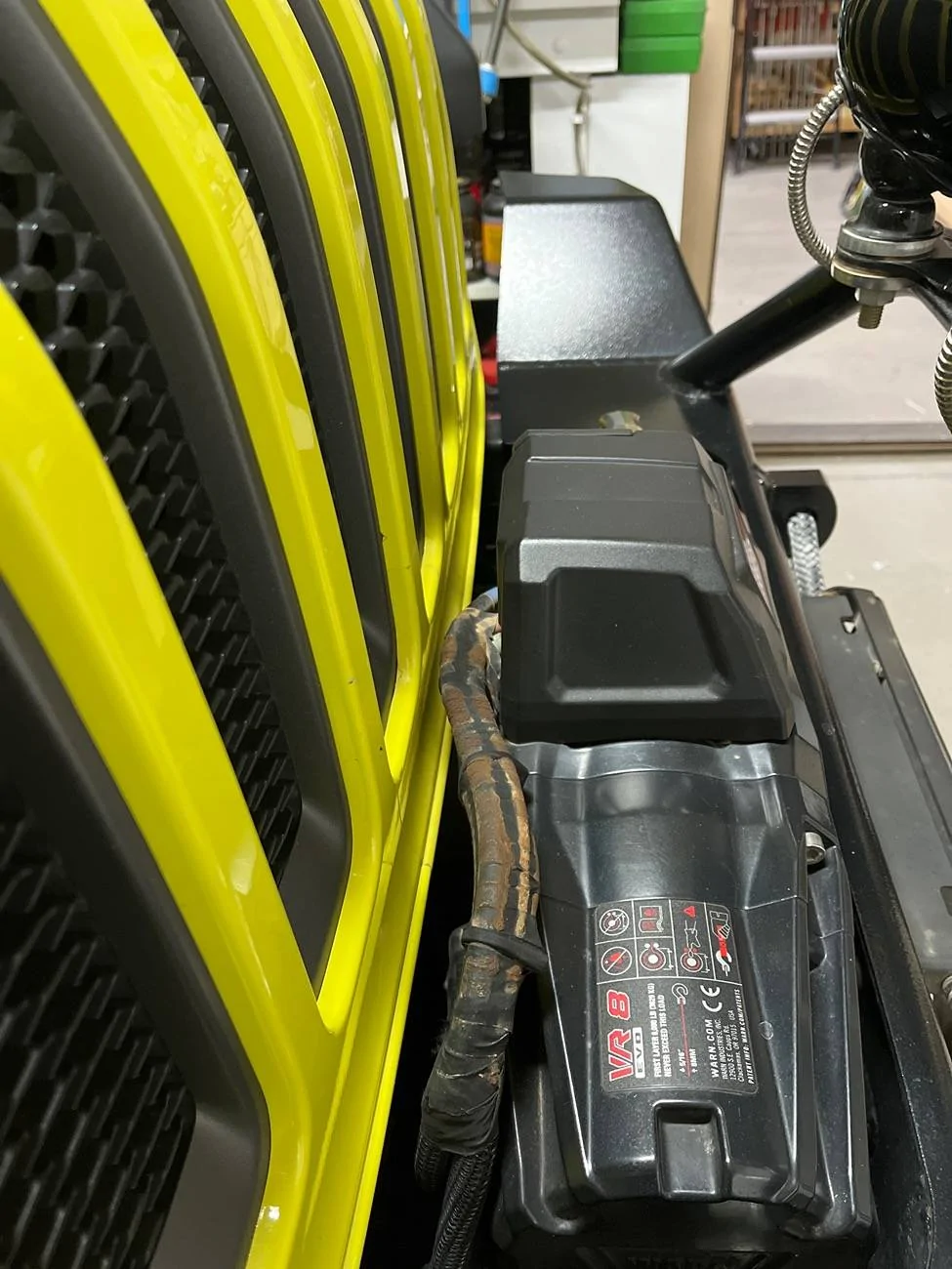

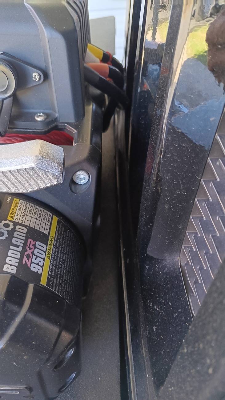

I have a Rock Hard 4x4 bumper and Badlands winch. No clearance for grill removal. I rerouted the winch cables to the side instead of the rear and still no go. I found a hack. I had to loosen the bumper bolts, remove the grill and cut of the 4 middle clips. I believe there are 6. You leave intact the outside one on each end. Now I can remove the grill without having to remove the bumper bolts.

I removed the control box on my winch and that gave me enough room to get the grill off.
I then removed the middle 4 clips with a grinder so I can pop the grill on and off a needed.

I have a Warn XD9000 winch on an OEM steel bumper. The first time I tried to take the grille off I thought it was not possible without removing the winch. The grille first makes contact with the winch wires. The second time, I played around, stressing the grille and hoping it wouldn't break. It ended up coming off past the winch without damage. I would suggest putting something thin and slick between the grille and winch to help it slide past it.

I had the same issue with my JK. The winch was pretty tight up against the grill, so much so that the winch wiring had worn the paint off off the grill in one spot. I was able to pull grill down and get enough room to work and switch out the headlights.
Not sure if the same would be possible on a JL or not. The JL grills are a bit more rigid, but it's worth a shot.

I don’t know why folks live with this issue, Rockhard 4x4 bumpers come with long bolts and spacers, I just added a little more, I lost about 1/2 degree of approach angle but I can also remove the grill easily, also prevents cable rubbing, discovered that on the first Jeep we had where they wore a groove in the grill

Unfortunately my bumper & winch sets fairly tight against the grill. If I have to remove it. It's 8 bolts for the bumper, I stack cinder blocks and wood and slide the bumper off winch and all.
Someone posted the lights could be accessed from the inside, no need to remove anything. I have not done this yet.
I have the same issue. Both the winch control housing and wiring are up close to the grille, and the actual top plate of the winch bumper only has about 1 inch of clearance. I'll also have to remove the entire assembly to install LED bulbs. I've seen the access hole in the back of the assembly in the engine bay, but everything I've watched shows removing the assembly to replace the bulbs. I also don't think my gorilla hands would fit inside the opening from the engine bay.
It's sucks, but I'm not willing to scratch or break my grille trying to "make it work".
I like the idea of setting up blocks to slide the bumper onto without removing the winch. Just disconnect the wiring at the control housing and slide forward.

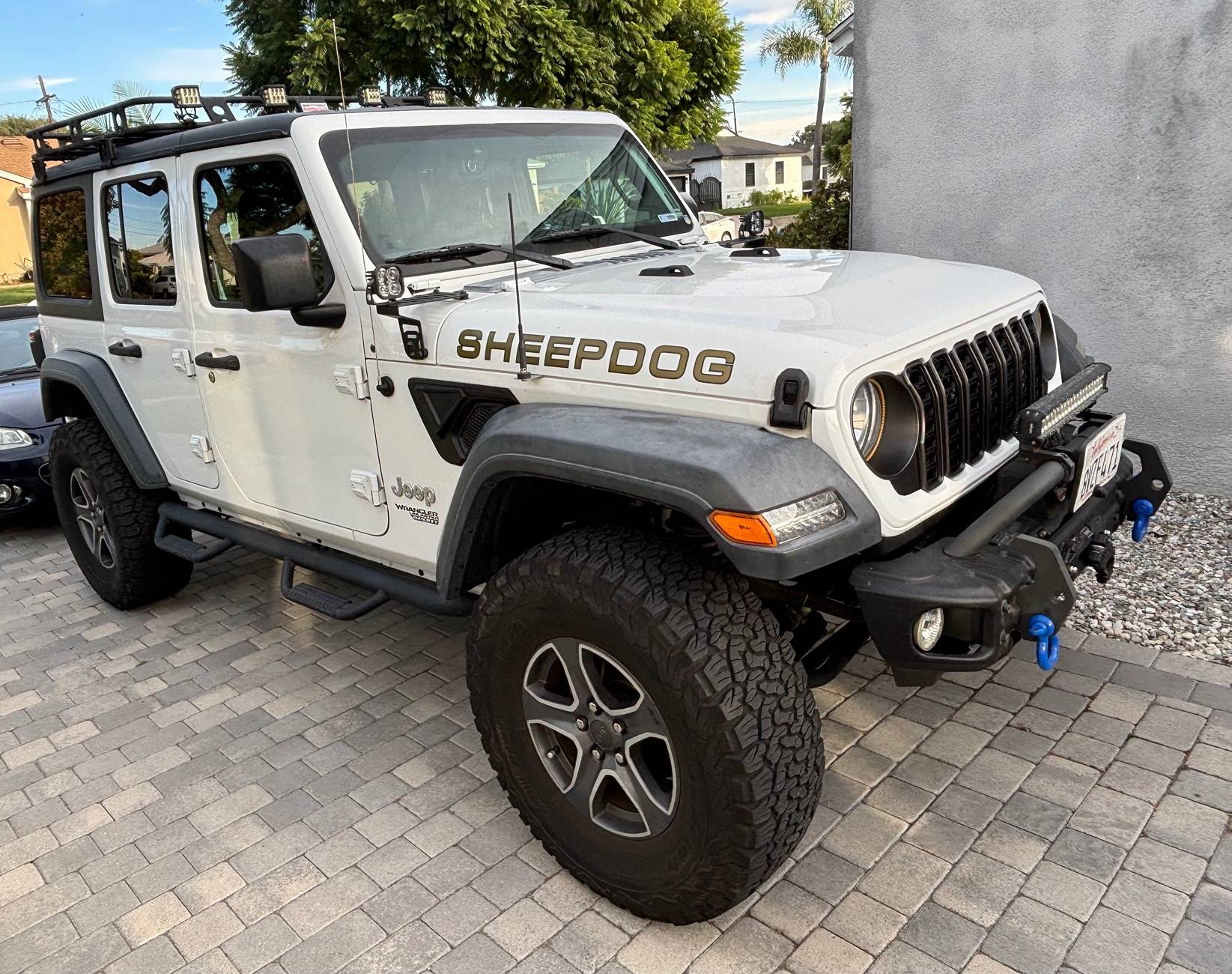

Hi everyone! Quick question for the group regarding a grill removal on a 2018 JLU. I have a winch installed and I'm wondering how much travel is needed to clear the bottom clips on the grill. I really don't want to remove the winch and I'm hoping that I have enough space to pull the bottom of the grill to release the lower clips. Thanks in advance!
Depending on which grill, which bumper, which mounting plate, and which winch you have, you may or may not be anle to remove the grill for radiator replacement, headlight assembly replacement, etc. You will need anout 2” of clearance to be able to pull the lower grill clips attached to the lower horizontal bracket with clip openings. Replacing the OEM 2018-2023 grill with the new style 2024 version will be easy (once you have the 2018-2023 grill out), as it does not protrude toward the winch as much as the OEM 2018-2023 version does.
If you have the RR Arcus bumper, mounting plate, and Warn Zeon winch, like I do on my 2018 JLU, you will have 1/8” clearance between the grill and the winch, which gets used up by the electrical cables powering the winch. Grill replacement (and the ability to service the radiator, headlight assemblies, etc.), will be labor intensive at the shop. I managed to swap grills myself with “minimal” pain. Worth the effort.
