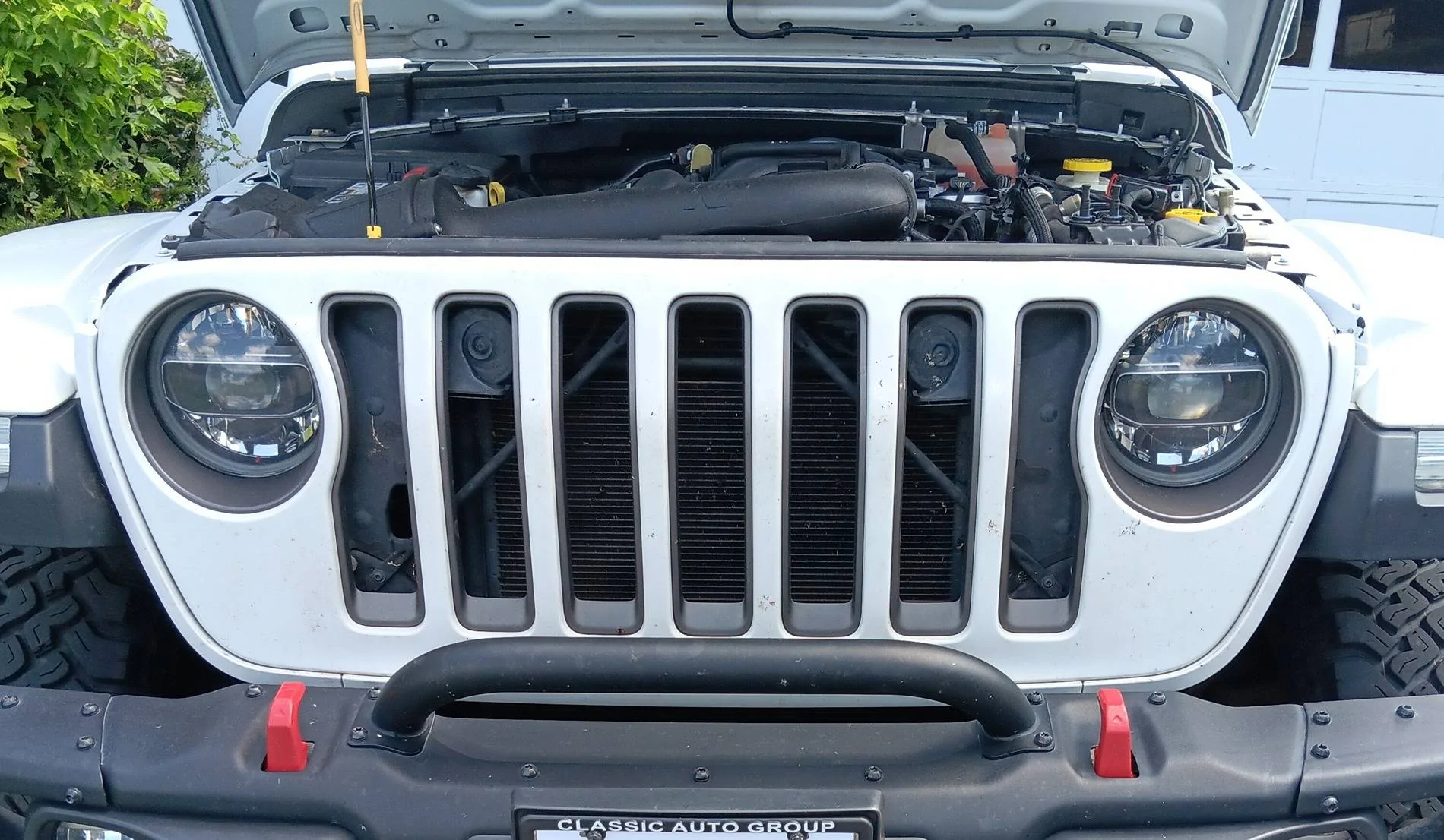

Seems like the overheating thread has gone to the wayside.... so I decided to create a thread on simple revert mods to either look retro or be both retro and useful. In my case better engine cooling, even though I have yet for its need, but plan on desert excursions next year. It's simpler than one thinks. My quick and dirty fastener fix was to use #10 nuts and slightly larger diameter washers. I placed the nut between the factory washer on the screw and placed the larger washer under nut. The nut is used as a spacer to shorten the long factory screw. I did not have shorter screws of the same diameter, so the fix I did was all on what was in my bits and bobs.
Jeep Wrangler JL Going back to basics 1000039152

I have no doubt that will create more air flow but stopped at traffic lights, stuck in traffic jams, crawling on the trail, especially in higher temperatures, it's probably not going to make a huge difference. Just a friendly suggestion, you could research the rpm extreme fan controller.

I have a tazer mini... it has fan control feature. Places fan at high speed. Another option is gladiator fan. Prolly get to that when I install an aftermarket all aluminum radiator.
I am thinking to seal off the outer grill openings as they are dead and useless. Marketing and engineers have no clue. It will be a nice custom retro 5 opening grill.

So that little thing in front of your radiator is the a/c condenser, made mostly out of aluminum paper maché. Anything from pebbles to maybe even a hard bug hits it, and it's gonna be warm in the desert. Ask me how I know...

A bit more custom than what is in mind... the side vents can be opened up with jewelers files. Though my issue is the fender panels for venting. They are not as open as I would like them to be. They vent but barely. It's going to be a bit more work than cutting open the Rubicon hood vents.
