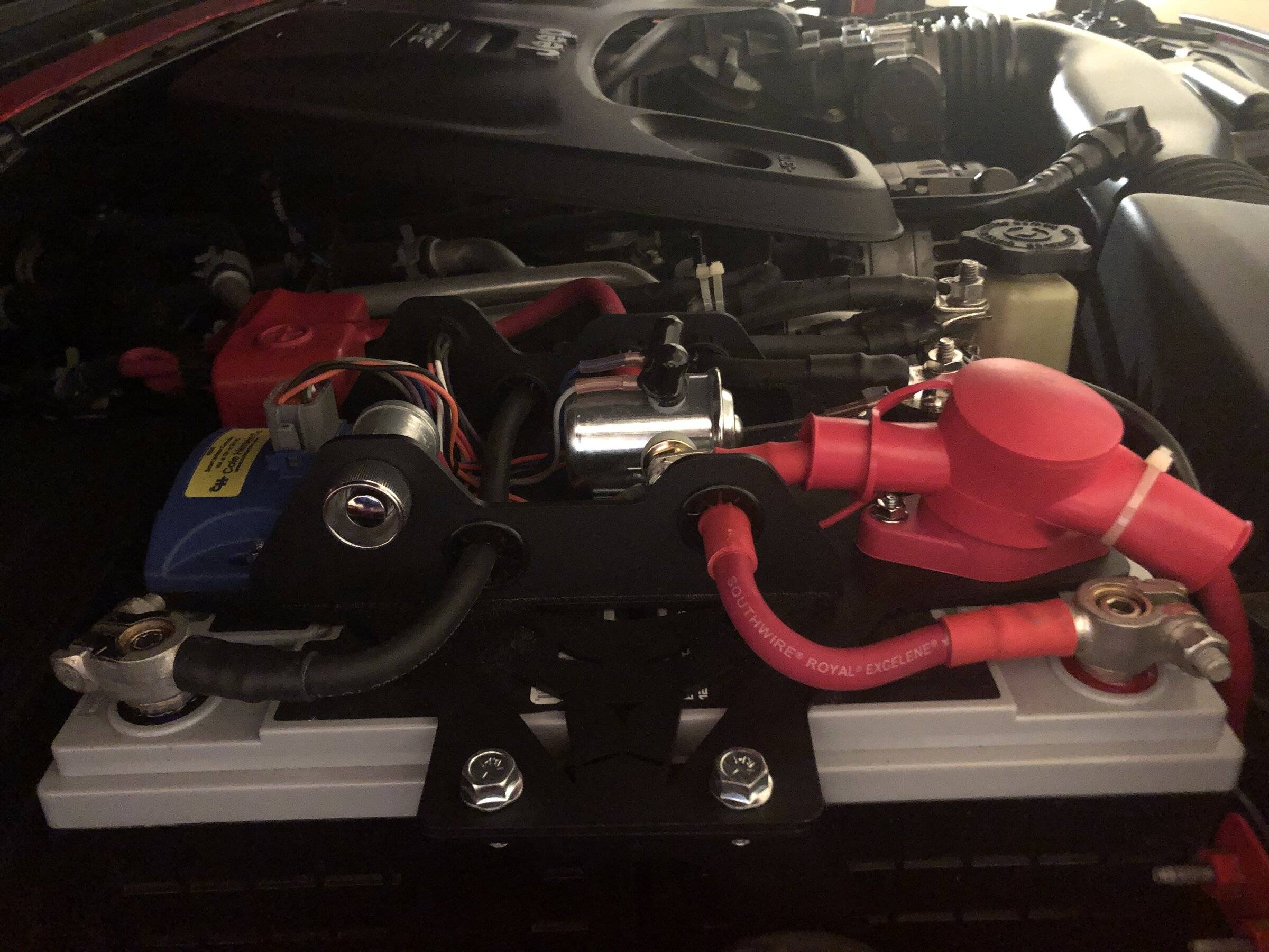

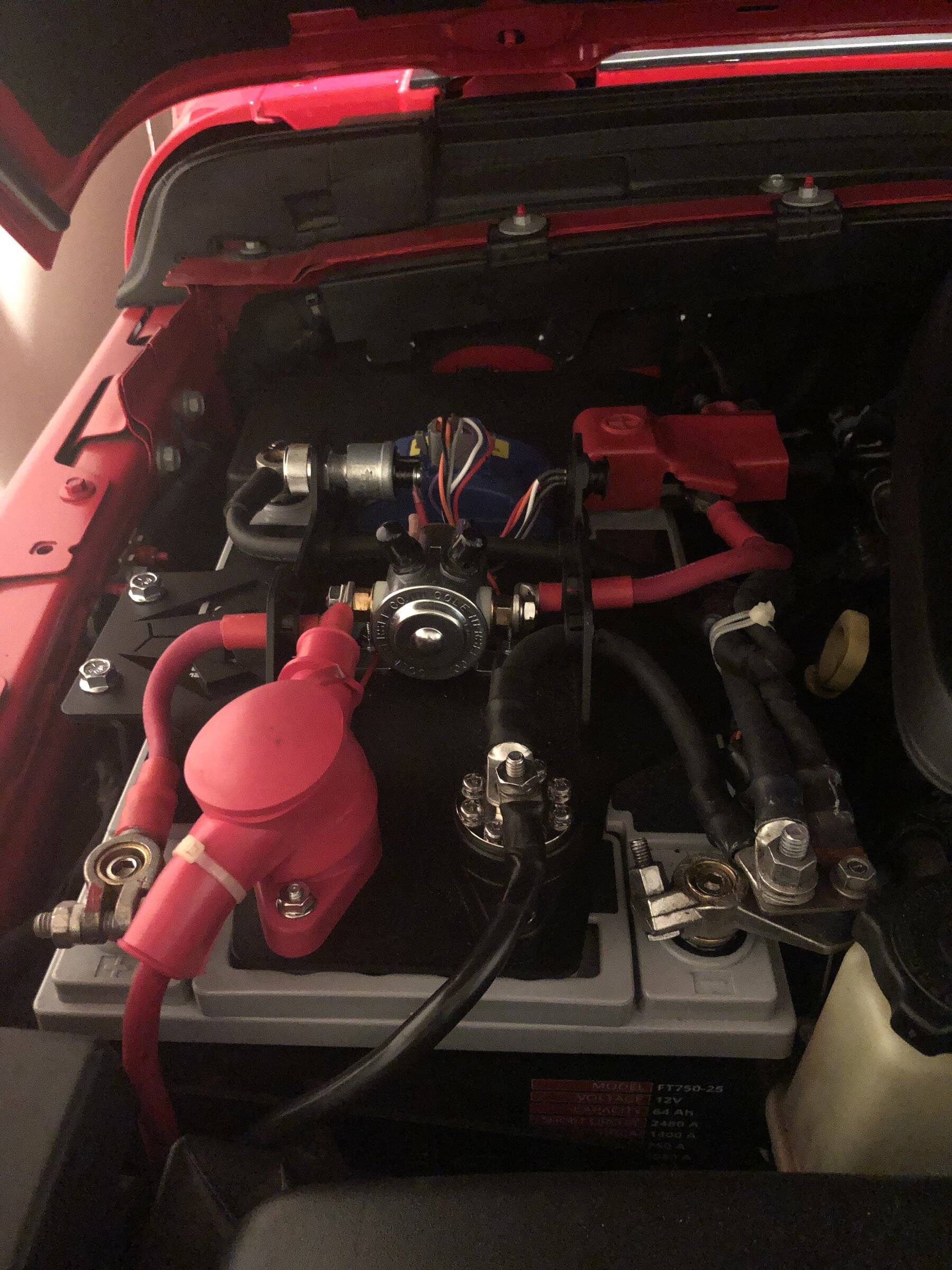

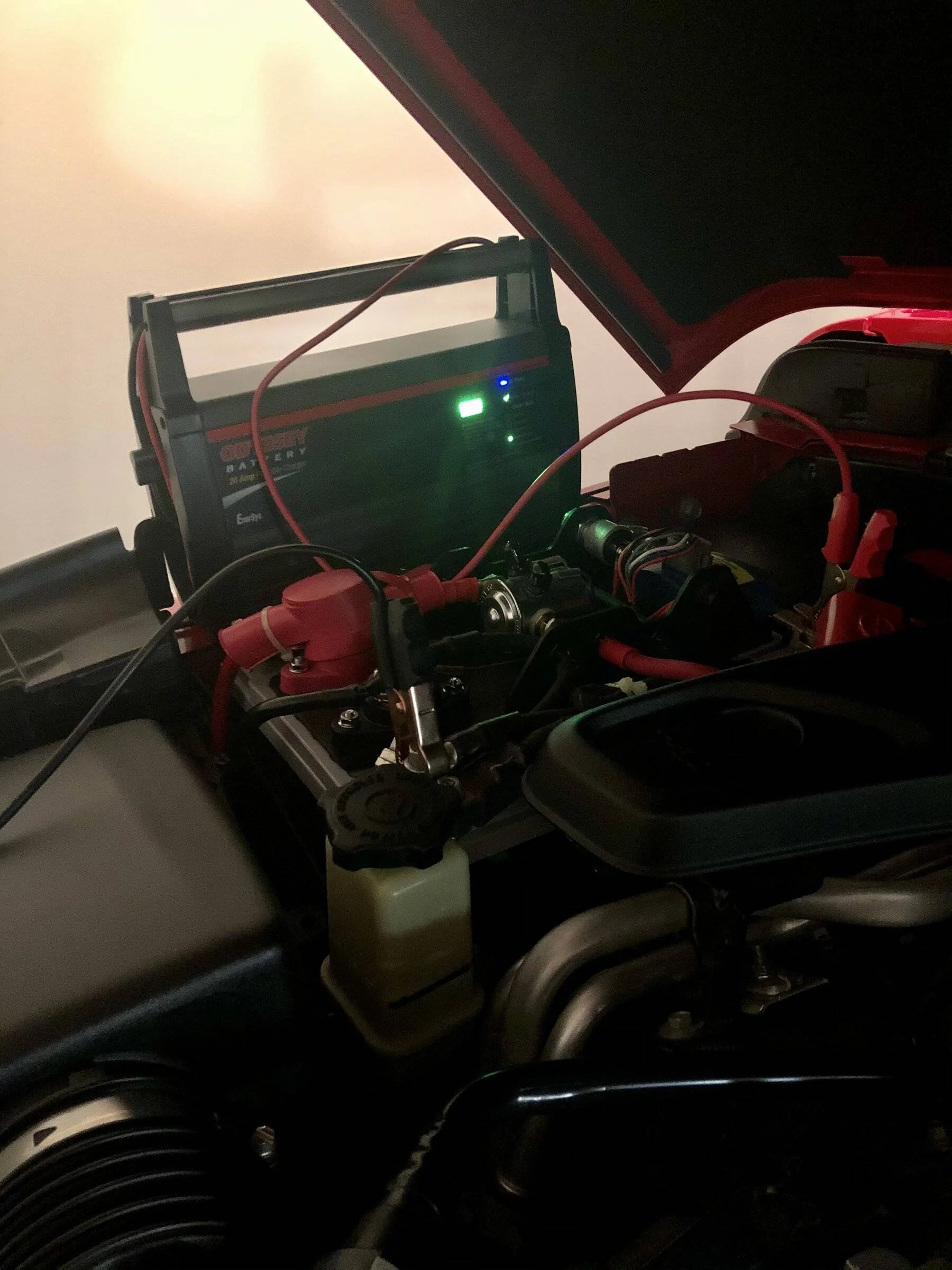

I’m pretty sure it won’t work as it’s a super tight fit, the JL does not have alot of open real estate under the hood.
As you can see there is little room between the stock intake and the batteries but I don’t know how much wider the the S&B is.
Jeep Wrangler JL Genesis Dual battery setup & S&B air intake? D620AF41-140A-4756-AA80-805006C101B0
Jeep Wrangler JL Genesis Dual battery setup & S&B air intake? 89BFF0C4-C28E-4463-B94E-06B3BA5A69CD
Jeep Wrangler JL Genesis Dual battery setup & S&B air intake? A77737DD-C23C-4FAF-9184-797D3BC12F5F
