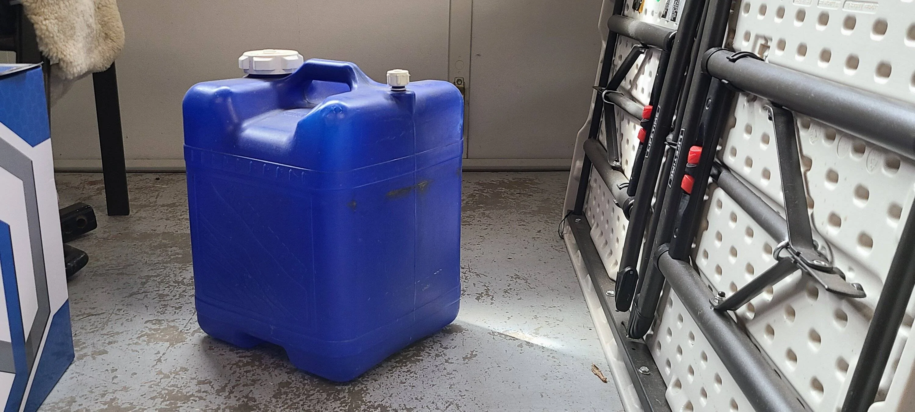

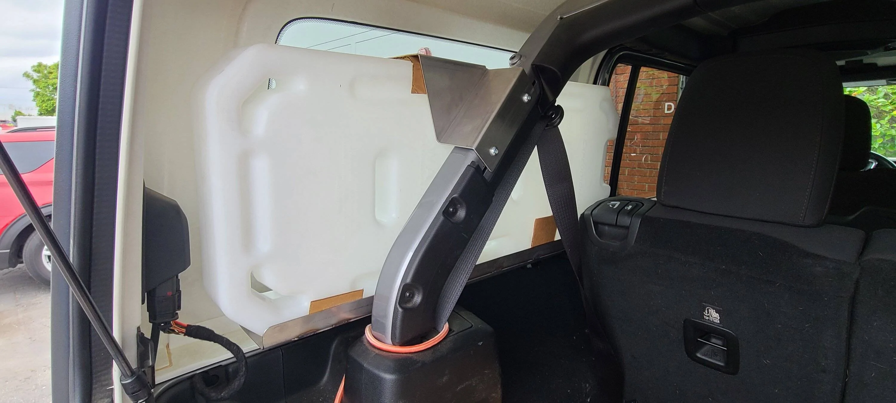

Water...
Expensive and complicated installation,
but space efficient.
Cheap, effective.
Depending on where you wheel you made a gallon back up or 2-3 gals for every day you might be out...Think ARIZONA!
Folks go out on BLM land, just fo ran afternoon of light wheeling. Got some sandwichs and some cold drinks. They get lost and a week later they find the bodies...died from lack of water. Would have lived it they brought water instead of Cokes and Beer...
