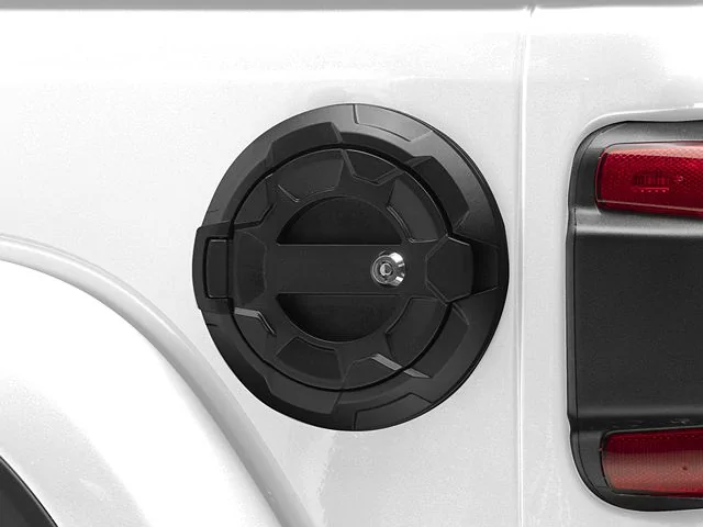

I bought this locking fuel door from Ext Terrain, the Bedrock, $90, it was a little loose when installed, I popped it out and put some JB Weld around the snap tabs...good now.
Jeep Wrangler JL Gas Caps Bedrock
