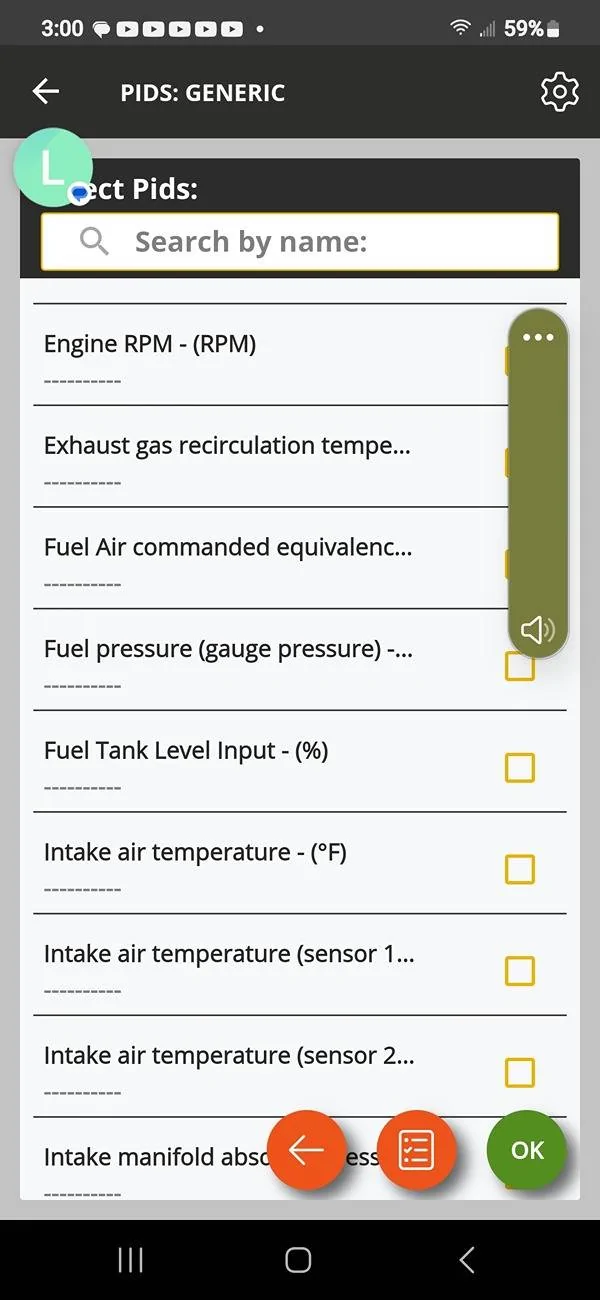

The FP sensor on a 3.6 JL is in the fuel feed line about 2ft from the connection to the rail. I don't believe you'll see a pressure drop in that distance, if it's not pinched. The live data page on JSCAN shows fuel pressure.
Would you mind sniping a pic of Jscan? What year, mines an 18?

Im a 2018. This is from the JL demo page. I can get a screenshot of real live data, but I'd have to install the bypass and dongle.

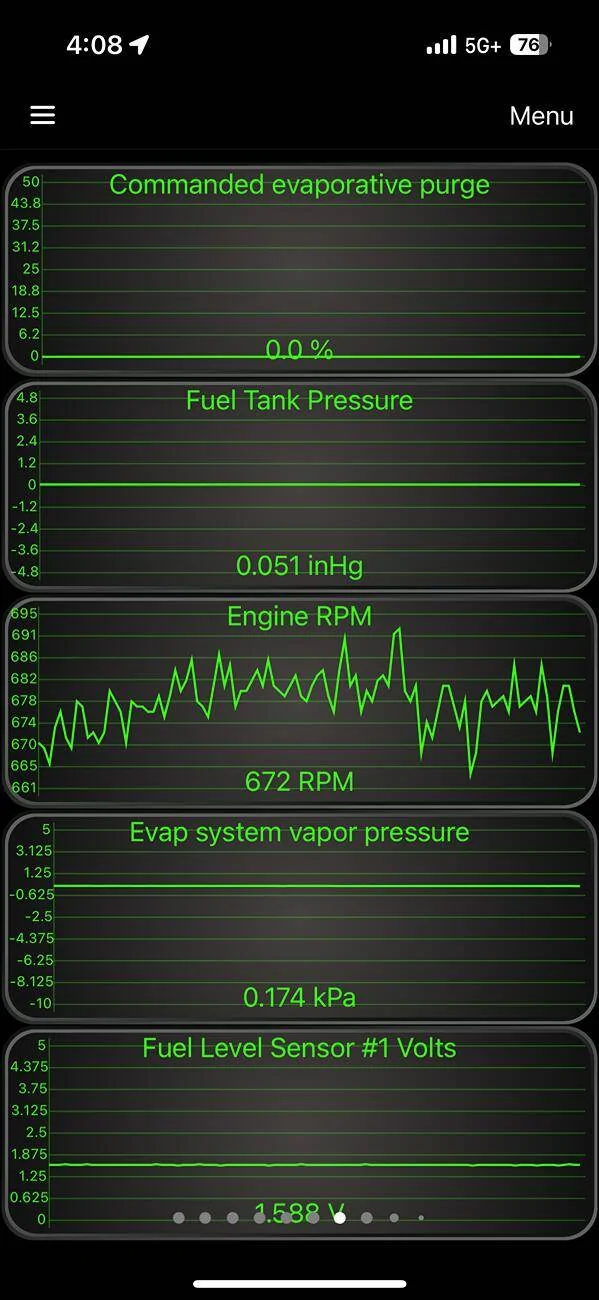

Interesting, put in some 91 today, fuel trims were very different, thru p0443,p0113, p0461, cleared them and didn’t come back.
No noticeable surging, Commanded Evap never moved from 0 on a 3 hr drive. Is 91 that stable it or I have some gremlins?
Man it purred like a kitten. I’t seems to run so much better when purge solenoid doesn’t open?

Yep, fuel trims look ok. Doesn't look like Stelantis has widebands on the V6 yet.
I don’t like the difference in B1/B2. Suspicious. Would like to know how it looks live if it hovers up and down from zero or if it hangs out around 5 like shown.
You want at idle any other rpm or driving?

Idle, especially if that’s where you’re having the surge.
My thoughts are: you just did a hunch of work and now it’s doing something new. Prove it wasn’t something you caused.
Assuming that graph is right something is up there. Downstream o2s should remain steady, if it jumps to meet the upstream it's a bad cat (right side in this case). That or the left side o2 has failed. Hard to say without more graph data, but it's definitely an issue. Its been awhile since I diagnosed a cat from o2 voltages but I swear both down streams should be near the same voltage and not have such a difference like we're seeing here
Monitor all 4 o2s and go cruise around a bit. Both down streams should remain consistent and not jump around.
