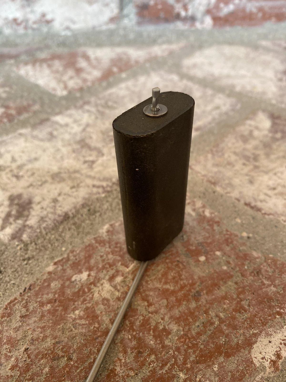

Has anybody seen this error on their dash? "Service Fuel Level Sensor". My fuel tank is full but the fuel leevl on the dash shows "low"
I made the obvious mistake and started replacing things with no resolution. The sensor is attached to the fuel pump so I pulled the tank thinking the fuel level sensor was bad and replaced the fuel pump/assembly module. With no results I replaced the Fuel Pump Control Module, no luck. I have also checked the large wiring harness connectors to ensure they are all seated as well as confirmed the fuel pump relay works which it does (the motor runs no problem).
Any suggestions?
Thank you
