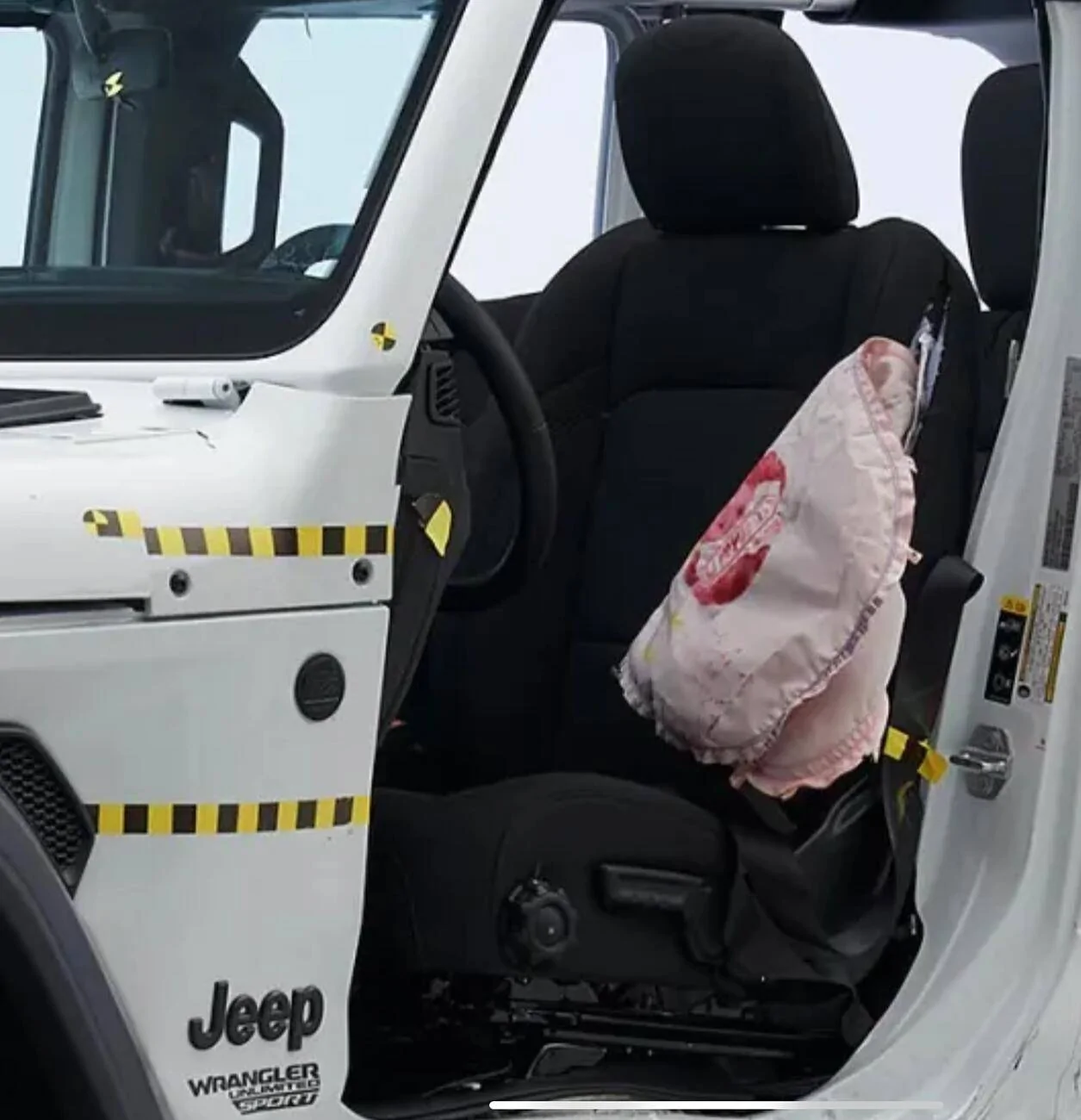

It’s hard to see how seat covers wouldn’t obstruct seat airbags, unless they were carefully designed not to.
This is the 2018-23 design:
Jeep Wrangler JL Front seat airbags 1730215039968-su
The 2024s add curtain airbags, and I believe these supplement — but do not replace — the seat airbags. Thus, I would be wary of seat covers that cannot be shown to have been properly tested.
The 2024 seat airbag is just like your pic.
(The auction house that has my Wrangler from the wreck back in May has pics of it online at <https://www.copart.com/lot/56968944/2024-jeep-wrangler-rubicon-4xe-ca-vallejo>; you can see the deployed drivers' seat airbag in one of the pics.)

Thanks for posting pics. I think this answers my question about strapping grab handles on the top door frames. Looks like they would impede deployment of the side curtains... Or become projectiles (24 Sahara).
