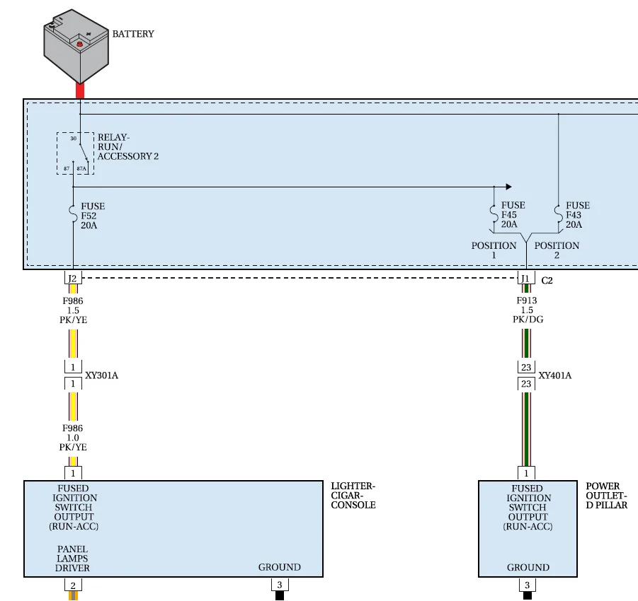

It could be rewired to use one of the Aux outputs. I'm unaware of any plug-n-play solution for that though.
EDIT: After looking at the wiring diagrams, it looks like you could add a jumper between fuse F43 (the 2nd position for the rear outlet that makes it always hot) and F52.

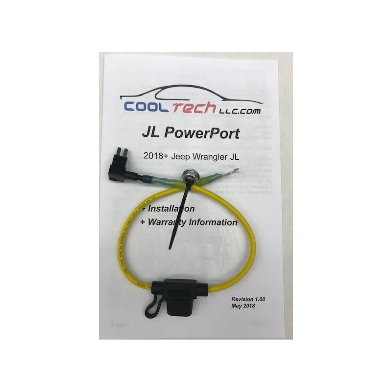

Only way I could see to not screw with someone who didn't know my jeep, wire in a second cig lighter power always hot using this:
https://www.amazon.com/dp/B0DLJYMFV6?ref=ppx_yo2ov_dt_b_fed_asin_title
I let it dangle by drivers side OBD connector, I use it for always on power RVi3 brake. Easy install, used a 1/8th drill punched through driver side firewall plug and some RTV to seal it shut.

Vampire drain? Doesn't that mean the panel lamps will be always on?
ISTR pin 2 being just for the lighted ring around the power outlet, but either way, still would create a dead battery scenario in no time.

Thanks for the wiring diagram, looking at it, if I jump the relay pin 30 to pin 87, would that cause any other issues?
