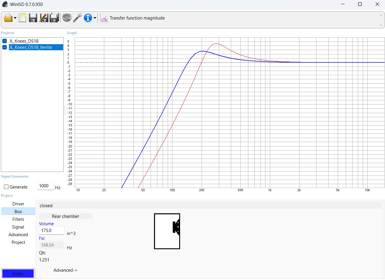

I played around quickly with the drivers in WinISD and got the below transfer functions.
They did not provide enough of the thiele small data on the neo 6.5" so the blue line is the ferrite version of the speaker. The red line is the 8" neo that the manual download link brings up for some reason. That line shows it in the same ~175in^3 Metra pods, but if you enlarge the enclosure the 8" data gets really close to the 6.5" ferrite line, so I am going to assume that the 6.5" neo will look damn near the same as the ferrite.
As you can tell you are going to get some extra volume around 200Hz and dropping off pretty quickly. It does not look like these will dig into the lower range well, and DS18 even notes to set crossover to 100Hz. The SPL graph (not attached) showed that with 100W it would max out around 112DB, and 300W capping at 116DB.
If you are going to add a bunch of speakers right behind your head and want to maintain some semblance of a front stage, definitely get a DSP.
A 8" can fit with trimming in the Metra pods ? Peak at 230hz seem kinda high. I'm not too sure what to do with the sound bar yet. And I do have a dsp, ds18 4.8 dsp, for the price it's pretty great.
No, they will not fit. I just had to use the 8" data since the manual link on the 6.5" opens up the 8" specs. Just trying to interpolate the data between what was available. The blue line should work just fine for both magnet materials for the 6.5" drivers.
