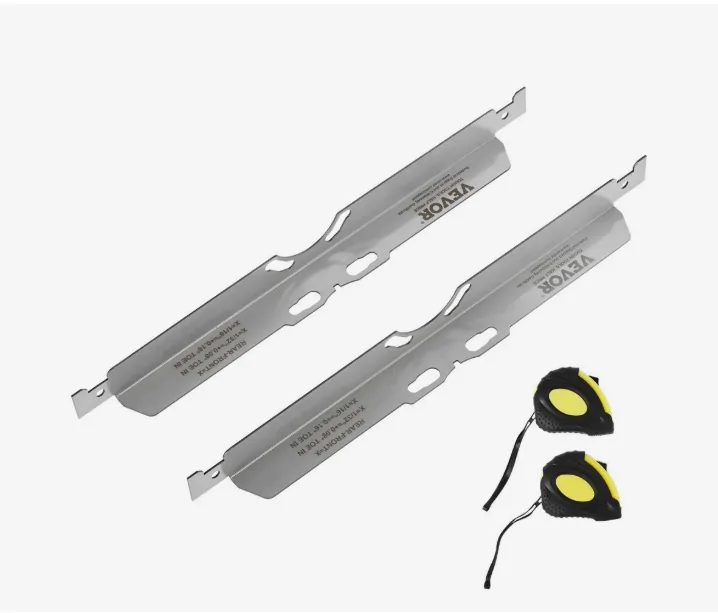

Moving forward with replacing the drag link and tie rod. Stock Jeep at stock height so not upgrading any components. Just replacing.
Since the control arms are stock I don't think there is any adjustment with alignment there correct?
Just have to worry about the steering wheel being centered and toe-in correct?
Has anyone tried the toe-in brackets and not taken it to a shop for an alignment?
Seen bars that you bolt to the spindles and then measure front and back to set the toe-in. Amazon has them for as little as $20
https://www.vevor.com/toe-plate-c_1...ilBfNsu0FN06DKcqHIrHTPupmDCXTLoxoCoXYQAvD_BwE
I've also tried something like these but I made them out of angle iron. Some people love them. But in my experience, it got close but not close enough. If you do end up replacing the drag link and tie rod, I would just get an alignment done professionally if you can afford it.
What do you mean by not close enough? I've never found the toe-in to be that critical. Close enough is good enough generally. At least that's been my experience. I'm assuming you got an alignment after your DIY attempt? How off was it?
Yea an 1/8" by eye on a tape measure is going to be plenty close enough on an ancient technology front axle steering any day of the week.
