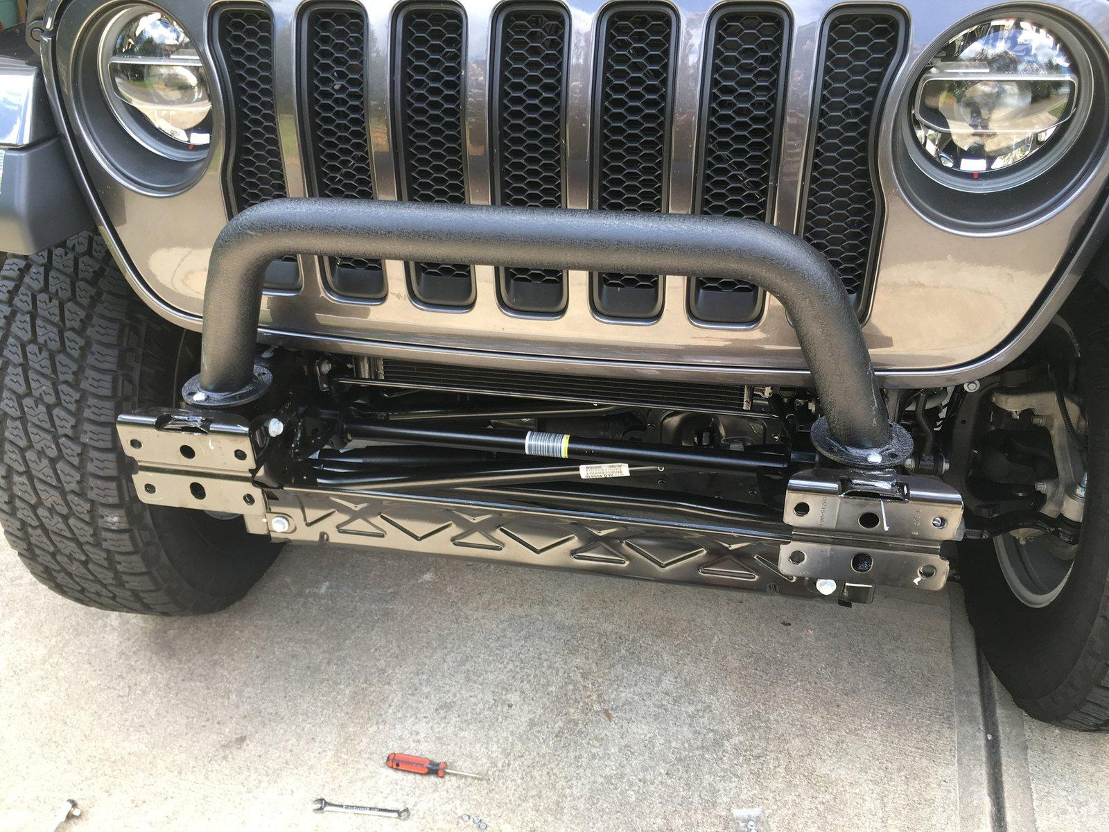

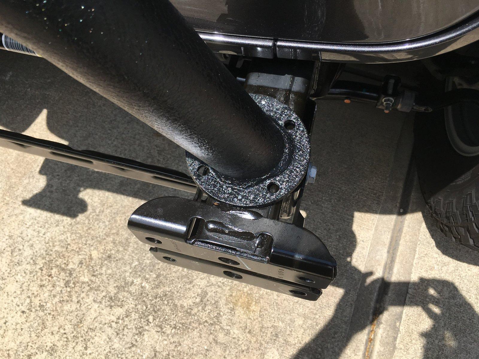

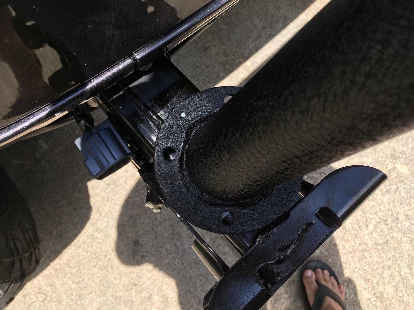

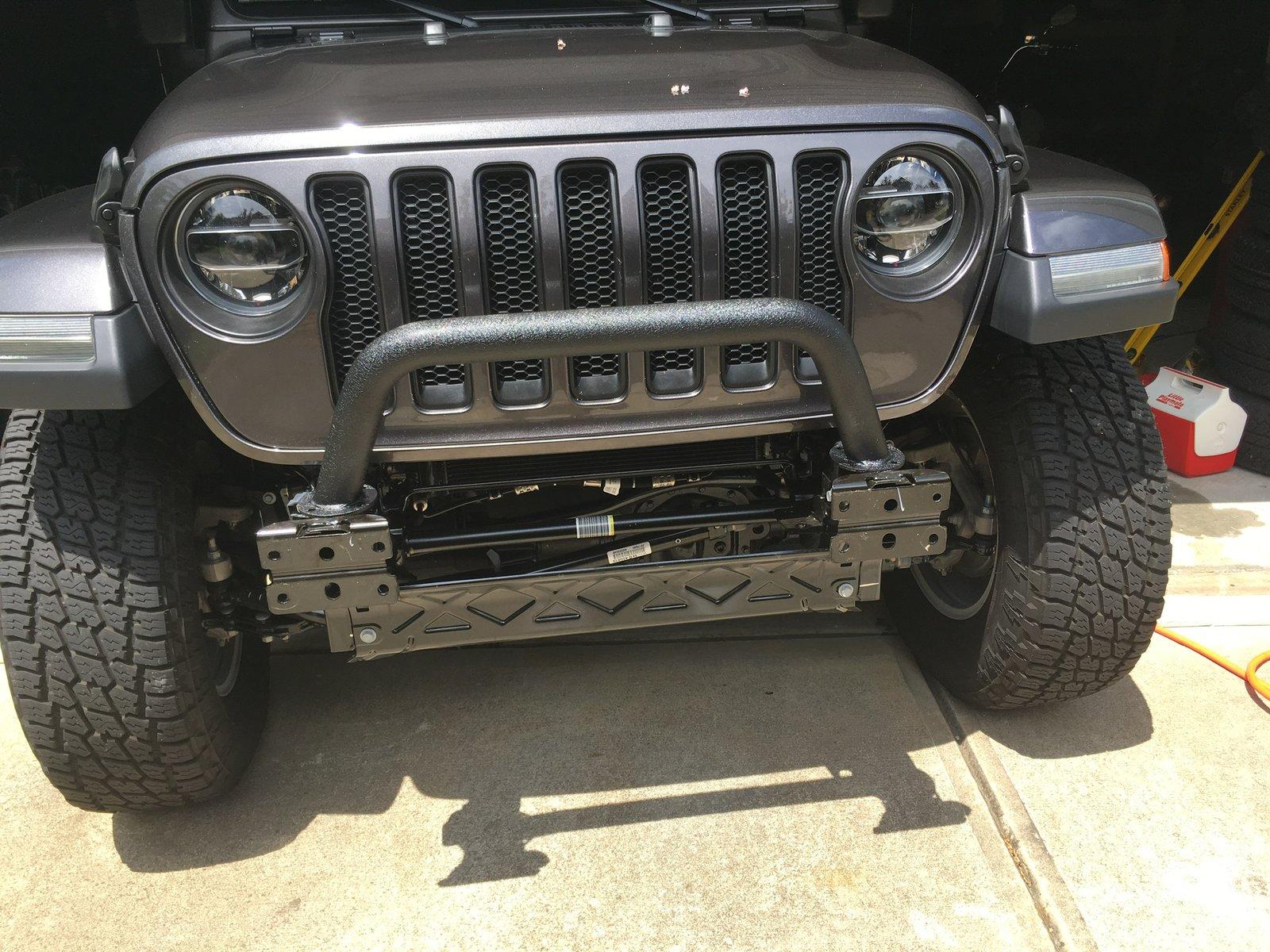

A half inch thick spacer is all it took. I did not need to trim the bumper or grill shell. I did trim the ends off of the panel that attaches to the back top of the bumper. And slotted the lower two bolt holes in the lower plastic skid plate cover.

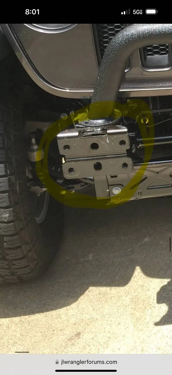

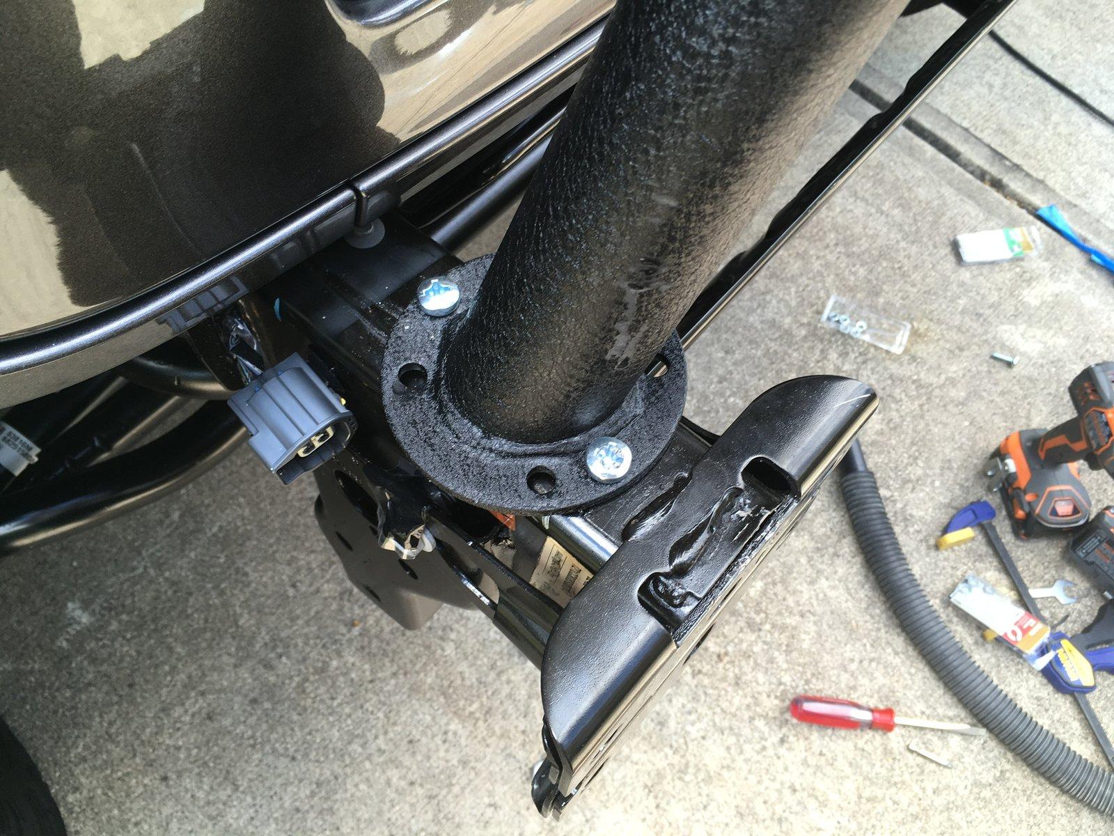

Hello sir, is there any way to go more in depth about doing this mod? I did read what you posted, but still hard for me to understand. I have been watching videos of taking the bumper off, but not sure where this spacer goes and where to drill etc. I am trying to collect information and pictures to have my auto body do this mod.
Tangokilo
Tom
Jan 13, 2019
147
217
Southwest Michigan
1972 Oldsmobile 442, 2001 4runner, 2010 Honda Accord V6 Coupe, 2011 VW Golf, 1969 Triump T100 MC and 2018 JLU Sport S
This wood spacer goes between the front of the frame (the frame ends with a flat plate with the four mounting holes that match my wood spacer) and the whole bumper assembly.
Big_Mike_NJ
May 24, 2024
NJ
2021 Jeep Unlimited Willys
Thanks for the response. I am using a picture from the thread. Is this where that spacer goes?
Jeep Wrangler JL Front bumper hoop mod IMG_1244
Tangokilo
Tom
Jan 13, 2019
147
217
Southwest Michigan
Yes you got it!
