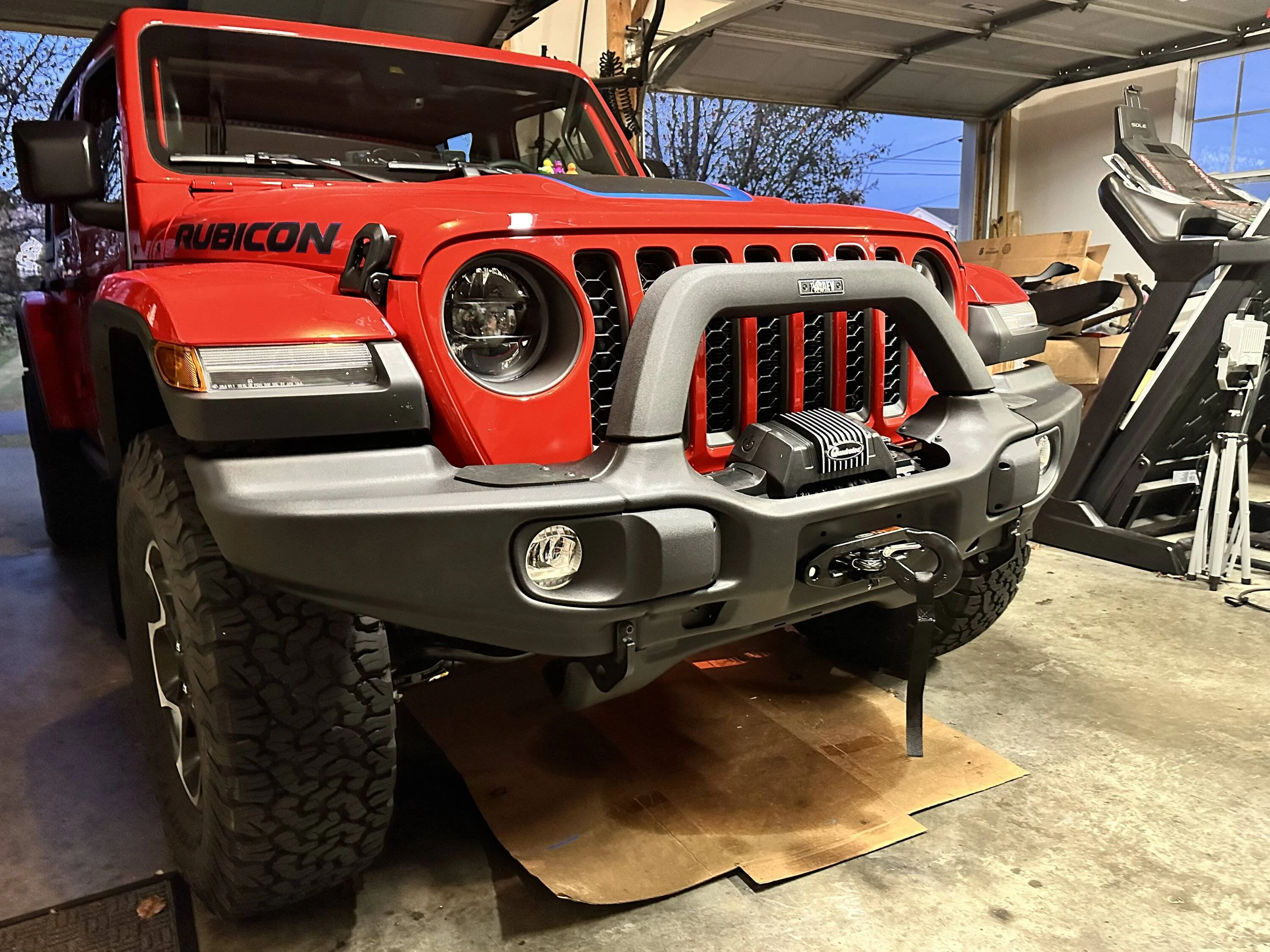

Jeep Wrangler JL AEV Ex Front Bumper Hoop Removal IMG_4820 (002)
Looking at mine, I don't see where the trim panels impede anything, but loosening those bolts might provide some clarity.
