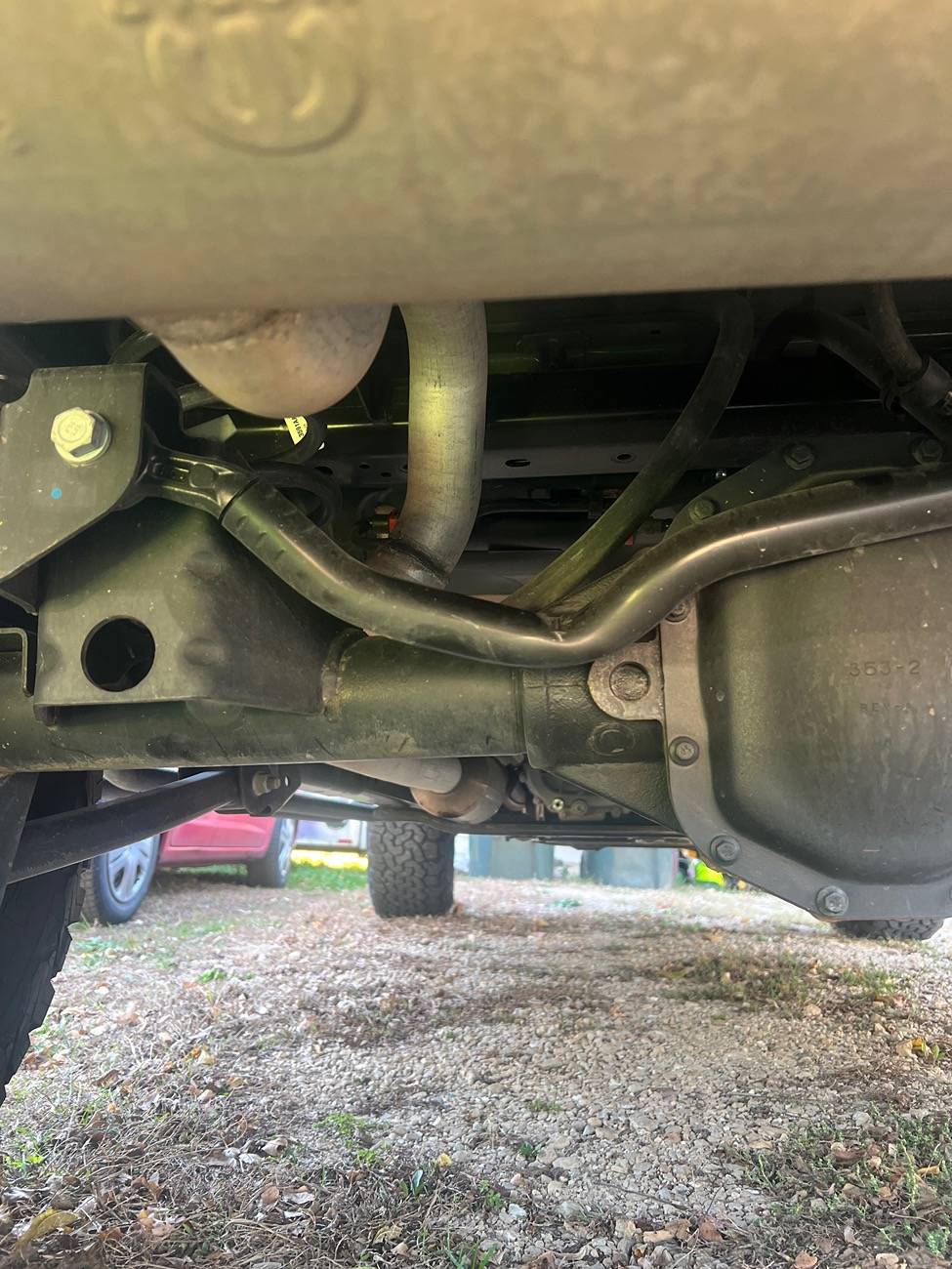

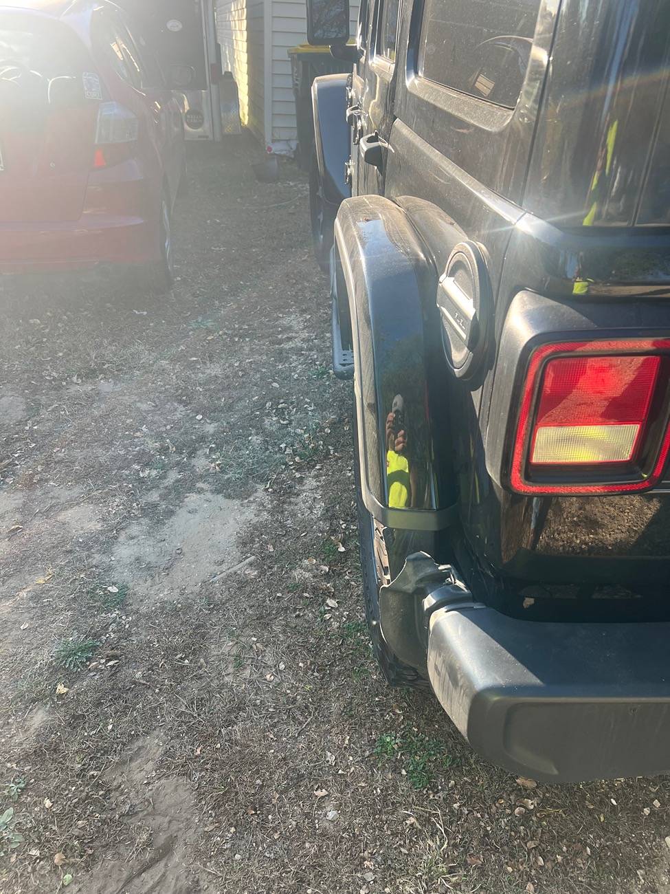

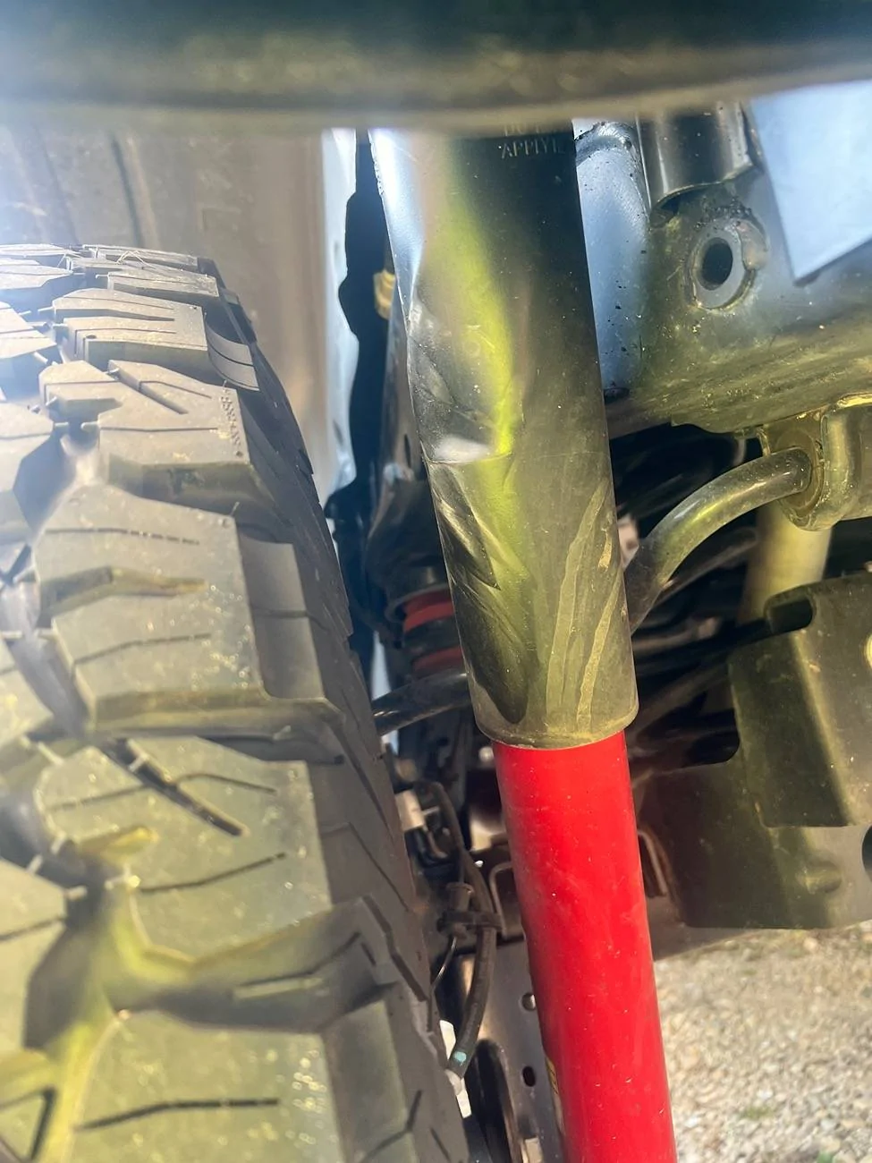

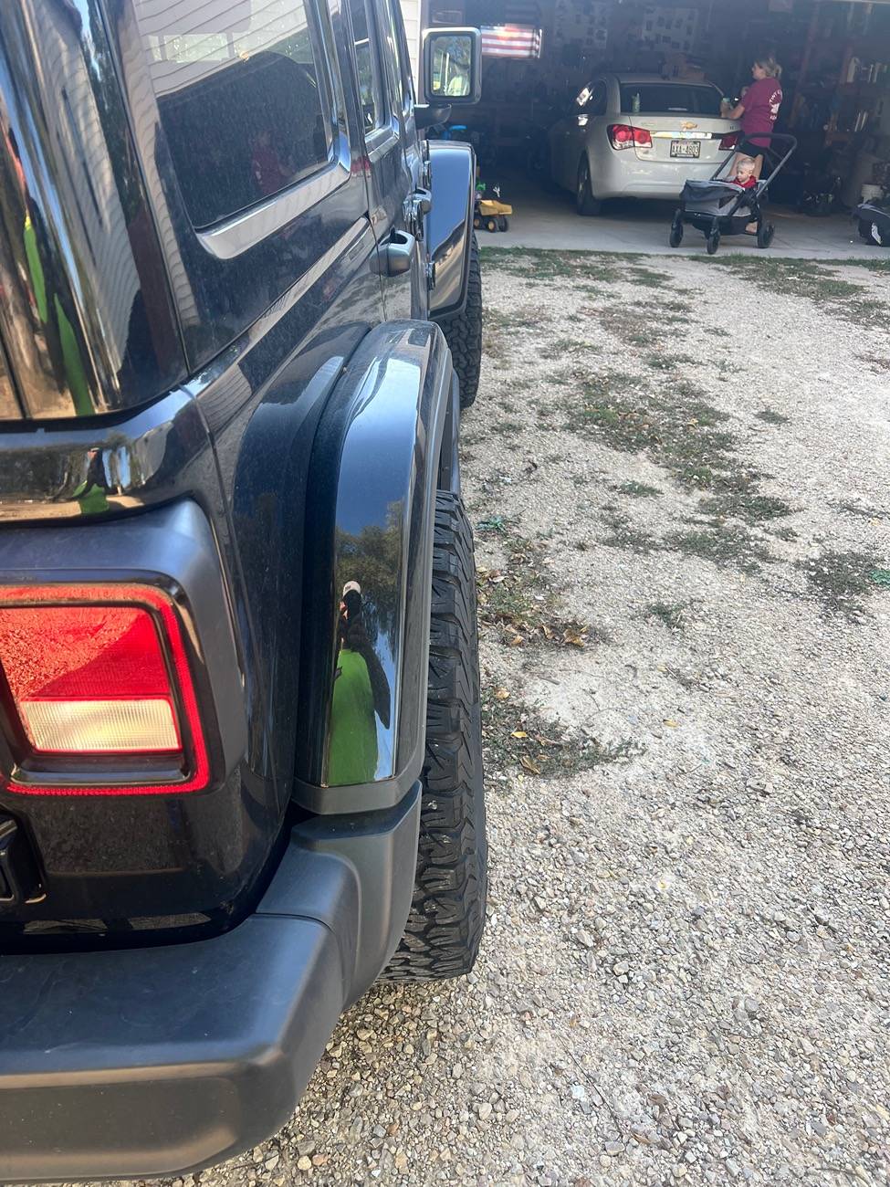

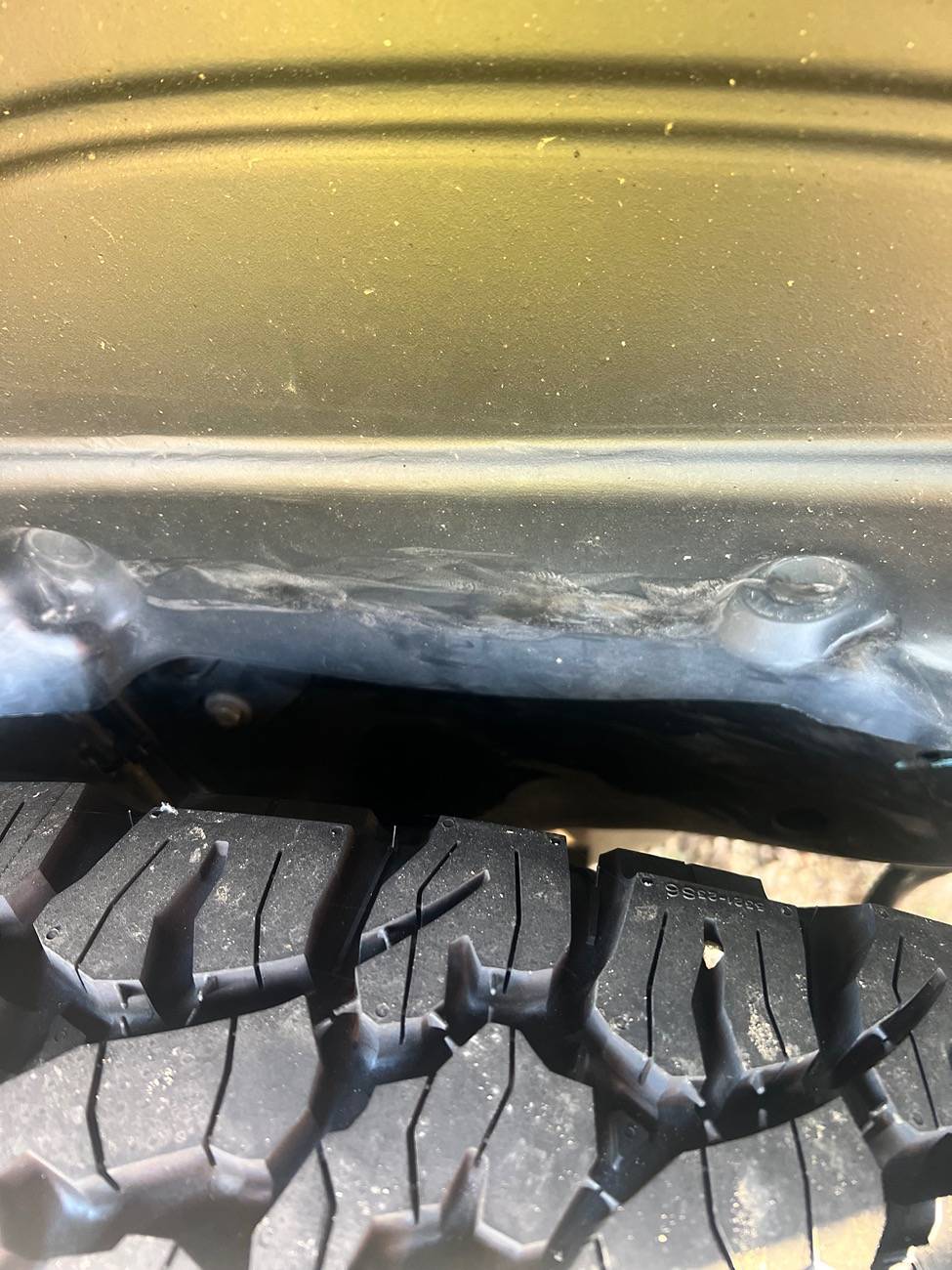

So I got hit directly in the rear driver rim and noticed that the rear axle got pushed to the passenger side pretty good. Do you think it has a frame damage from this

Youre going to need to take measurements to be sure there isnt also frame damage but looks like its the Trackbar that is bent causing your misalignment at a minimum. Could be plenty other stuff there thats bent as well no way for us to really tell from some pictures.

I would add, inspect all the moving parts of the axle for runout, I cant see how you dont have bent axle shafts, or worse.
please tell me you have a police report and they have insurance.
Last comment, I'd demand a new rear axle with all new parts, brakes, etc.
Check welds on attachment points for track bar and spring perches. Control arms, etc, all that stuff can be gone, as in, this could be a totaled vehicle if enough of that is bad. This of course does not count a bent frame.

This exact scenario is what happened to Pain Train but it was hit hard enough for a roll over and broke the frame bracketry.
Check the welds on the frame side trackbar brackets.
However, the frame was perfectly fine. I wouldn't expect anything more serious that a trackbar bracket as far as the frame is concerned.
But like already mentioned, definitely have the axle housing checked. Mine was bent ever so slightly; just enough to not allow the axle shaft assembly to slide in and out easily.
I can't see them totaling your Jeep for something this simple.

Track bar damage is a definite, control arms possibly, frame unlikely (but should be checked). Totaled? I would highly doubt it.

I got sideswiped/tboned last year hand had very similar damage to you. I would without a question replace your tack bar and it’s bent. For safety sake cut and weld a new track bar frame mount on, barnes 4wd makes some really good ones. (factory cracks even without an accident) and also check to make sure your rear axle isn’t bent. Dm if you have any questions!
