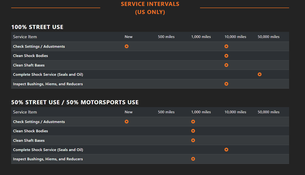

Fox's need rebuilding anywhere from 15k-30K+....you're just about there. Especially, if you got some with bad seals from the factory.
Here is Fox's actual service recommendation......pretty frequent servicing if you hit dirt on a regular basis.
service.ridefox.com/pages/truck
Jeep Wrangler JL Fox shocks leaking 1712608287455-ze
