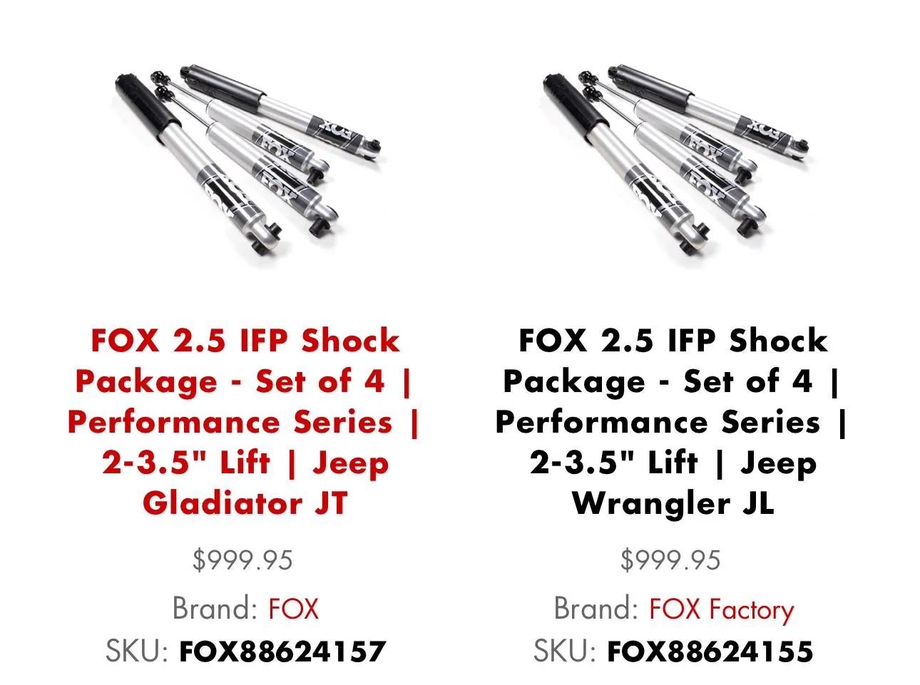

I own a JLUS recently got fox shocks which are nice but not with rough country springs. Looking to replace the springs with a better options. I don’t off road much.

Are they the 2.5 Fox shocks from the Mopar lift, or are they the new 2.5s from JKS ?

I got them off the JKS website. I am assuming the new ones? They have the plastic boot in the rear

I don't have any experience with those shocks yet but I imagine they would pair nicely with the JKS springs as that is what they are valved for. IFPs tend to be stiffer and have a shorter stroke.

Accutune does not tune or rebuild IFP shocks.
They dont make “2.5 IFP shocks”. It was probably a OP typo. I assumed he was talking about the 2.5 fox elites.

They sure do. I’ve Been doing some shock shopping recently and these are on the list.
Same link as posted by @Blackdew
Jeep Wrangler JL FOX 2.5 IFP Spring combination IMG_7423
