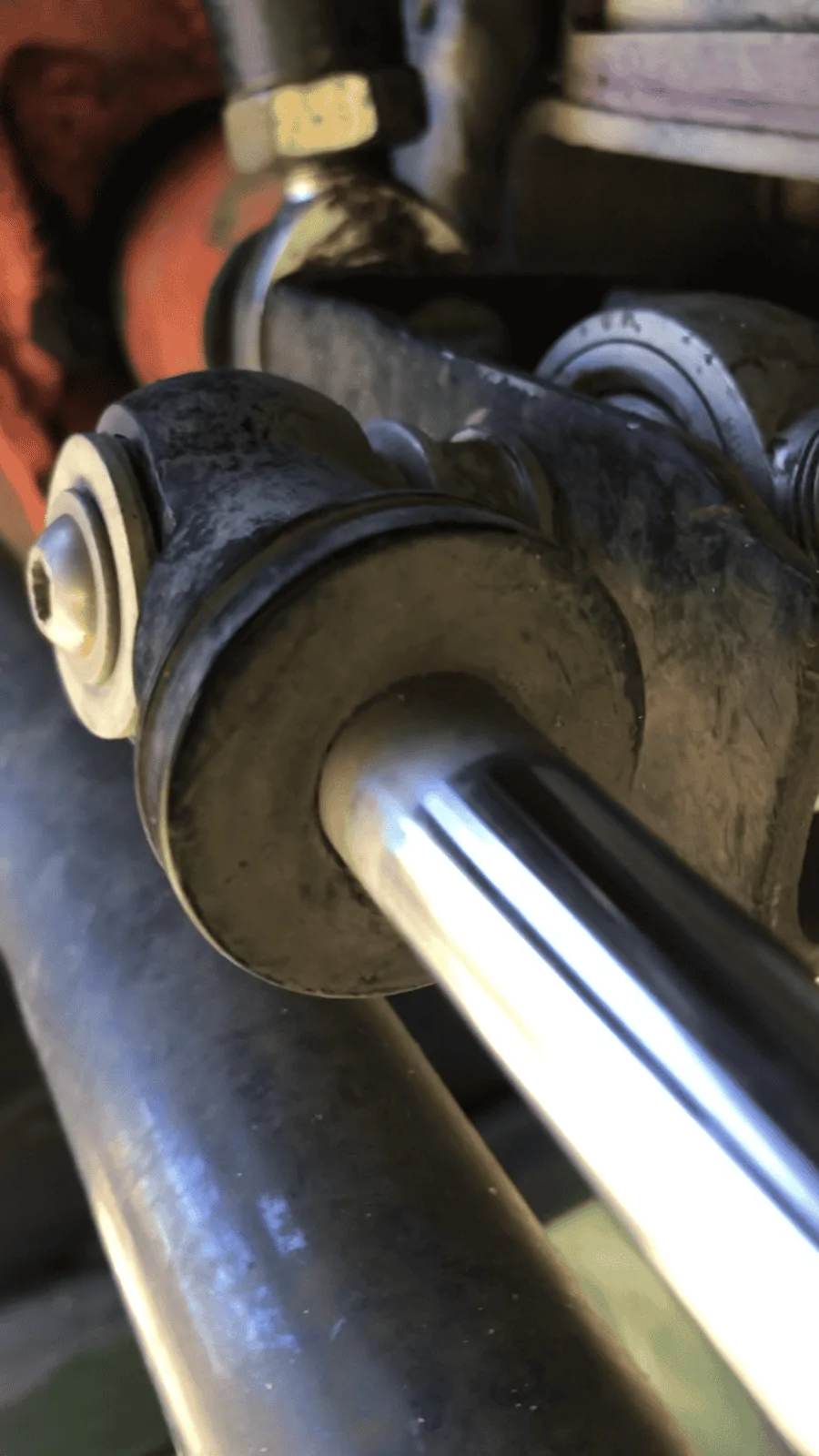

Hey man, Yeah, no extra parts needed, this is how mine came……..
I am using the synergy track bar bolt though, the bolt that came with it was contacting the drag link at full turn passenger………… the synergy uses a lower profile button head bolt. I’m running aftermarket tie rod/ drag link, I’m not sure about stock set up. And I’m not sure about the different colors, sorry.
