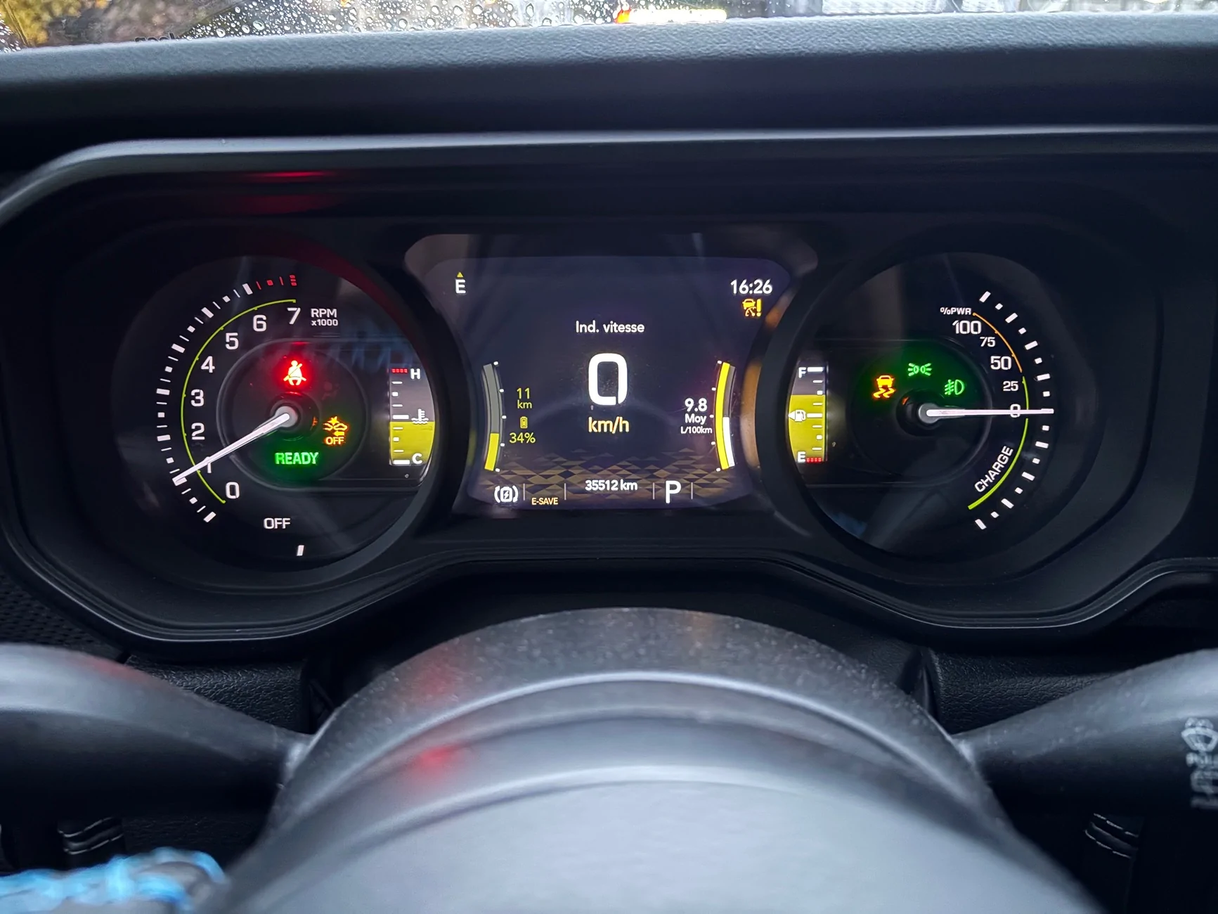

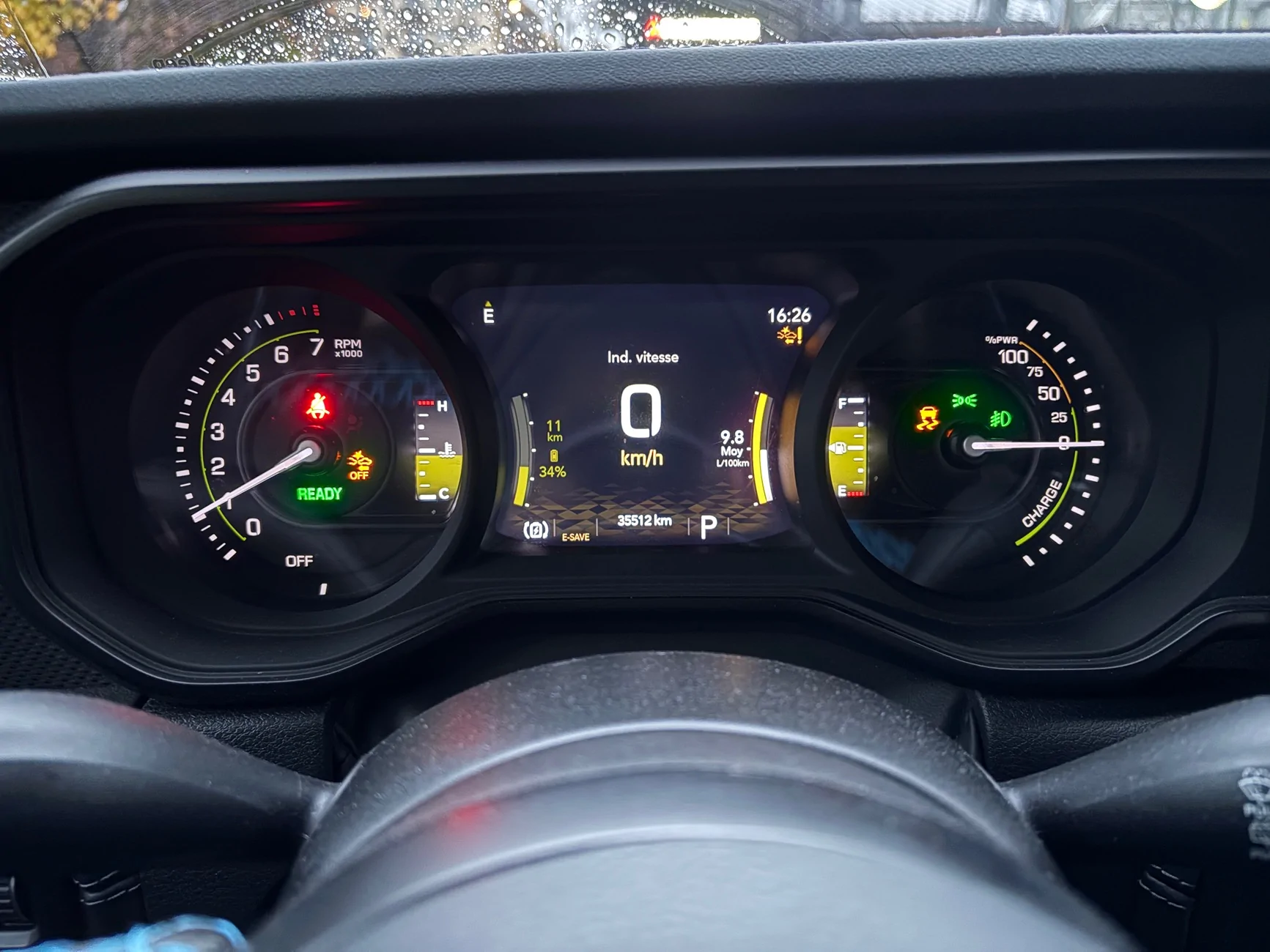

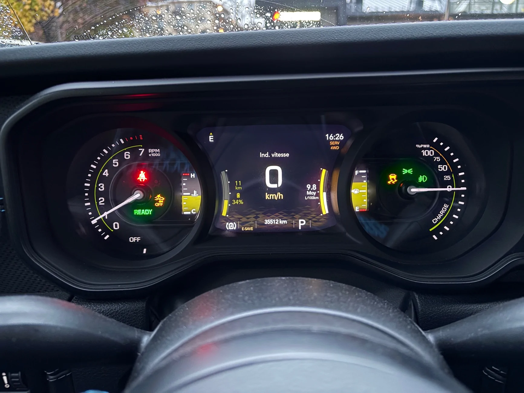

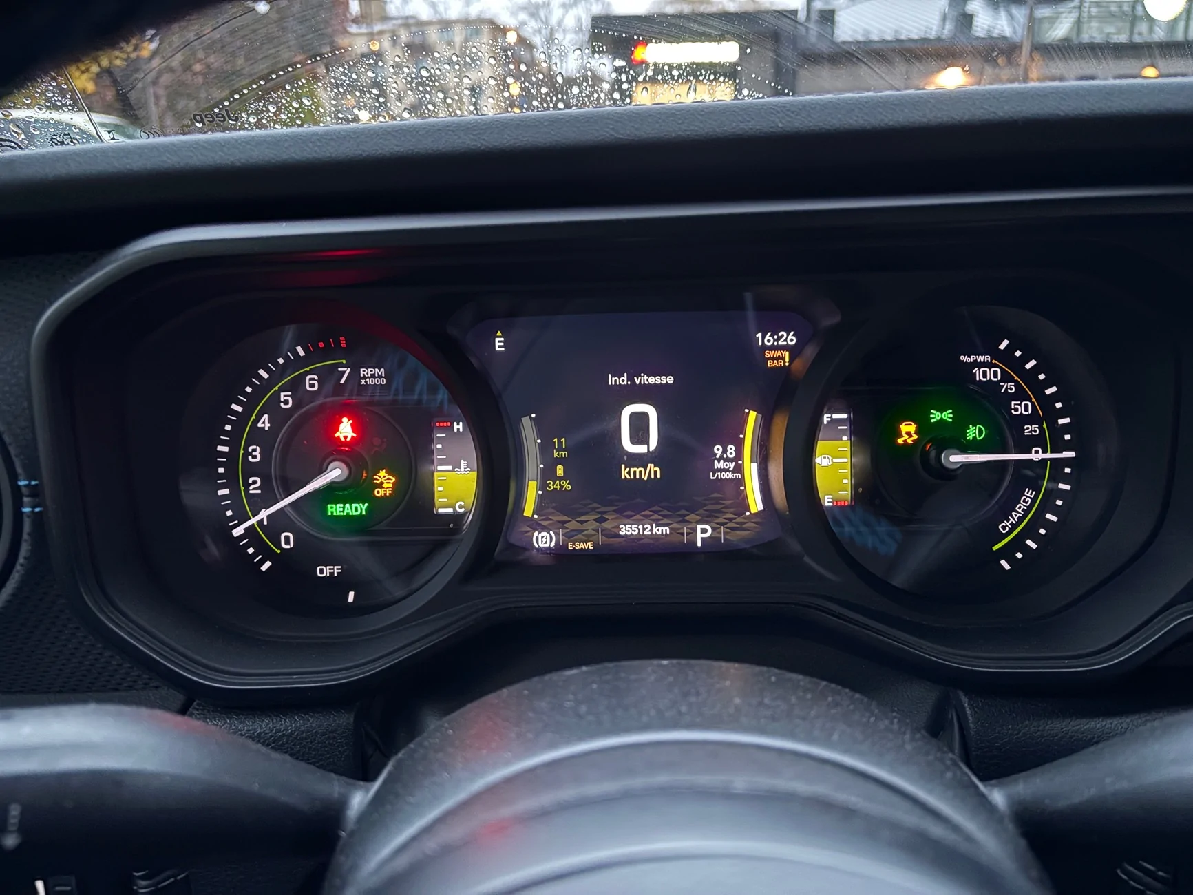

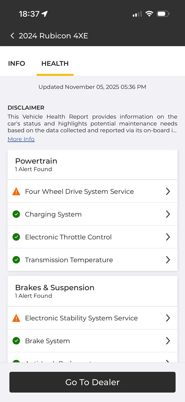

I got these messages twice today, they cleared between the two drive.
Now on the 3rd dtove, I have the Sevice Engine Light on.
Did any of you had this problem & What was the fix ?

Well those are generic warnings for an overall system and not specific DTC’s. You are about to have a bunch of people suggest replacing batteries and checking fuses. Instead, check the actual diagnostic faults.

I went to the dealer on Monday, they flashed my PCM to 68626222AN and cleared the codes.
As a precaution, I went to their parts counter and purchased a Star Connector / CAN Bush connector (the green one behind the glove box) and had the technician to replace it. They had two in stock, it shows that it might be a common issue.
I looked at my old one and all solders looked fine !
I just hope that the Gremlins don’t come back.
