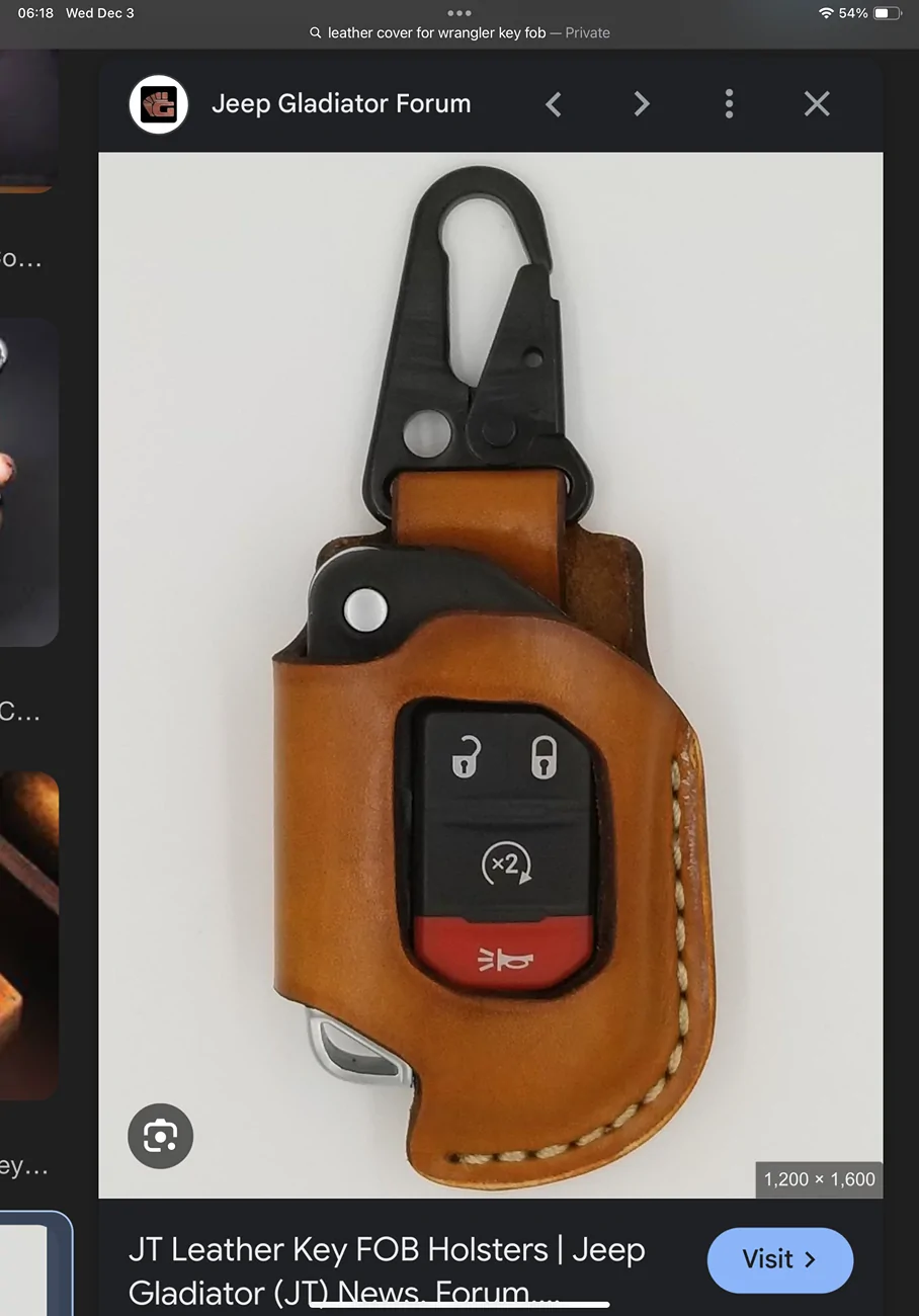

For folks who want to carry a key fob on their waist, there are some nice leather solutions with belt-clip and lock-snap options. I appreciate custom leather work and the made-in-USA factor, but these are too bulky for me. Still, the leather cover reduces risk of scratching other things.

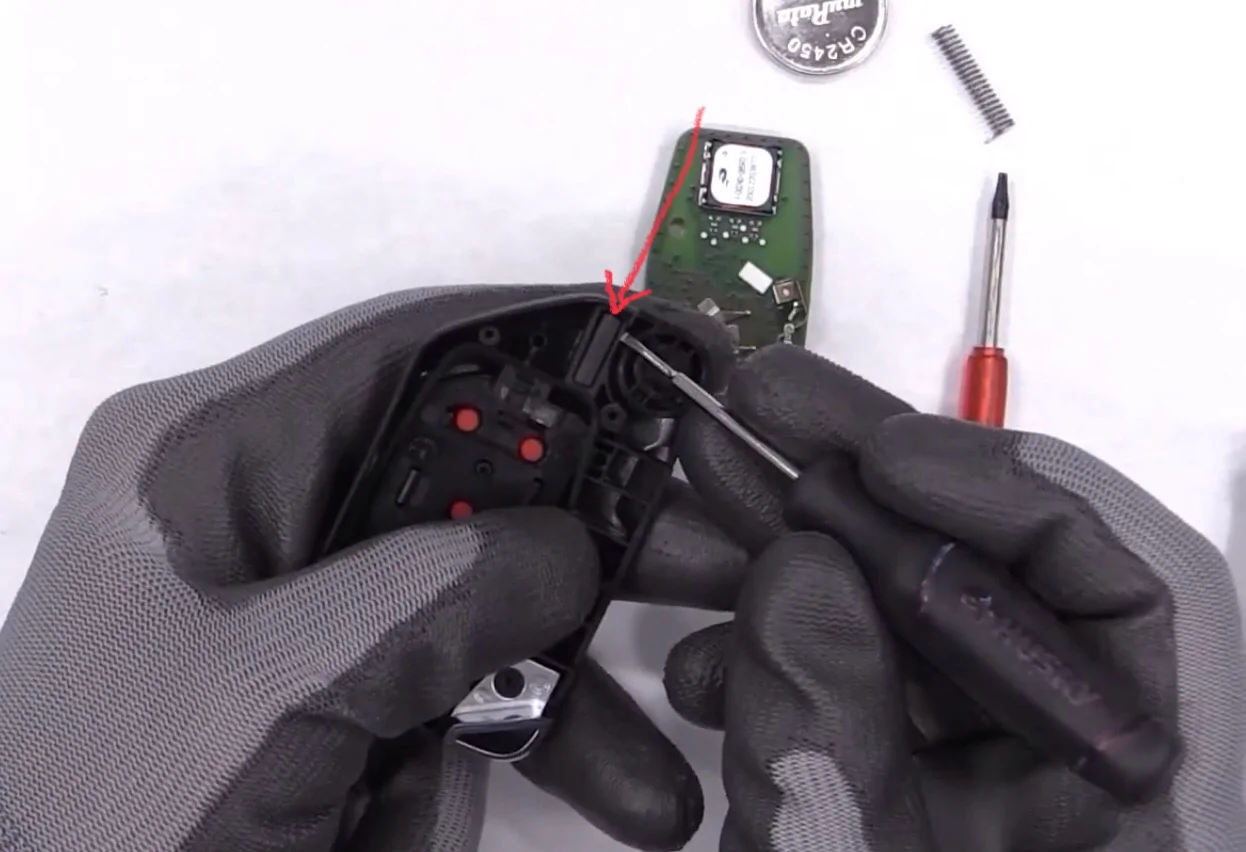

You will need to take the circuit board and RFID chip from one of your stock fobs and move them to the Threedom fob. Not hard to do. Yes, the process is reversible as there is no damage done to the stock fob.
Threedom sends you a little Torx driver and a black screw along with the fob.
On Threedom's website there is a good video that shows the deed you need to do...
https://mythreedom.com/pages/assembly-instructions
You are going to really like your @Threedom fob!
I viewed the (super small screen) video. Very hard to see what i wanted to see. As to that RFID gizmo (about a 1/16" X 3/8")..............I can't get it out of the orig fob. I note the guy in the video mentions that some are extra difficult to remove. i can bearly get a razor knife blade along side of it and not far enough to pry it out.
Any suggestions as i try not to destroy the damn thing. I sent a note to Threesome about my problem yesterday and still have not heard back.

As a tester forThreedom, in addition to helping local JL/JT owner's..... I have done probably 50+ fob swaps. Yes, on a few of the swaps the RFID resisted being removed but I did get them removed.
Worst damage that I did purposely was to very slightly damage (cut) one side of the RFID holding box, not the actual RFID chip. Once the RFID chip was out I just pushed that side back in...
Anyway...
Just look closely at the box like perimeter the RFID is surround by.... look closely and you will see a tiny tiny crease so to speak.
Just place a thin thin bladed screwdriver tip in there and tap tap the screwdriver handle with a small hammer.... The blade will sink downward and spread the one side of the chip holder.. Now just get in there .... in that tiny gap and pry the RFID chip upward...
IF, if the RFID chip is really really locked in there, then with a sharp blade you can carefully cut into the one end of the chip holder and cut/pry the side away from the chip.... Now get in there and pry.. DO, do be careful not to cut the chip.... After chip is out just press/force the cut box back into place.
Again, remember you really do not need the RFID chip actually in the THREEDOM fob. You just need to have the RFID available if you were to have a dead fob battery or if the fob circuit board dies...
Thus you can just stash the stock fob that you disassembled in the JL somewhere should you need it.
In closing... I do believe you can get the RFID out now that I have given you some info... and that you know that RFID chip is very stout ... very resistant to damage and you aren't going to easily damage it, etc..

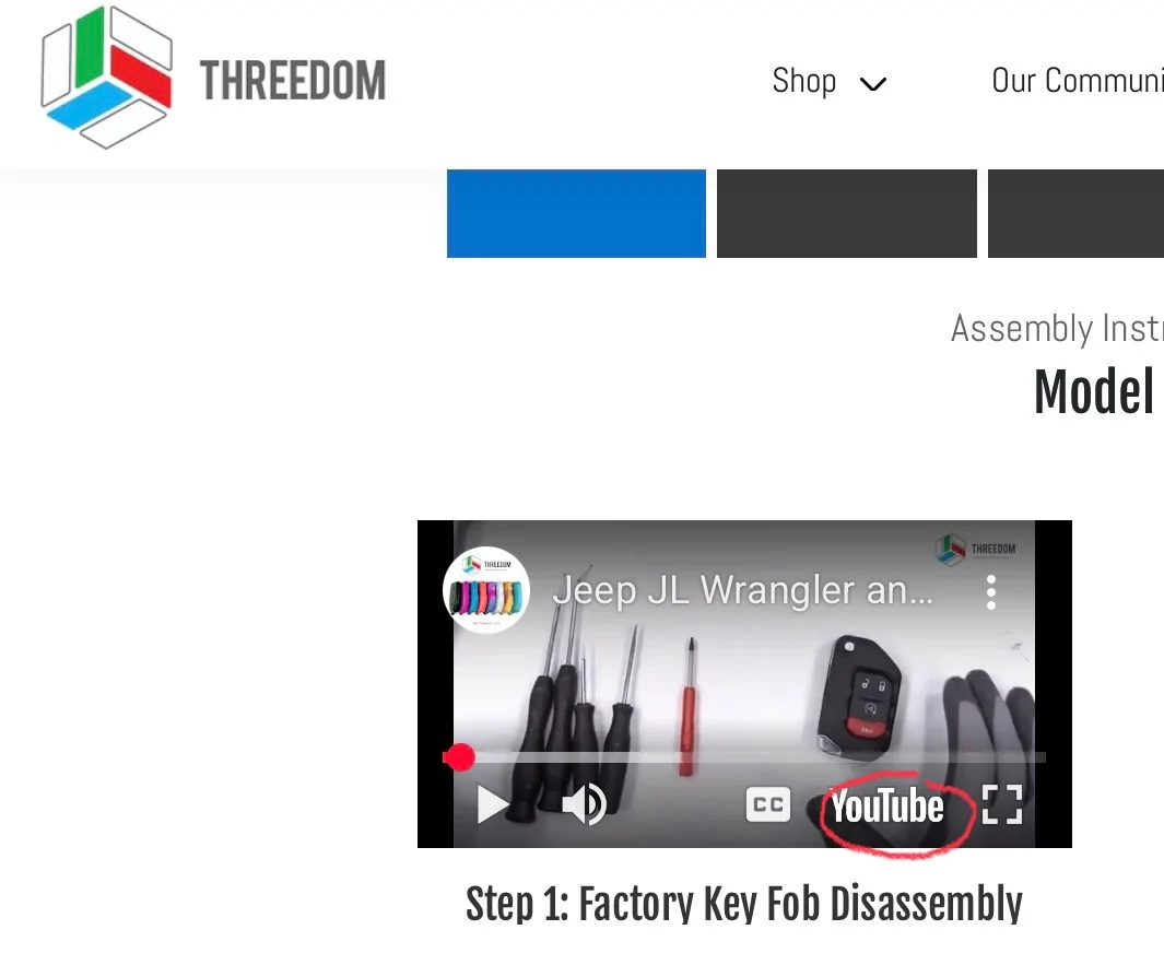

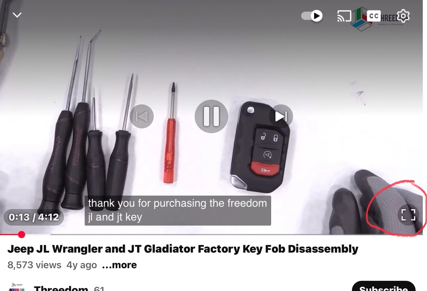

In the small video on their website touch near the bottom right corner and you will see “YouTube” click on that and it will open the video in YouTube. Once in YouTube touch in the bottom right area of the video and you will see an option that will change the video to full screen. I used a small pick and pried at the point shown in the pic with the red arrow. A very small jewelers screwdriver will work

Yup, I did indeed have a mini screwdriver set and was able to jam that blade down next to the chip and extract it. (Using a magnifying glass, never did see any kind of "crease" to follow).
I've now tested the new fob and it works..........With this new model fob, it appears that you add the little black key ring thing to the key and then decide where the hell you plan to keep the key.
Thanks again for the better explanation as to how to get the chip out.
