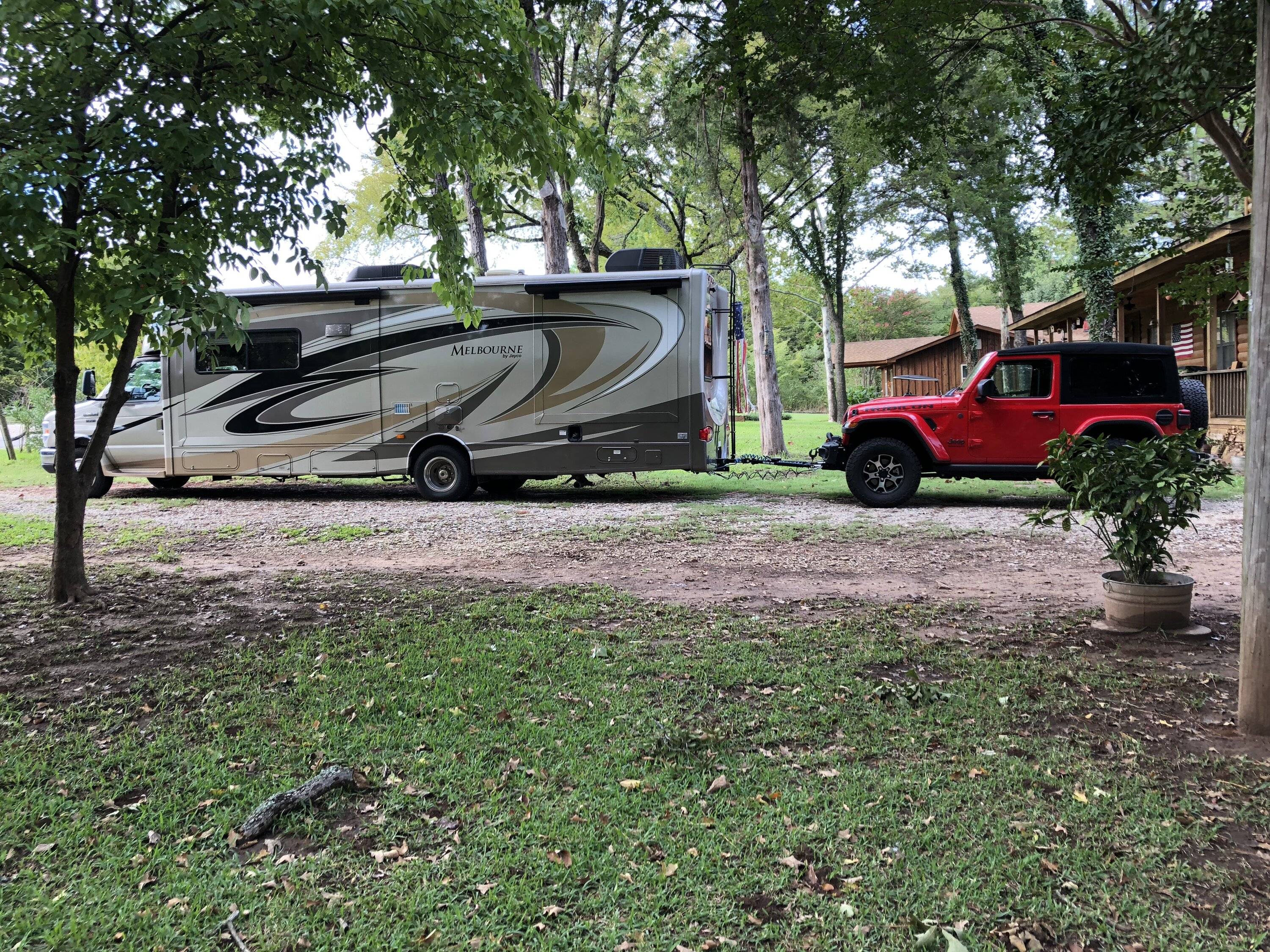

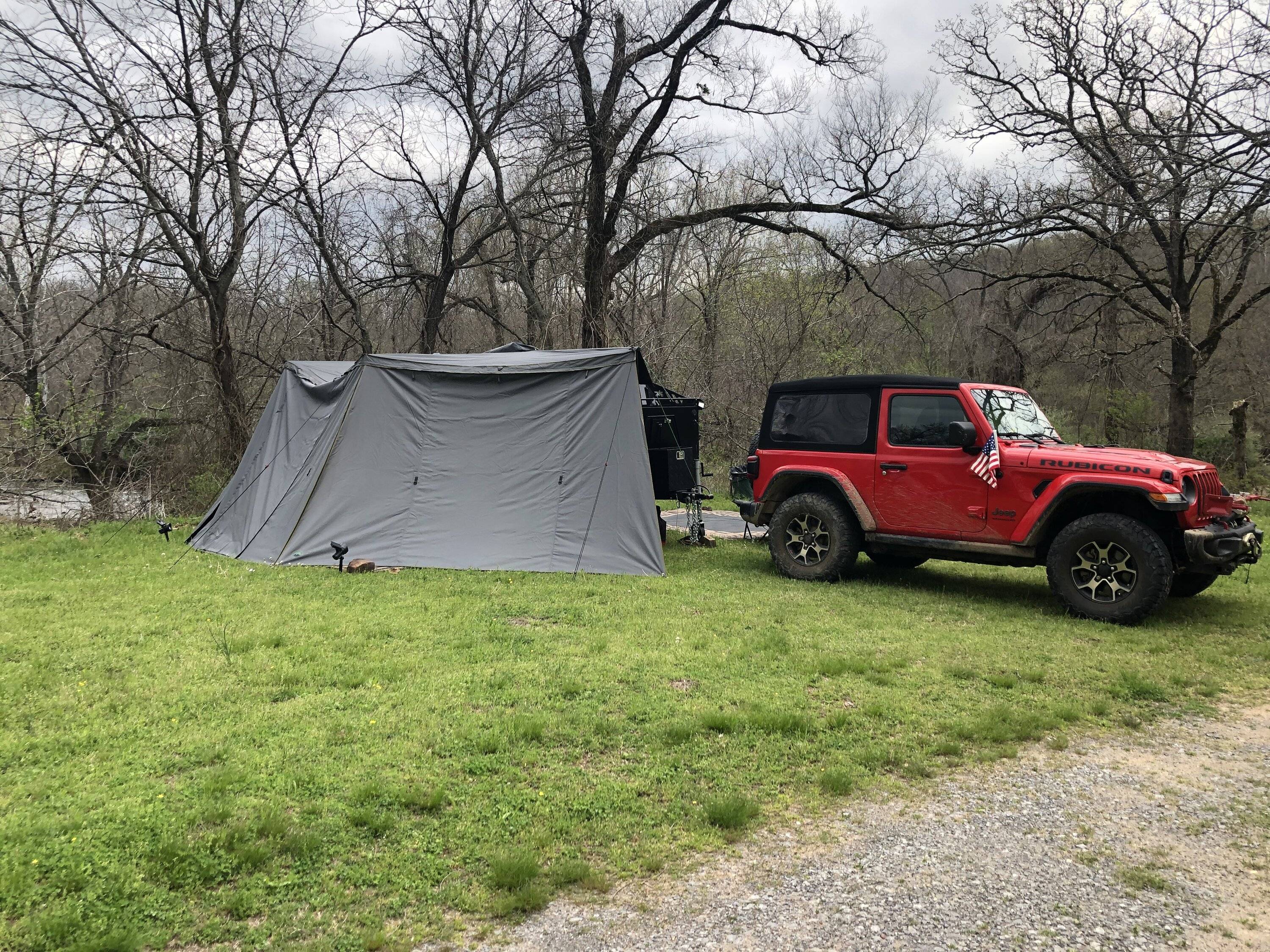

BlueOx system is what I used to flat tow 2018 JLR with motor home before I switched to Offroadtrailer.
Jeep Wrangler JL Flat towing 2021 wrangler IMG_1939
Jeep Wrangler JL Flat towing 2021 wrangler IMG_0299

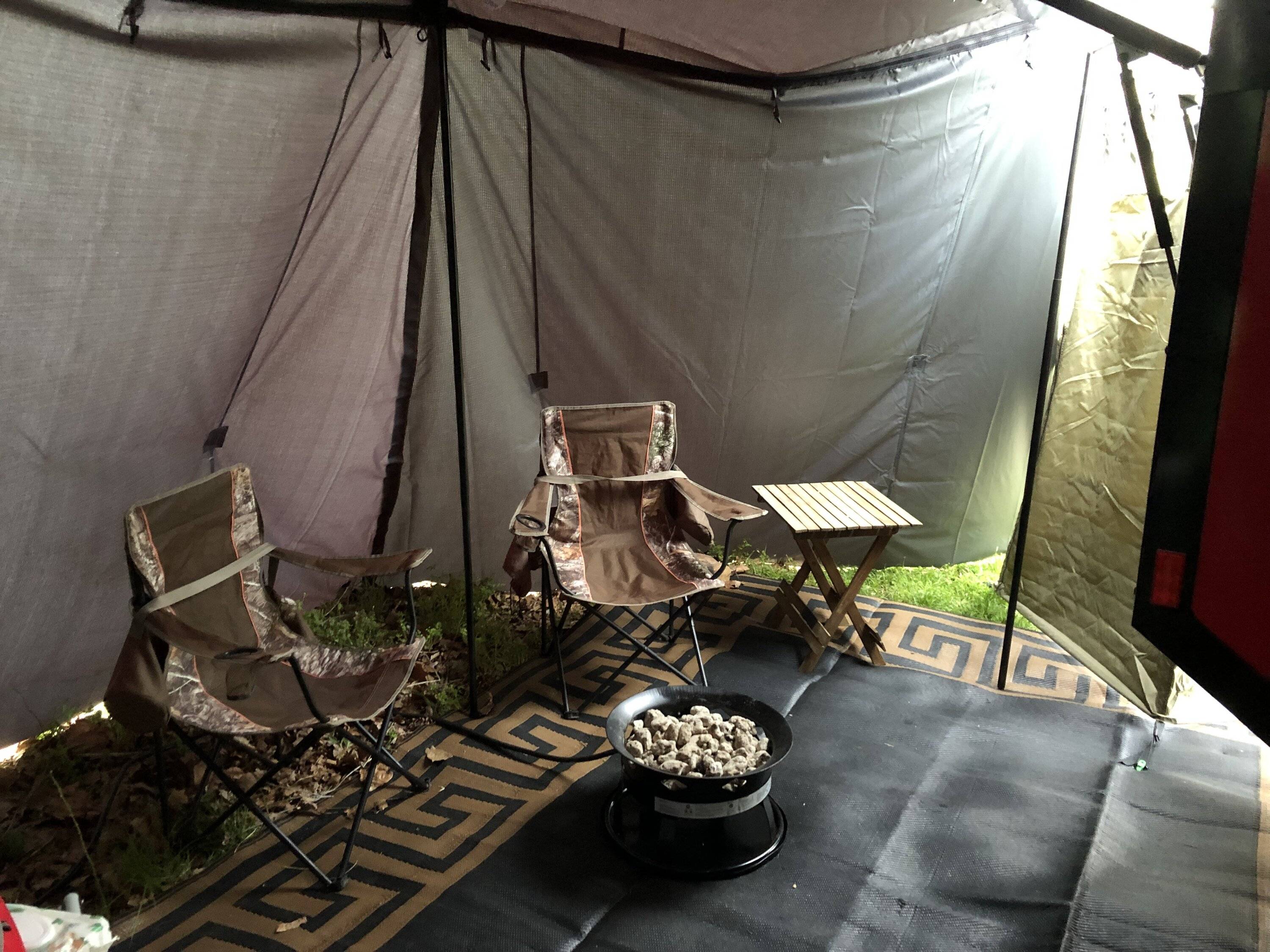

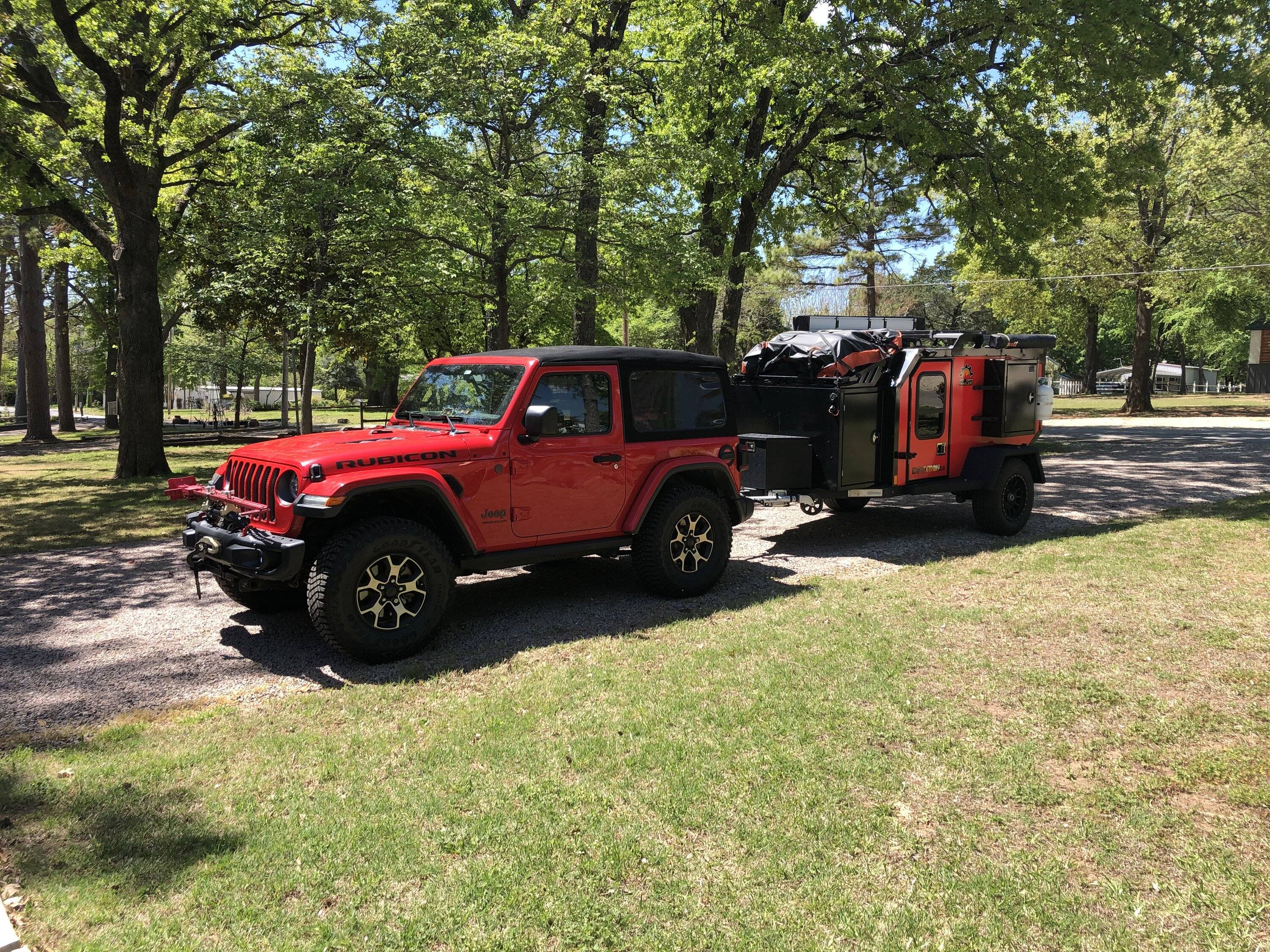

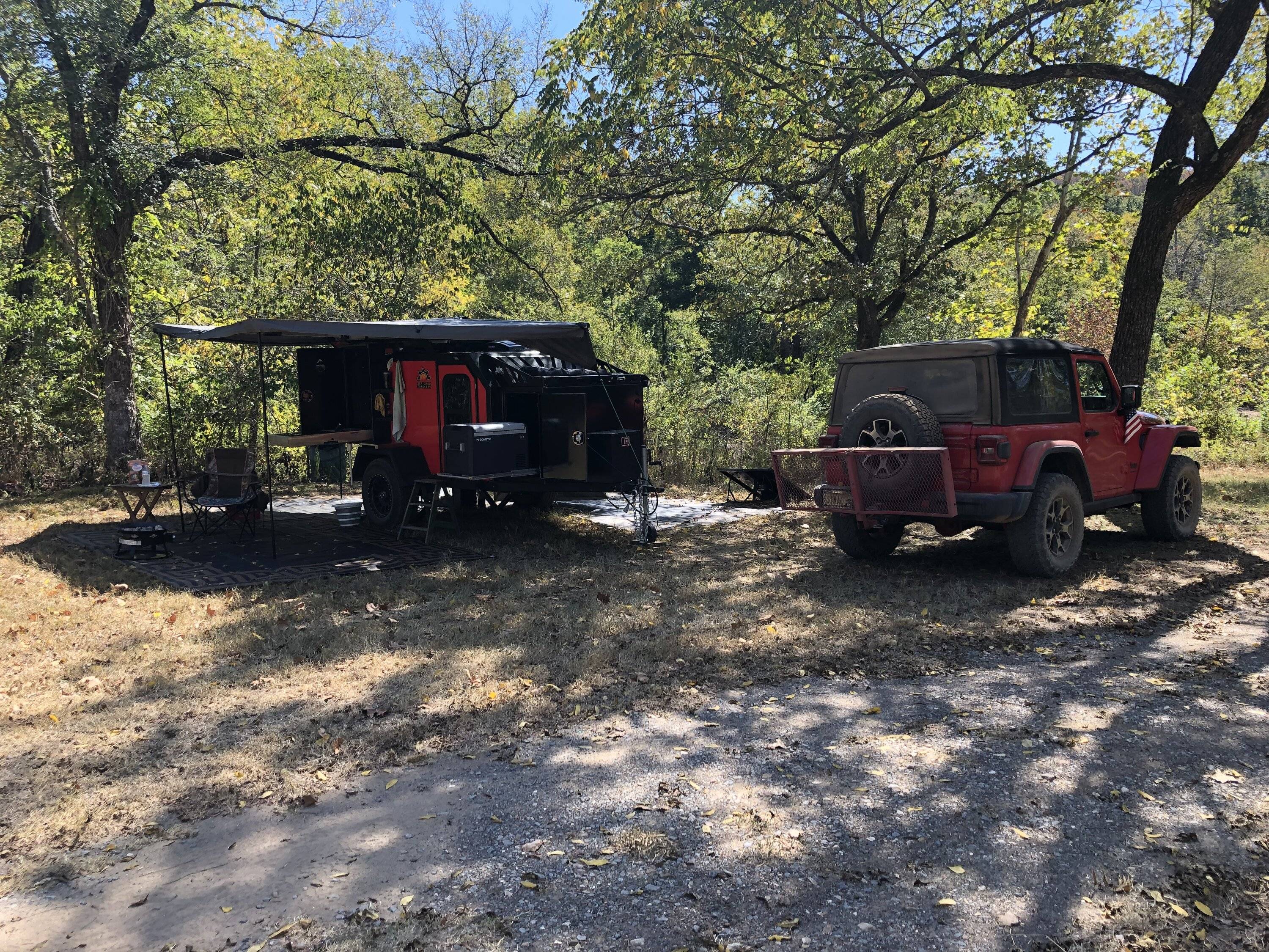

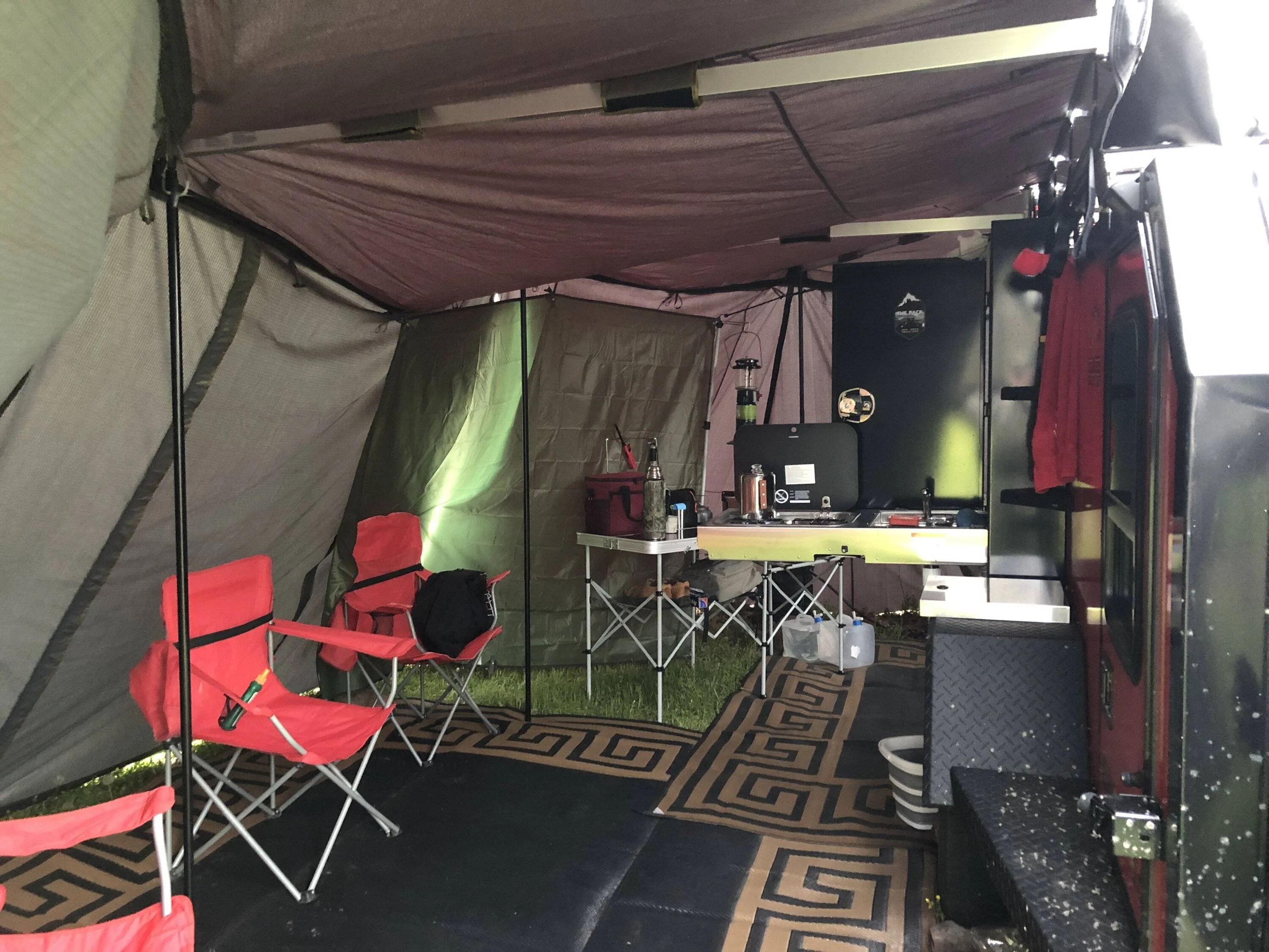

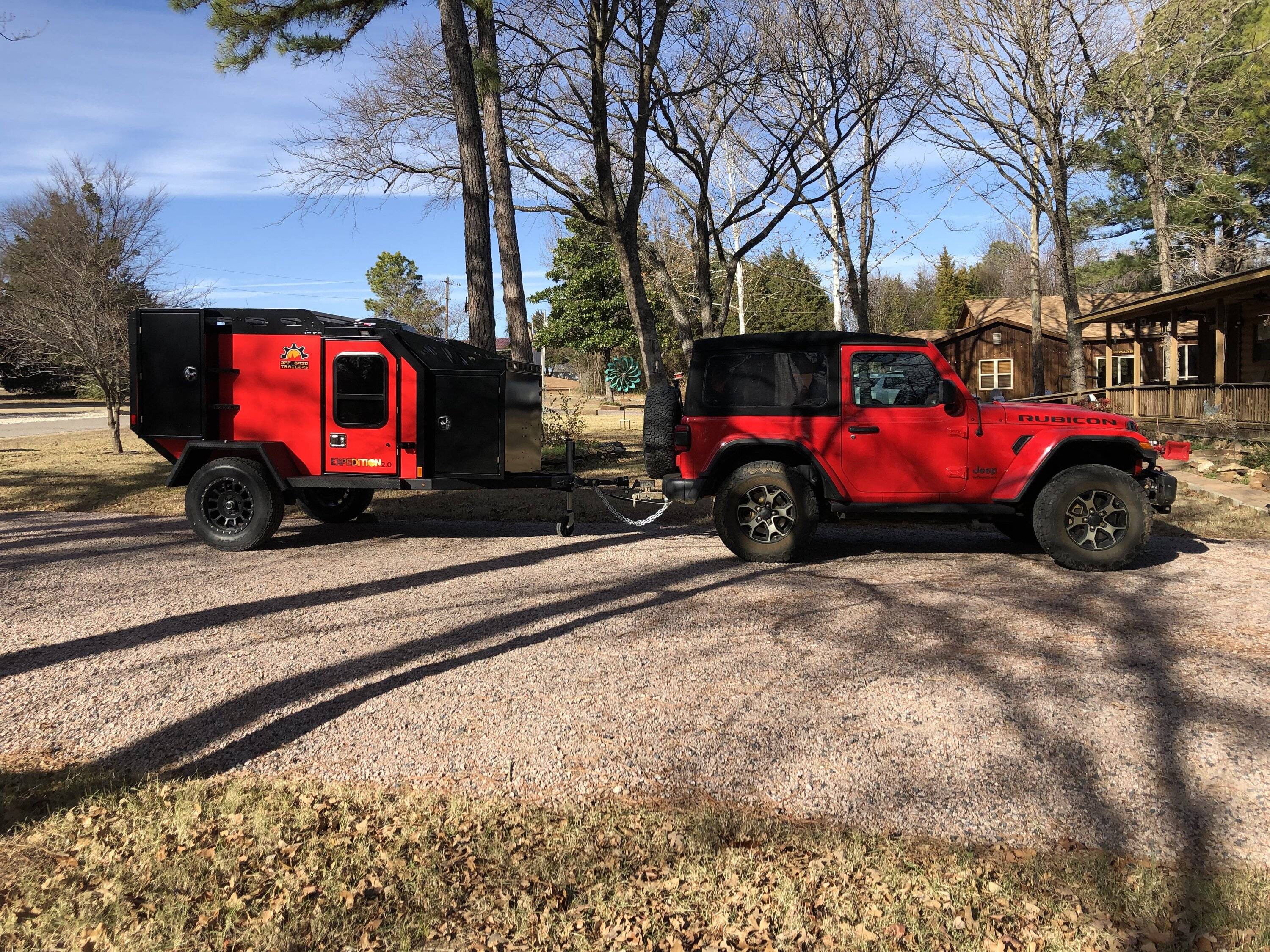

No not by my v6 auto with 4:10 air pillows and 35’s. Trailer(scaled) 1850# dry 2350# wet and loaded. Jeep with just me and 100# extra load. All works great, no squat or wiggle with max coupler. Also has 10” electric brakes on trailer and curt echo phone control.
Jeep Wrangler JL Flat towing 2021 wrangler IMG_2550
Jeep Wrangler JL Flat towing 2021 wrangler IMG_2351
Jeep Wrangler JL Flat towing 2021 wrangler 67175299589__D67A3A9F-55C3-48C0-B4A8-97D0F58B2C75
Jeep Wrangler JL Flat towing 2021 wrangler IMG_2115
Jeep Wrangler JL Flat towing 2021 wrangler IMG_2117
Jeep Wrangler JL Flat towing 2021 wrangler IMG_2116

Be careful. Legally speaking that's an over weight trailer (JL 2dr has a 2000lb max tow weight). This could rear its ugly head in a surprise traffic stop or in an insurance claim, whether it was the cause of the claim or not.
Yes, max tow weight is higher in Europe but most of Europe caps the speed limit of vehicles with trailers at 50 MPH. European weight at US speeds is dangerous.

True that, but I don’t care. Not being rude, I go by over all or gross weight of trailer + load + vehicle compared to allowed gross weight. I also limit my speed when towing also I don’t have a phone or computer in my face while driving.
