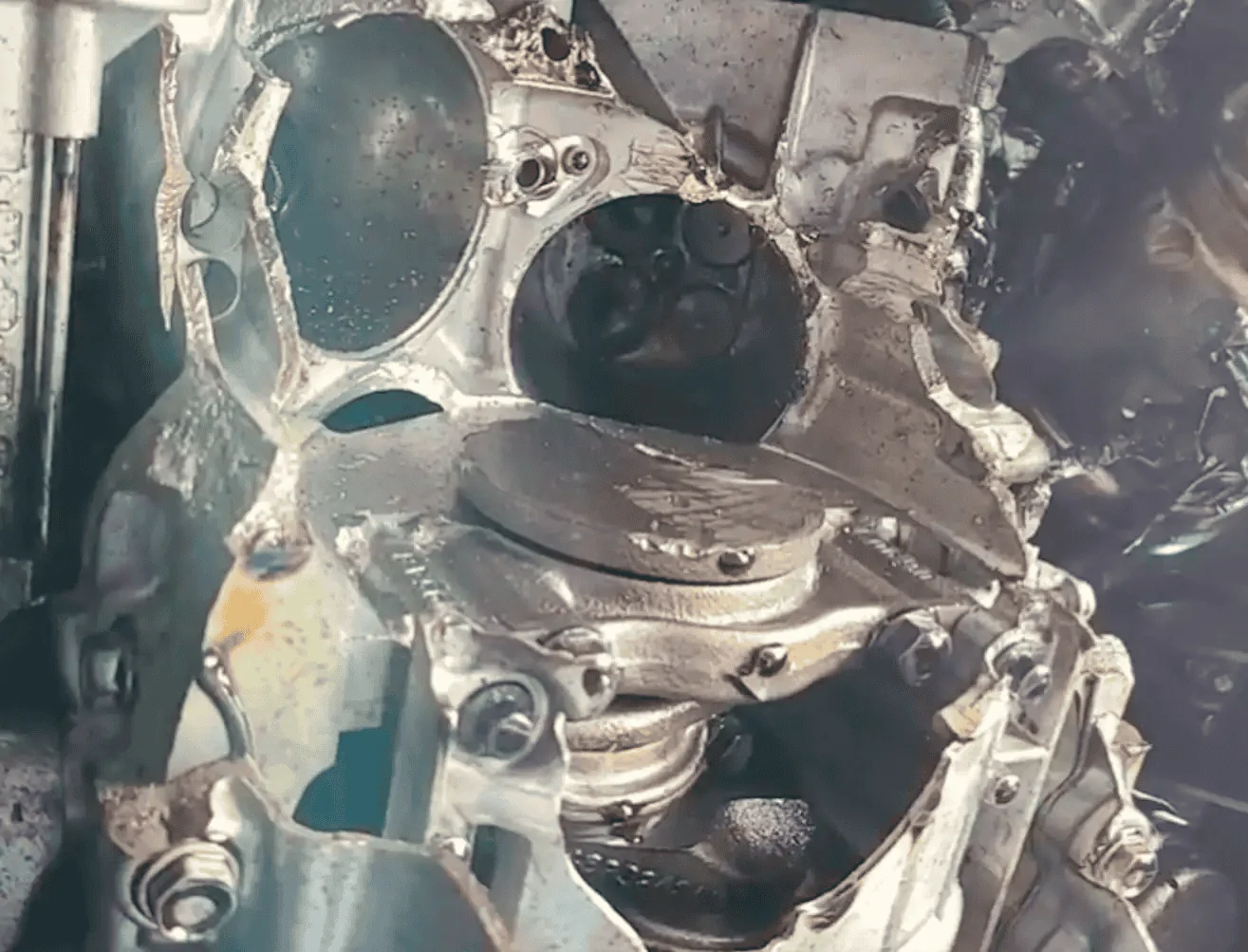

HAHA. That probably looked like the inside of my TJ transmission once. After about 6 years Full time and pulling my TJ over 75000 miles, I made the bone head error. Late getting out of our campsite and the incoming was waiting for us to leave. Hooked up the jeep and put the shifter in neutral. Got distracted and drove off. 6 hours later pulled into a rest area for the night. Did a walk around and thought, that smells weird. Looked inside the jeep and had that , oh shit moment.
