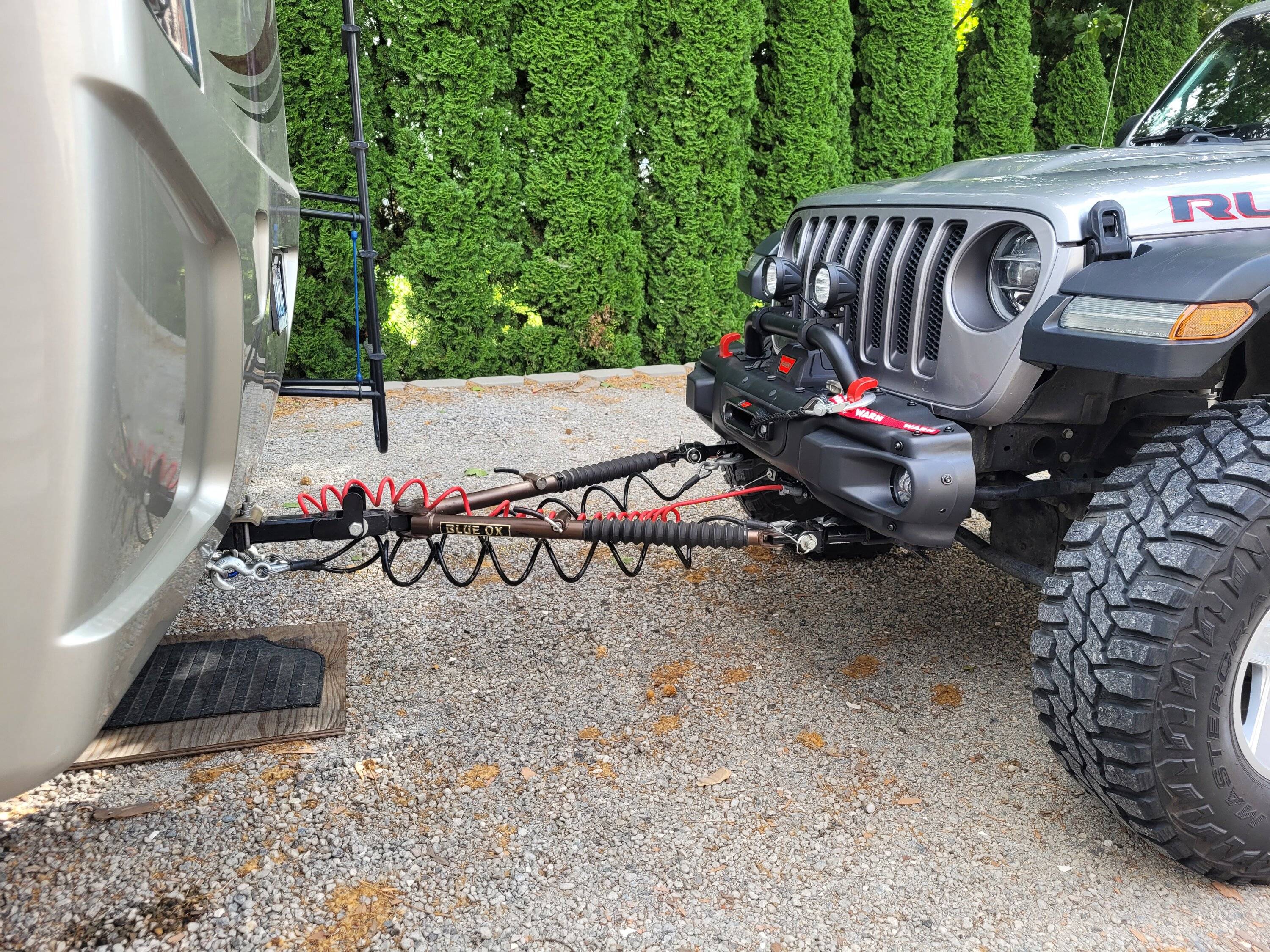

I have Roadmaster tow bar mounts and used to have a plastic bumper on my Rubicon. I bought the Ebay factory replica steel bumper, modified the winch plate slightly, and made it work with a winch. A tow rated bumper mount will raise your tow points, and there is only 3 that I know of, and you will need frame tie-ins.

The Roadmaster mount sandwiches the frame. This added 1/4" of steel on each side doesn't allow the winch plate to drop down in-between th frame. A simple skinny wheel shave of the winch plate, then new bolt holes for the brackets and all is good. The hardest part was getting the inside bumper nuts started with the winch there. No room for hands and fingers. I fished the nut in on the end of a telescoping magnet.

Thank you that looked perfect and what I needed to go for it.

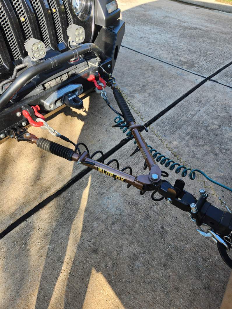

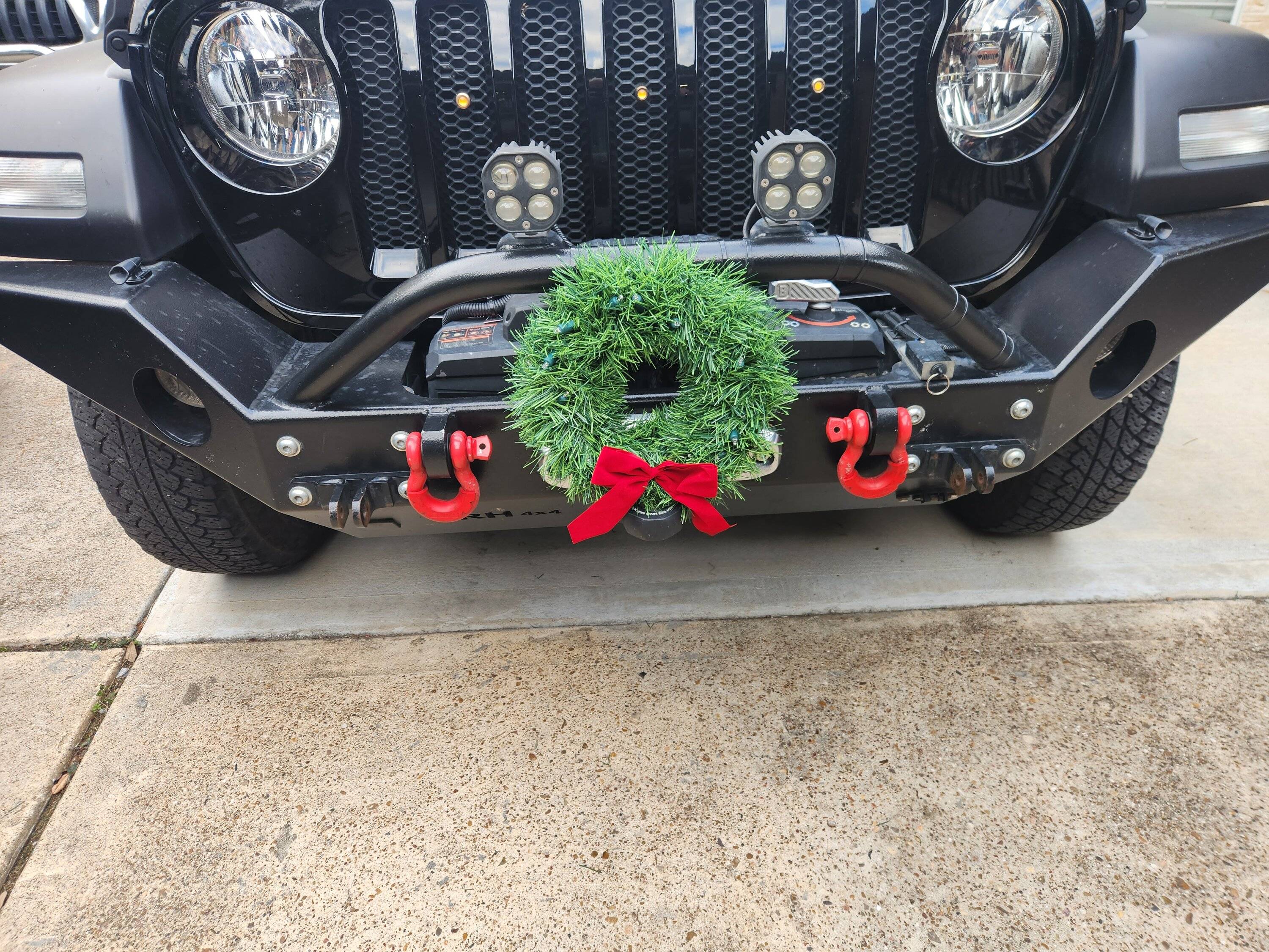

I've been quite happy with my bumper from Rockhard 4X4. Only one I have ever seen advertised in motorhome magzines and rated for flat tow. The safety cables mount to the D rings and I had it made with Blue Ox attachment points.
Jeep Wrangler JL Need a Flat Tow bumper 20231125_161911
