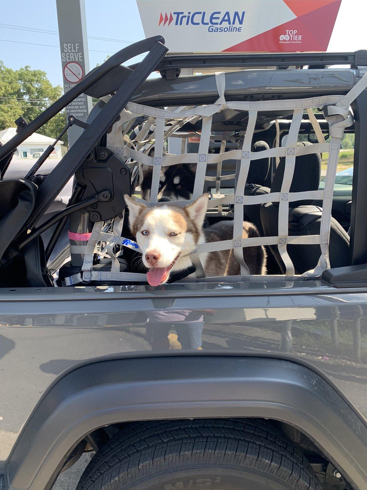

Took my jeep for its first top down test ride and noticed the rear passenger seat belts flapping. So went to an auto parts store and purchased some seat belt shoulder pads. No more flapping! On the jeep anyways. :)

I just use Velcro. Do those pads allow the seatbelts to be used while they’re on? If so, I guess that’s the advantage over Velcro.

No. It only takes a second to undo. Just leave it on the belt for passengers.

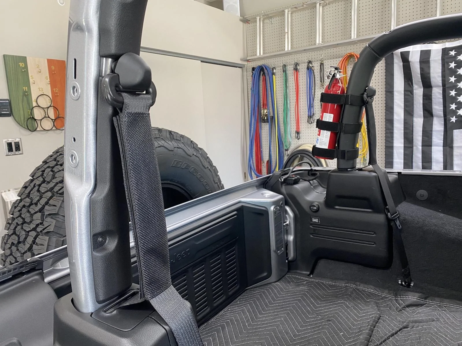

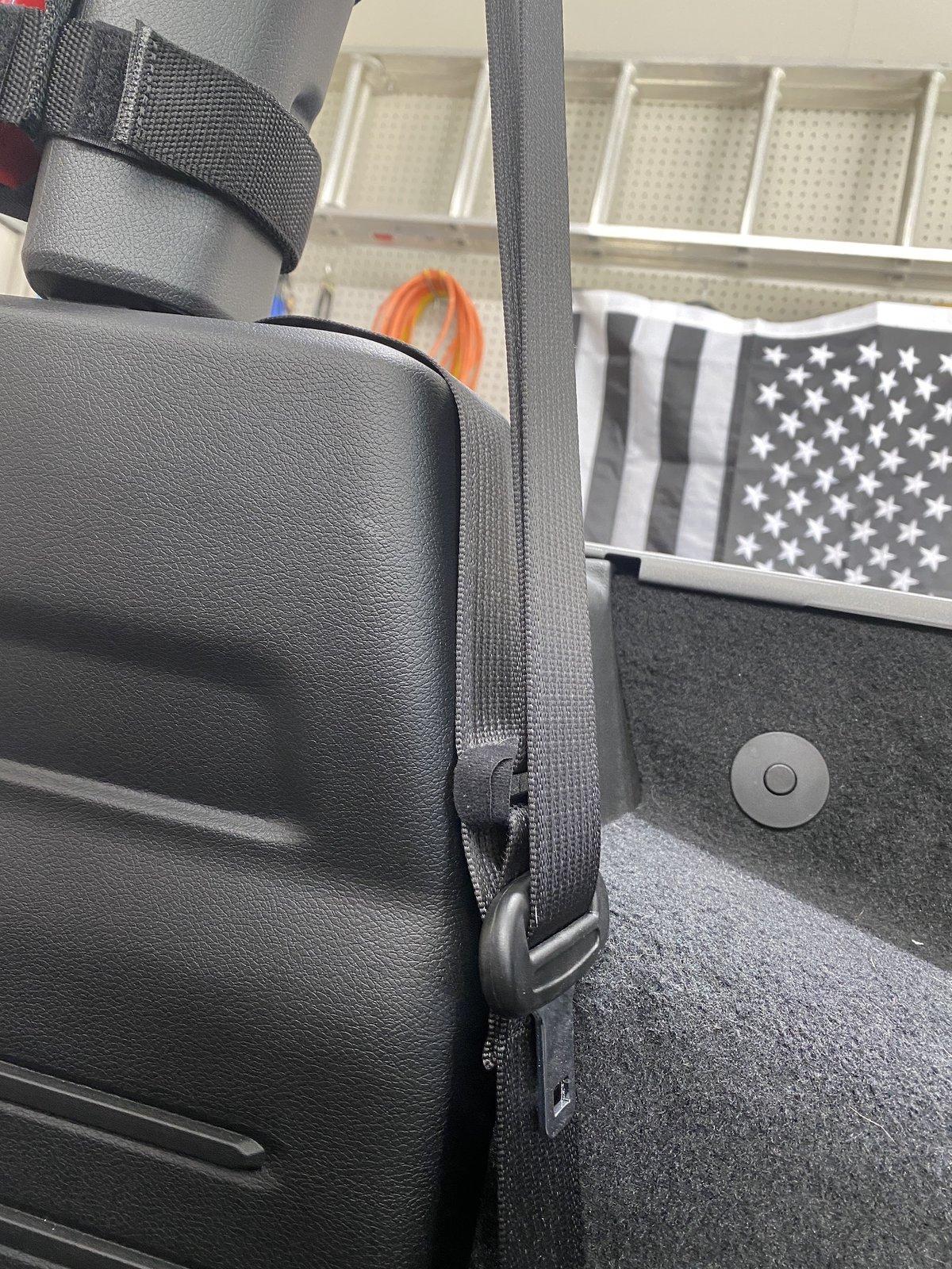

I've tried two different things that work really well. The first is cheaper (or free if you have some velcro around). The second is a bit simpler to use.
1. velcro cable tie. Simply pull the seatbelt downward (from the back strap) until it meats the loop just below the seatbelt buckle's tongue. Wrap some velcro around there and everything should be much quieter!
Jeep Wrangler JL Flapping rear seat belts on 2dr solution. IMG_8165
2. SpiderWebShade's Velcro Seatbelt Silencer. It's larger but easier to add/remove... It also comes with a gaudy logo on it, but you can rip that off with some seam rippers to clean it up.

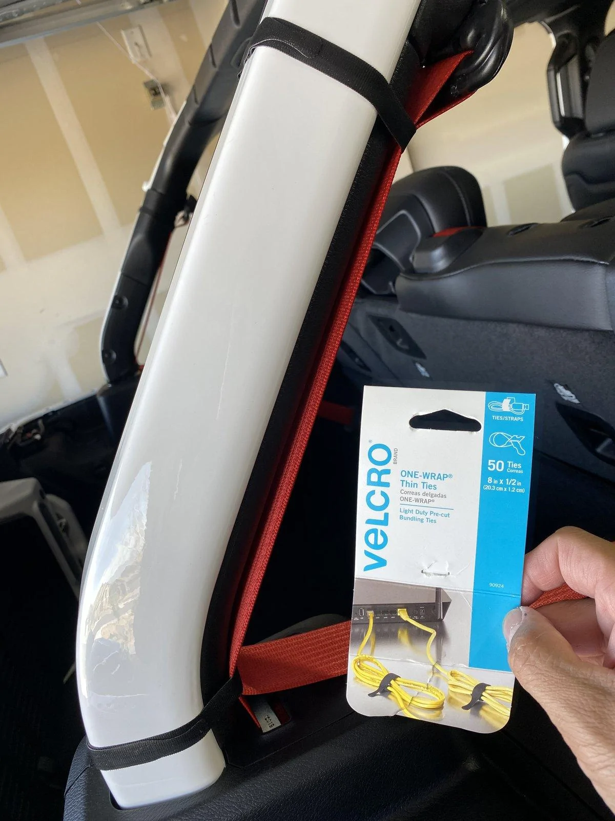

$5 solution from Lowe’s. Works perfect and it’s Velcro so it take 5 seconds to remove. Tested up to 75mph
