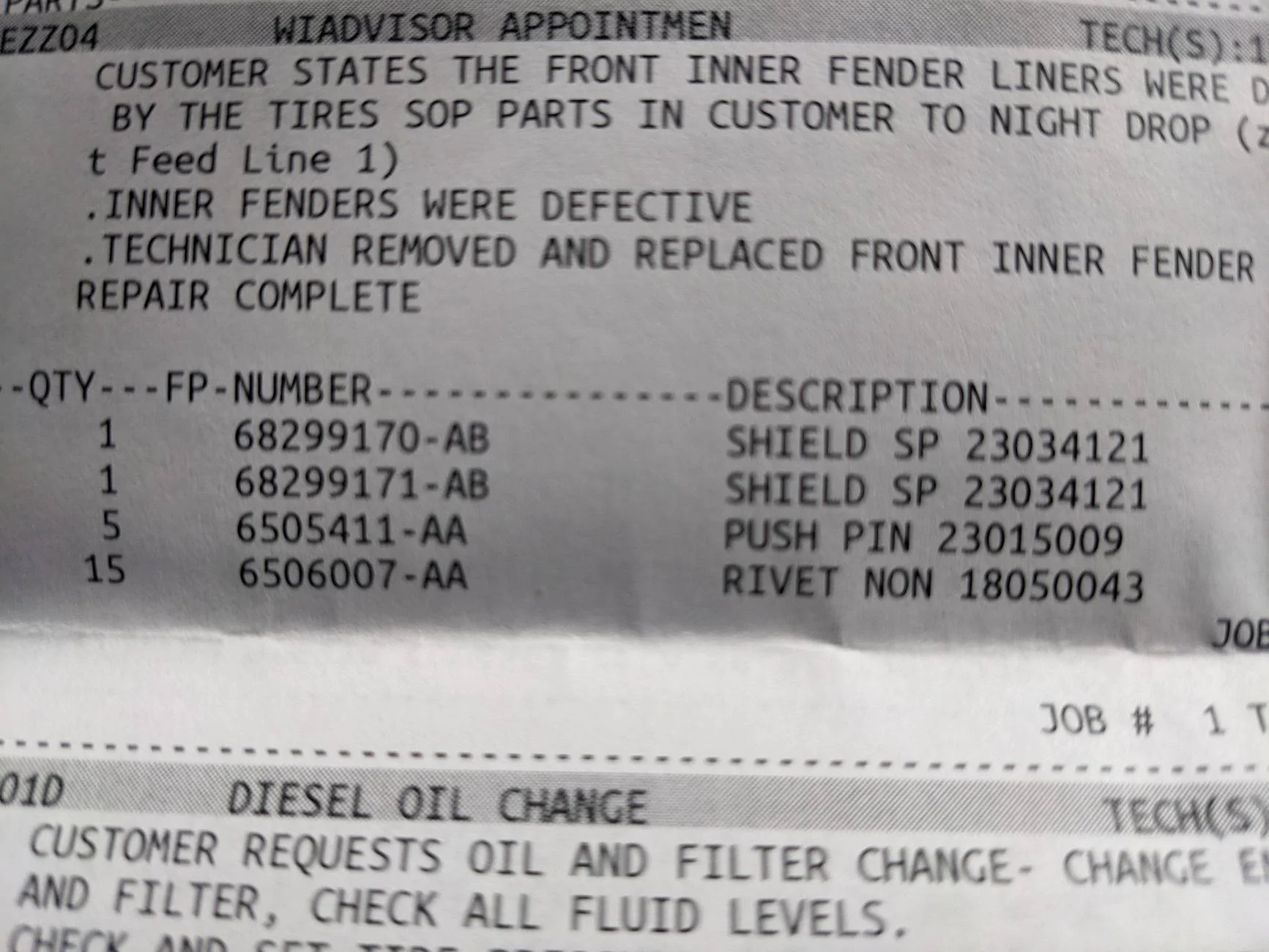

I had my 2021 JLURD eat to sets of factory fender liners. It always happened at freeway speeds with a strong head wind. Both times they were replaced under warranty. I noticed that they have two different thicknesses of factory liners. My third set have been fine and are thicker than the others that were installed.

Thank you! By any chance, do you know what the part number was? If it's too much of a pain, don't worry about it! I ordered what I ordered, just wondered if I'm getting another piece of junk or something a little more solid.
I could not find the part number for the last ones they installed but I do know the below numbers are the thinner ones.
Jeep Wrangler JL Fixing Stock Inner Fender Liners PXL_20241011_234022997
Thank You! The part I ordered is 68299171AE. I'm hoping that the last character represents maybe version number? At least I know it's not one of the thinner ones.
Also, thanks. I was going to reuse the existing rivets and pins but it looks like I should order them for this job too.
