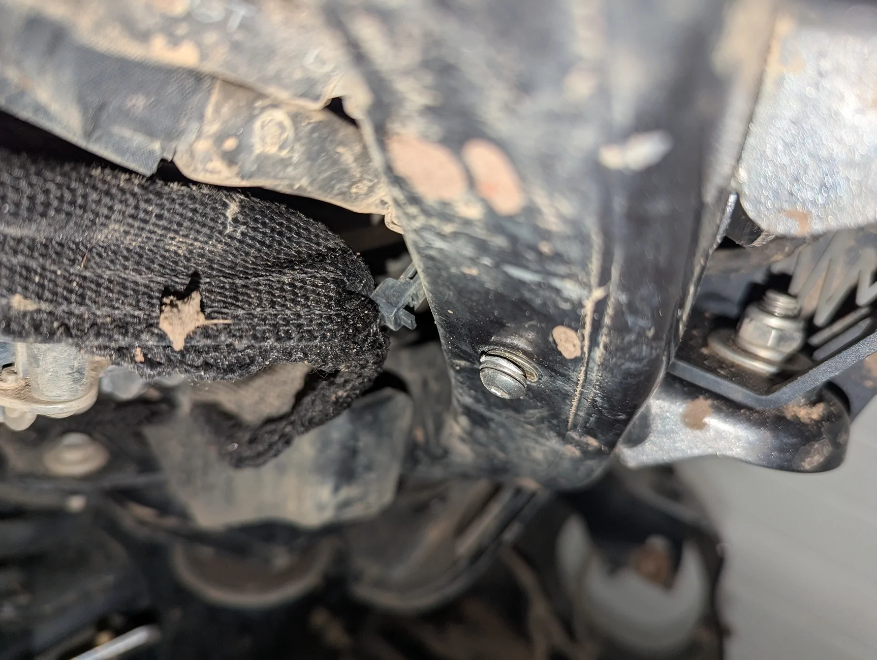

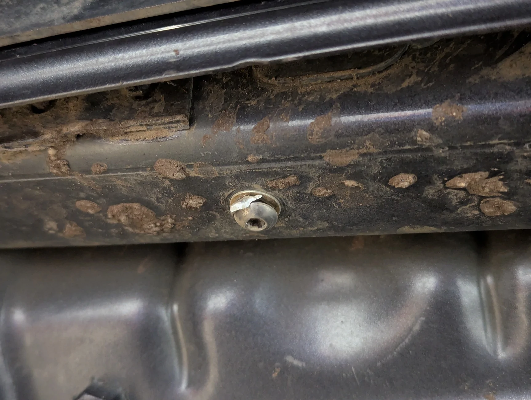

I’ve had the same Motobilt front inner fender liners for about 2.5 years. I have no rattle, but I did have one of these brackets break and Motobilt promptly sent me a pair of replacements. I’m guessing just fatigue over time from things flexing off road. I used blue Loctite on everything but ended up using a longer hardware with a nylock nut on the back because the bolt circled in red would back out over time.

Yea I had that one fall out on me a few times and I put in a lock washer and a nylon nut which didn't help but it never fixed my rattle.

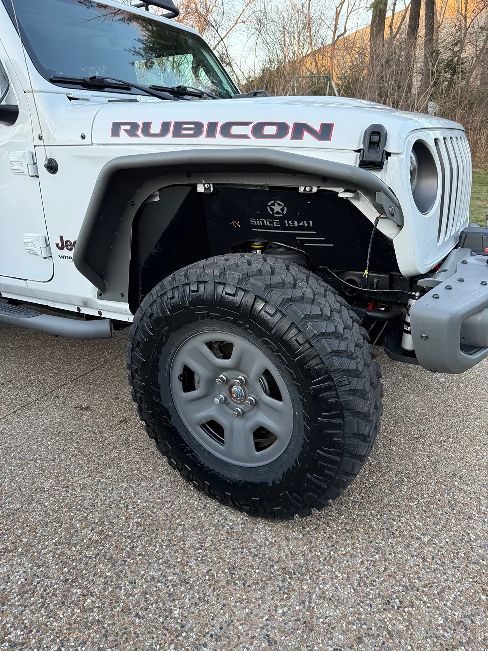

I just installed the inner fenders from Hooke Road. Install was simple on my JLUR diesel. No need to relocate anything.

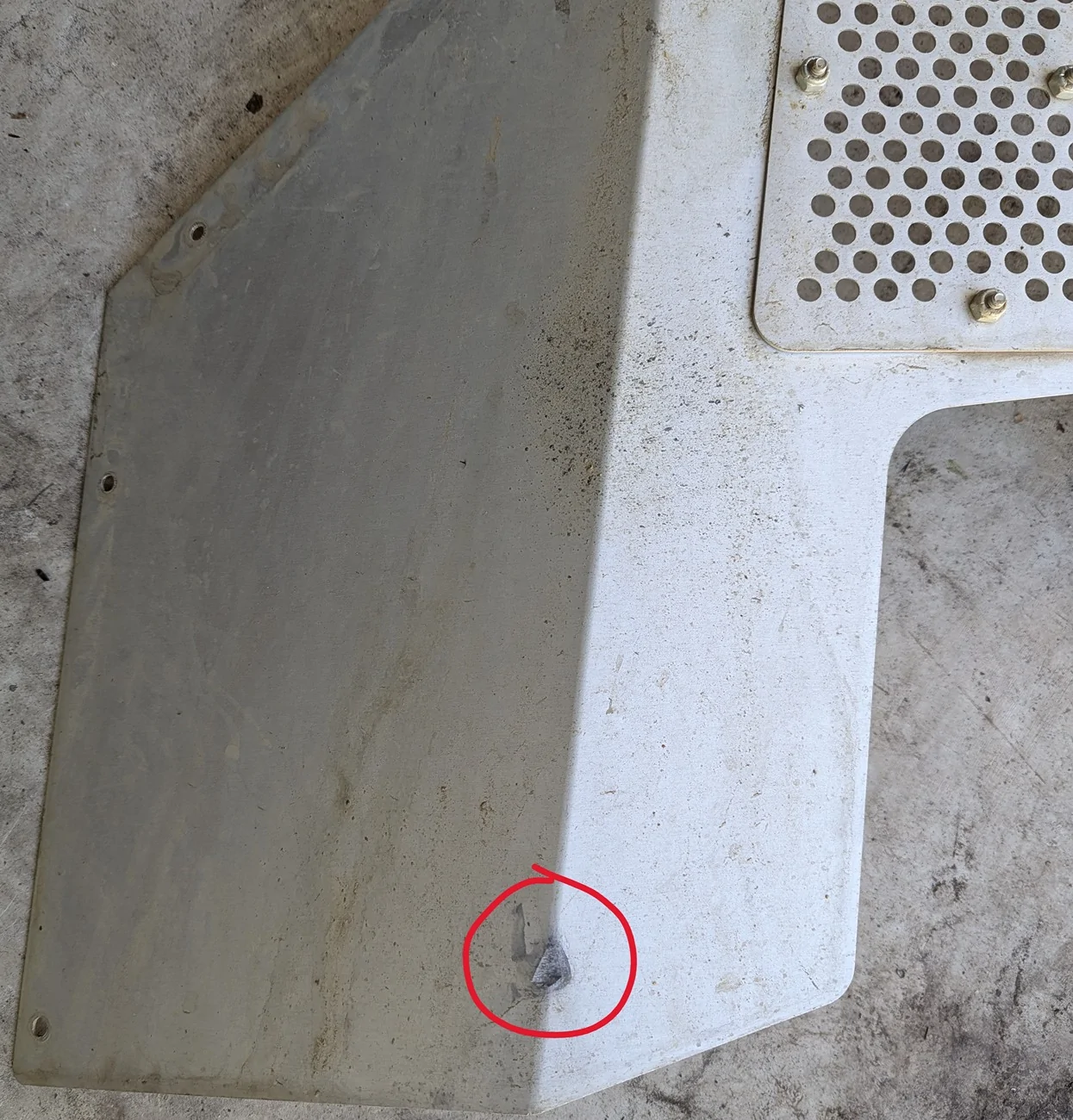

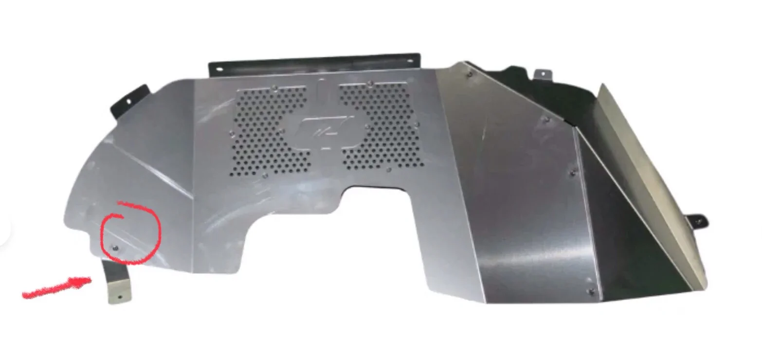

I decided to take advantage of a sale that Next Venture Motorsports was running and purchased their inner fender liners.
After removing the one remaining fender liner on the driver side, I found where the liner was interfering with the washer fluid relocation. I believe this was the cause of my rattle seeing that the washer tank was mounted to both the body and frame, and as I would resolve it, it would wear more, loosing up and then cause the rattle.
Jeep Wrangler JL Inner fender liners recommendations motobilt driver side inner fender rubbing
Installing the NVM liners, the fitment was similar to the Motobilt ones and took some persuasion, which was slightly disappointing considering the price. I did have to trim some of the top front perimeter on the driver side to get it to clear enough to push the last bracket in place to drill the hole for the rivnut. They fit, but I have to install the dzus fasteners in a specific order to get them all installed, otherwise they won't fit. I did remove the washer fluid tank bracket that mounts to the frame and made my own that mounts to the firewall because otherwise it would interfere with the NVM inner fenders.

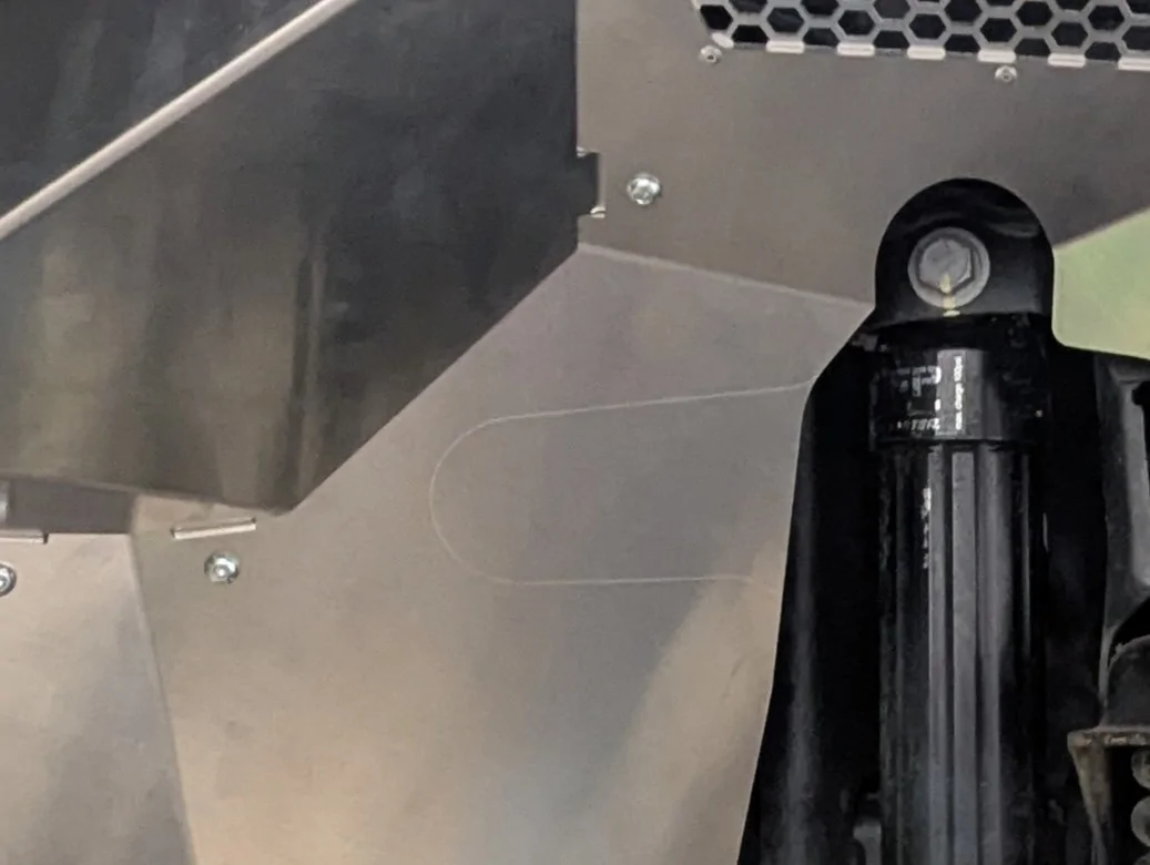

The liners have what seems to be an outline for cutting to clear other shocks( I'm guessing falcons), which is nice but I wish they would've done this on the back side, rather than the side visible when installed.

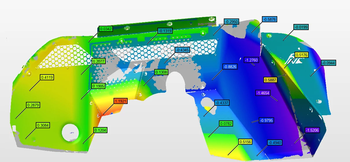

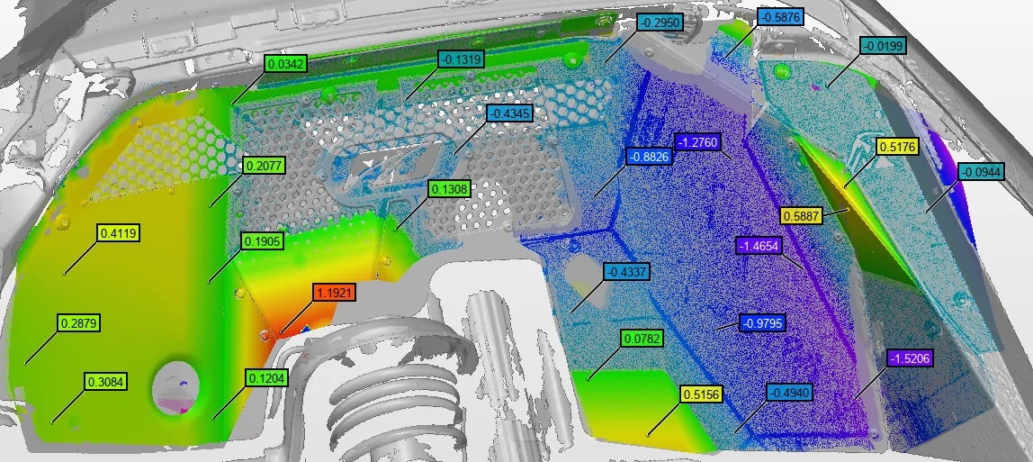

After installing I decided to compare clearance between the two.
Jeep Wrangler JL Inner fender liners recommendations Driver Inner Fender NVM vs Motobilt 2
Jeep Wrangler JL Inner fender liners recommendations Driver Inner Fender NVM vs Motobilt frame hidden
Near the firewall there are areas where the NVM liners have as much as 1.5" more clearance than the Motobilts. Towards the front of the Jeep the Motobilts have 0.120"-0.5" more clearance, which seems to be due to the fact that they use a bracket to mount to the frame allowing it to hold it nice and close. The red spot is showing Motobilt has over an inch more clearance over the NVM but that is directly on top of the spring perch so really doesn't impact tire clearance.
Anywhere there is a negative number, NVM has more clearance, positive number, Motobilt.
I wish I had scan data for the passenger side before mine ripped off but I'm assuming it is similar.

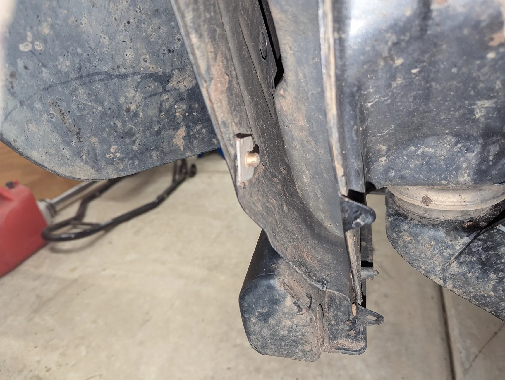

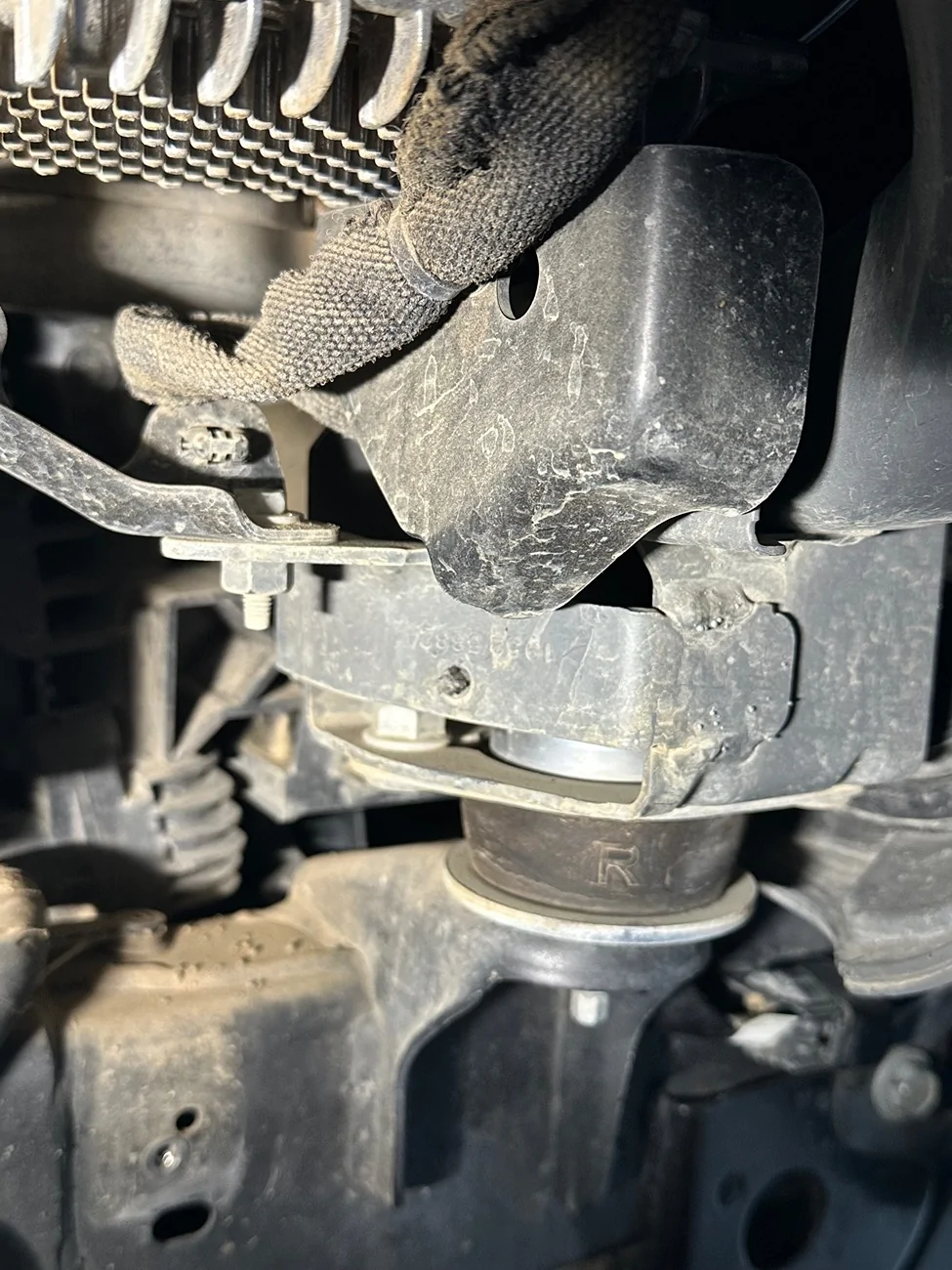

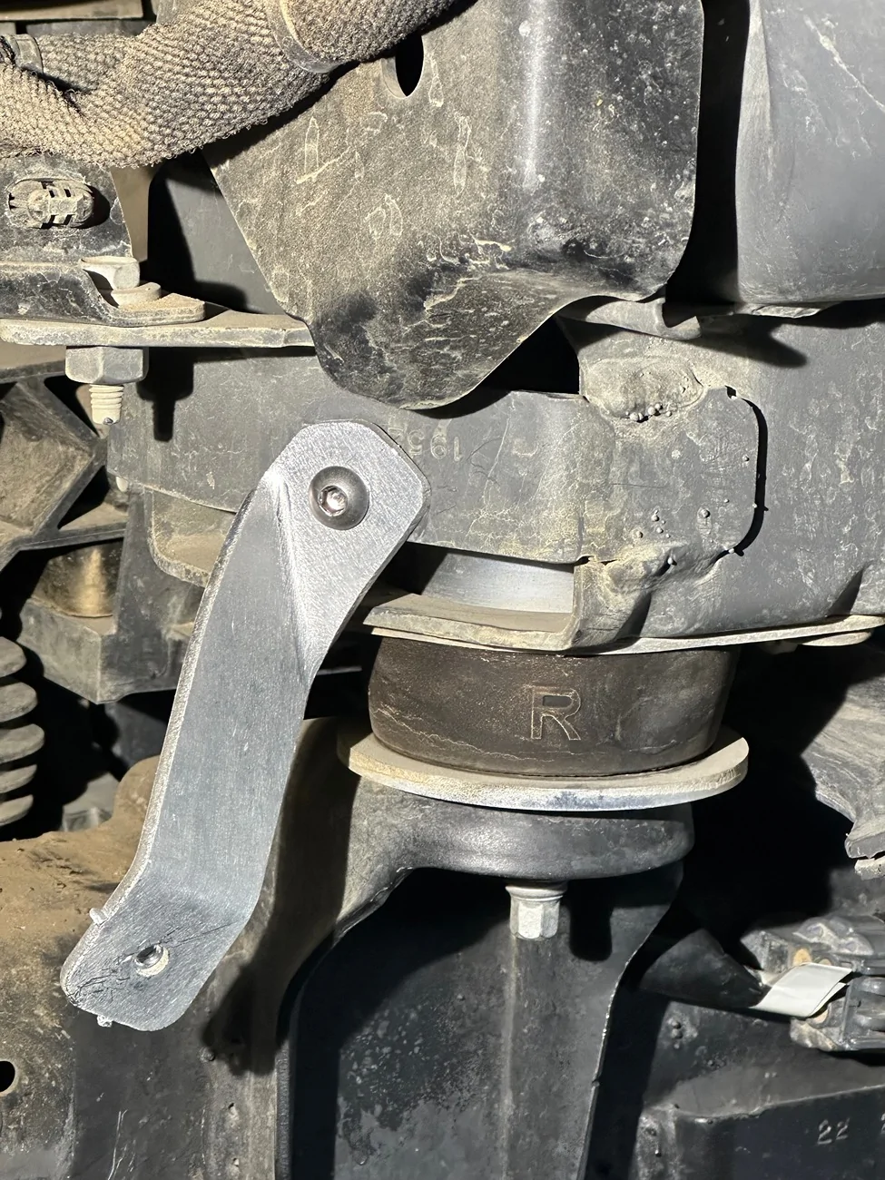

Not relevant to you anymore but Motobilt moved their bracket from the frame frail to the bulkhead and increased its thickness to deal with the twisting and breaking. Also curious about your wheel offset if you’re having that much contact with your fender liners,

May need to reach out to @Motobilt to see if they offer updates for free cause mine are on the frame and one broke and the other pulled thru the liner cause of vibration lol
That's great! Thanks for posting that update!
I actually just switched my wheels so I took some measurements. I had stock Rubicon wheels that measured 6", and I had 1.5" wheel spacers to help provide some clearance on my RK pro lower control arms, so 4.5" BS on a 37x12.50 tire

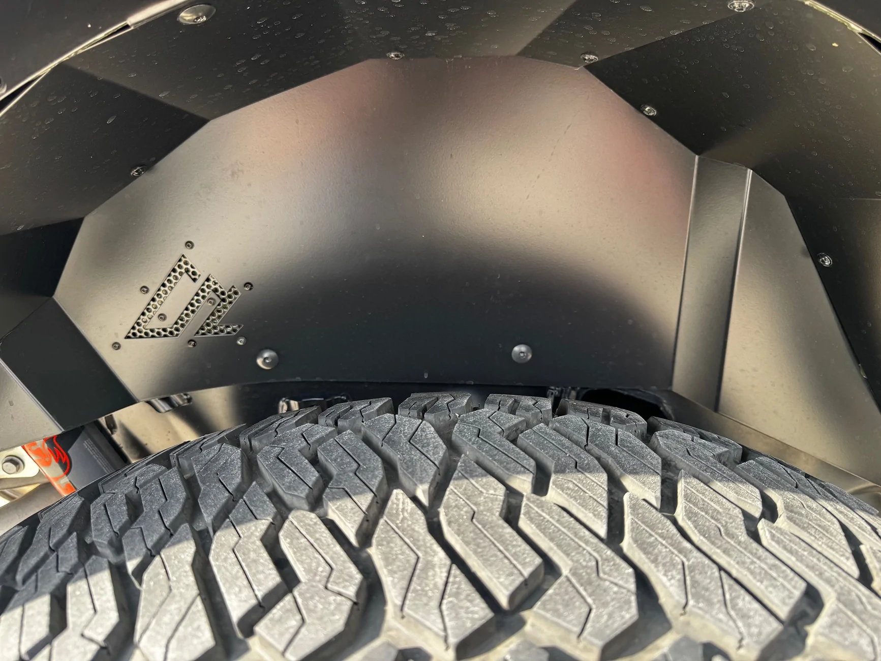

I run the AAL inners with zero issues, had it on my jlurd as well too. All due to the dzus quick release fasteners for easy maintenance/removal.
I also have AAL American Adventure Lab, they been awesome and it's great to be able to remove them so quickly if need be.
