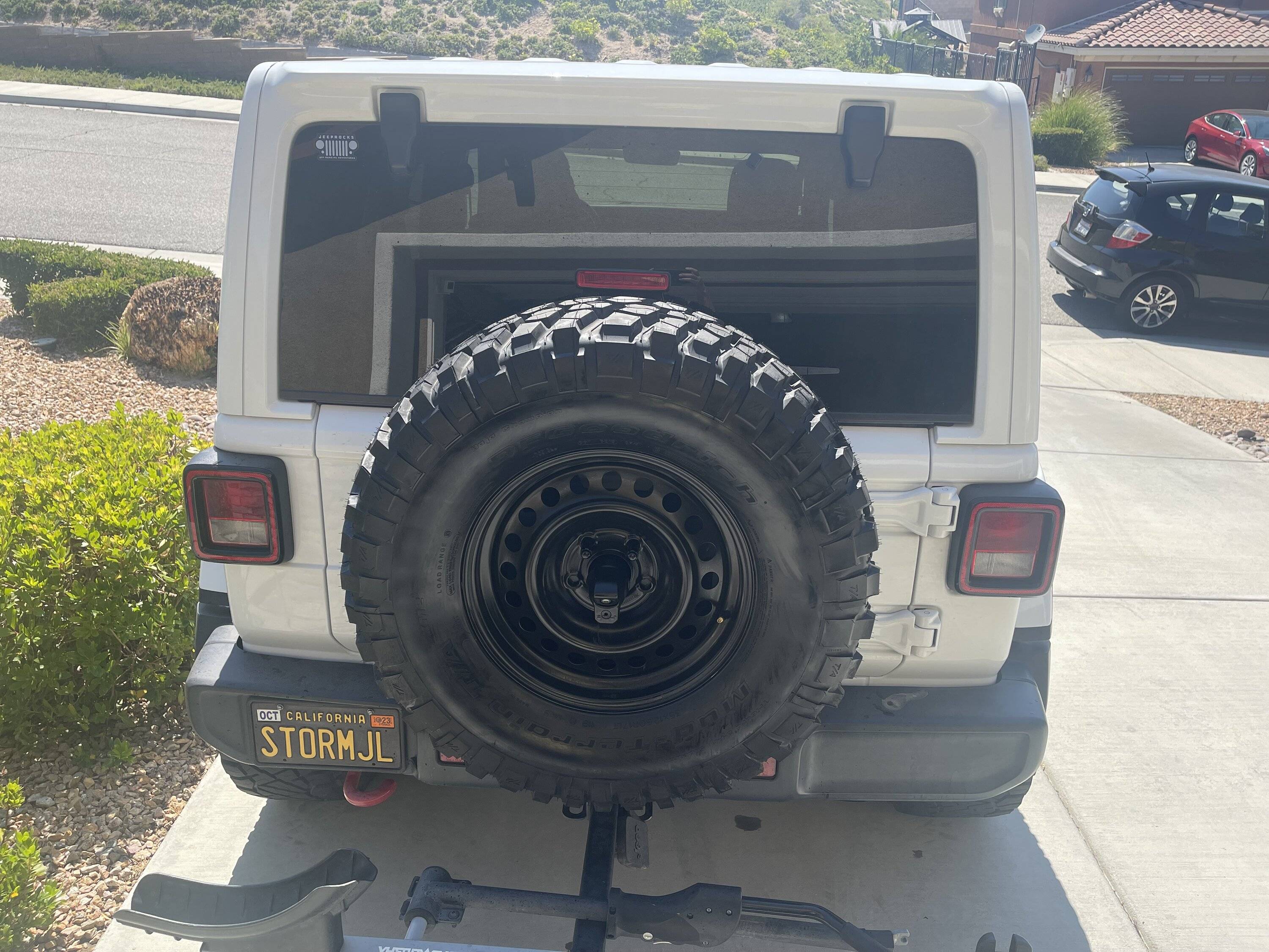

2022. 4 door JLUR with 35x12.5”-17. I just changed tire/wheels from stock yesterday. Spare just sits fine on back with zero adjustments. Didn’t touch or change a thing. Steel OEM bumpers with Jeep reinforcement hinge.

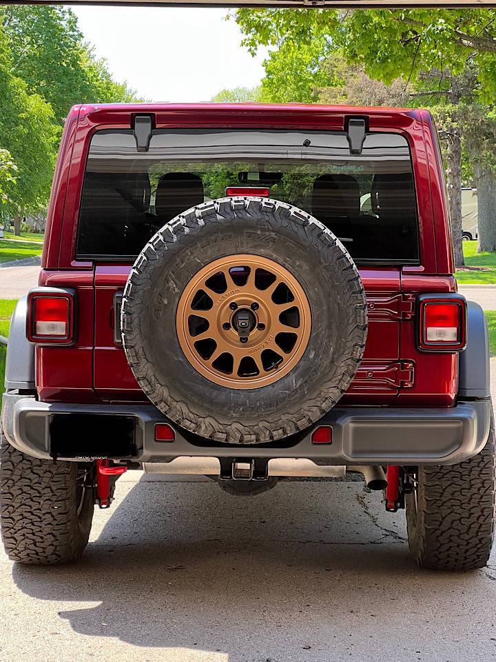

315/70R17 BFG KO2s just barely fit with the steel bumper and Rubicon carrier. BFGs run small. Any larger and I'd need to address it. There's a tiny bit of rubbing on the plastic center piece on the bumper. I think I'll be fine after the first rotation and some tire wear.
My AEV Borah wheel may have some impact with the +25 offset and a wheel with more offset might not rub at all.
