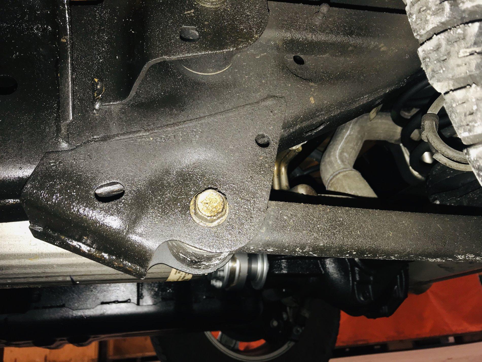

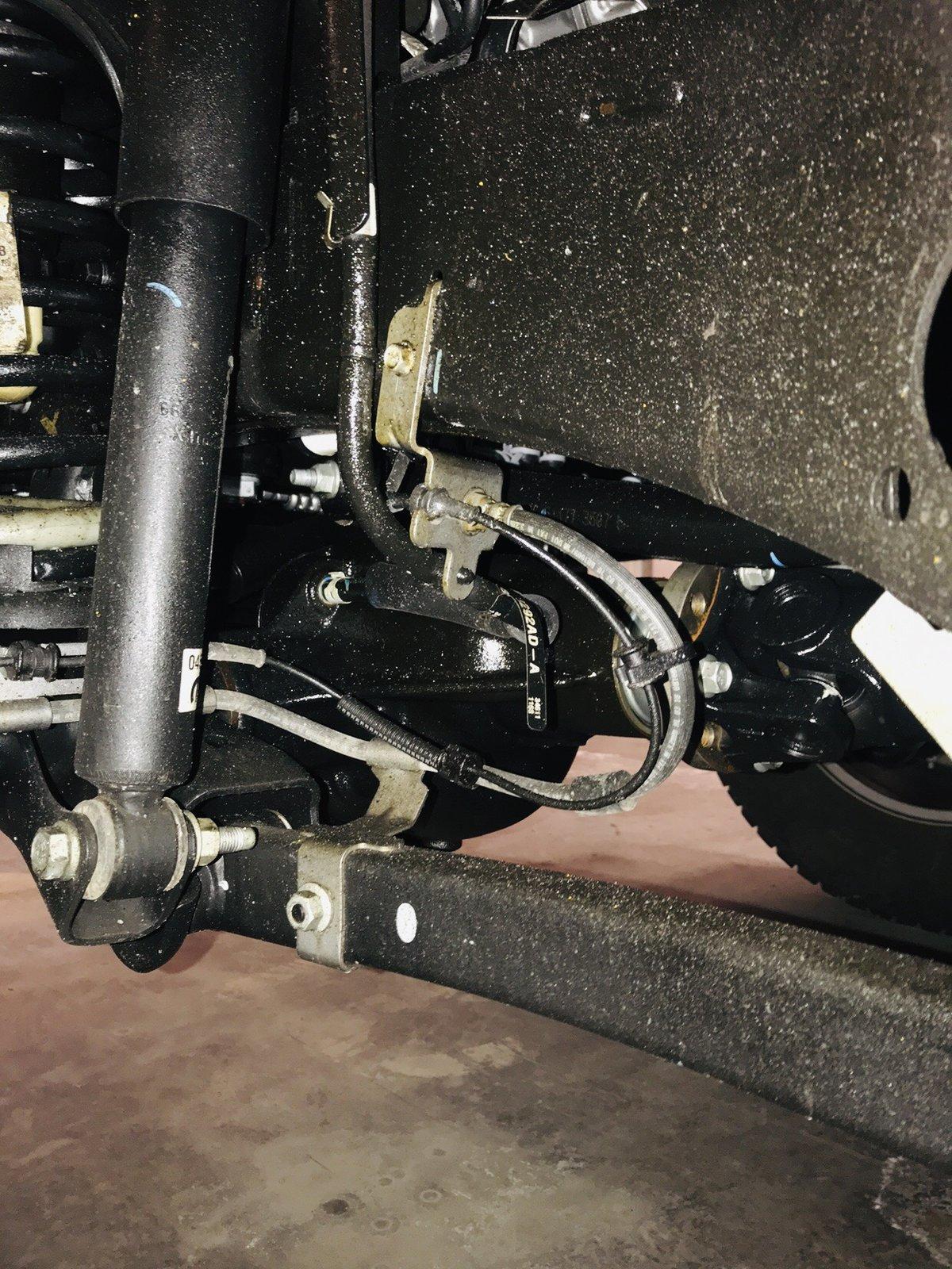

Fluid filmed back on October using a spray gun. After months in salt looks like itā€™s doing itā€™s job! When spring comes Iā€™m going to wipe the grime off the chassis, then come fall spray fresh Fluid Film on again. I couldnā€™t be more pleased with the stuff.

I had Fluid Film applied late last summer. I should have waited a couple of months longer, but got a deal. I agree with the previous posters, it does reek of barnyard! Especially in closed garage. Took about 3 weeks to fade. I read good things about this product - outside of the auto industry, it's used for construction equipment and marine equipment. I've been driving in salt pretty much since December. I still wash the exterior, but avoid spraying the undercarriage. I plan to crawl under the Jeep the next warm day to see how the film is holding up. I do plan on a yearly application.

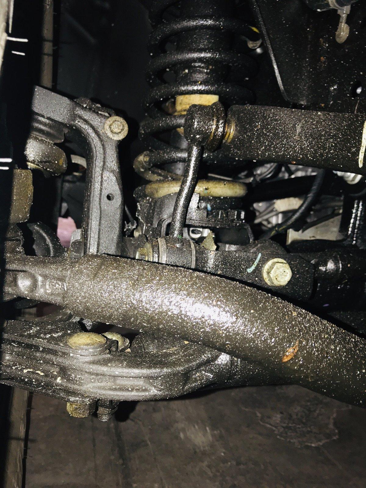

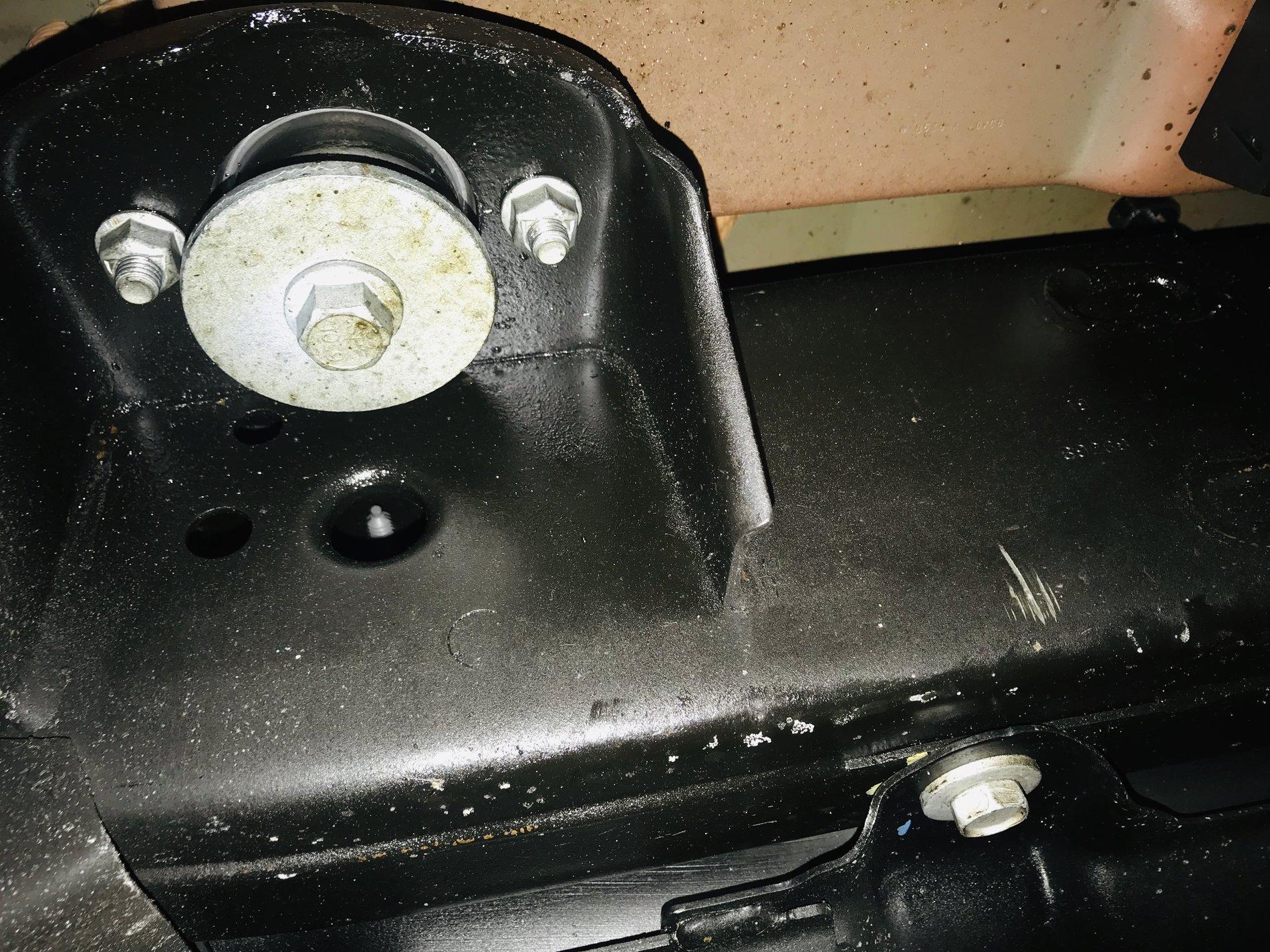

Thanks for the pictures!
