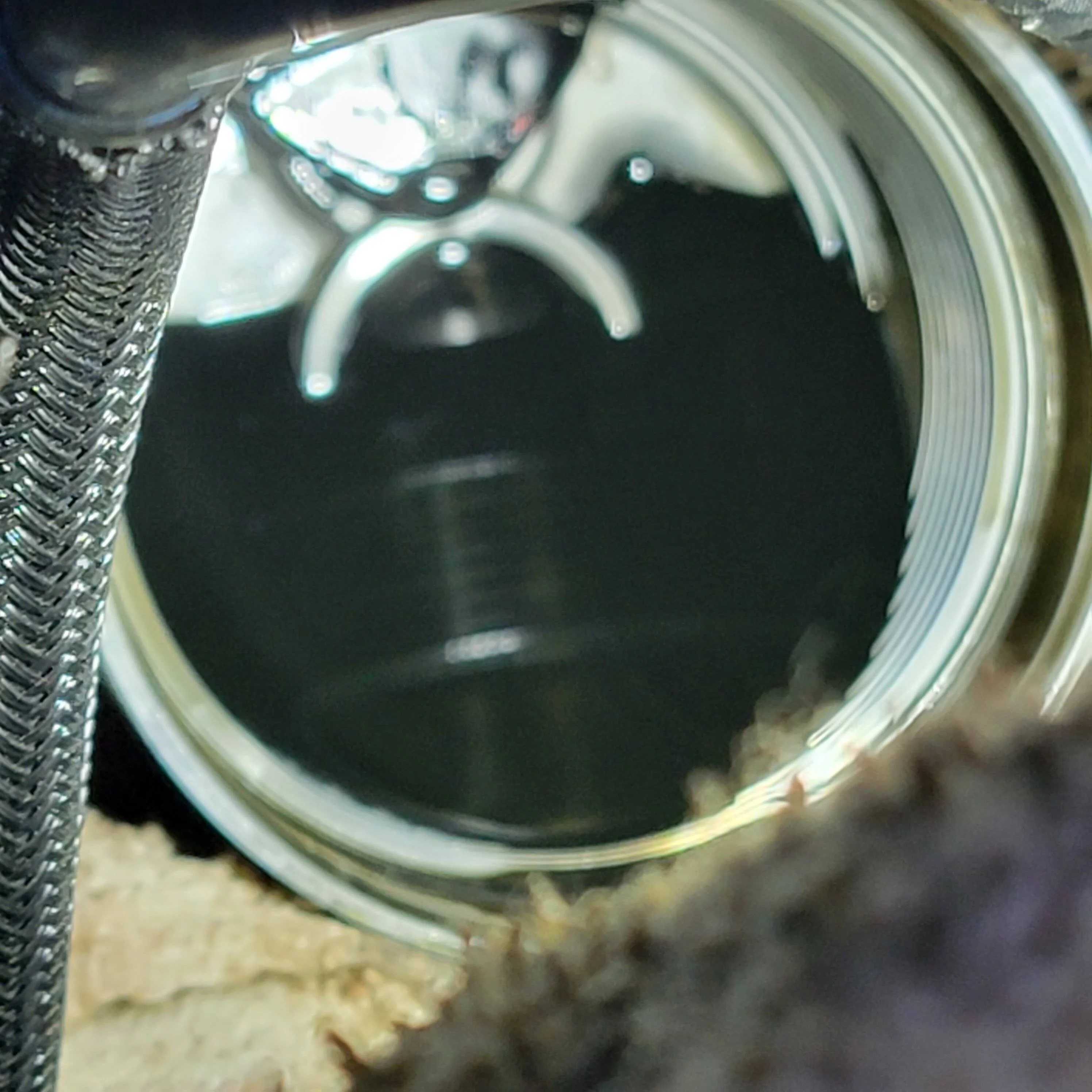

For reference, this is how much oil that was left in the oil filter housing when I recently changed my oil.

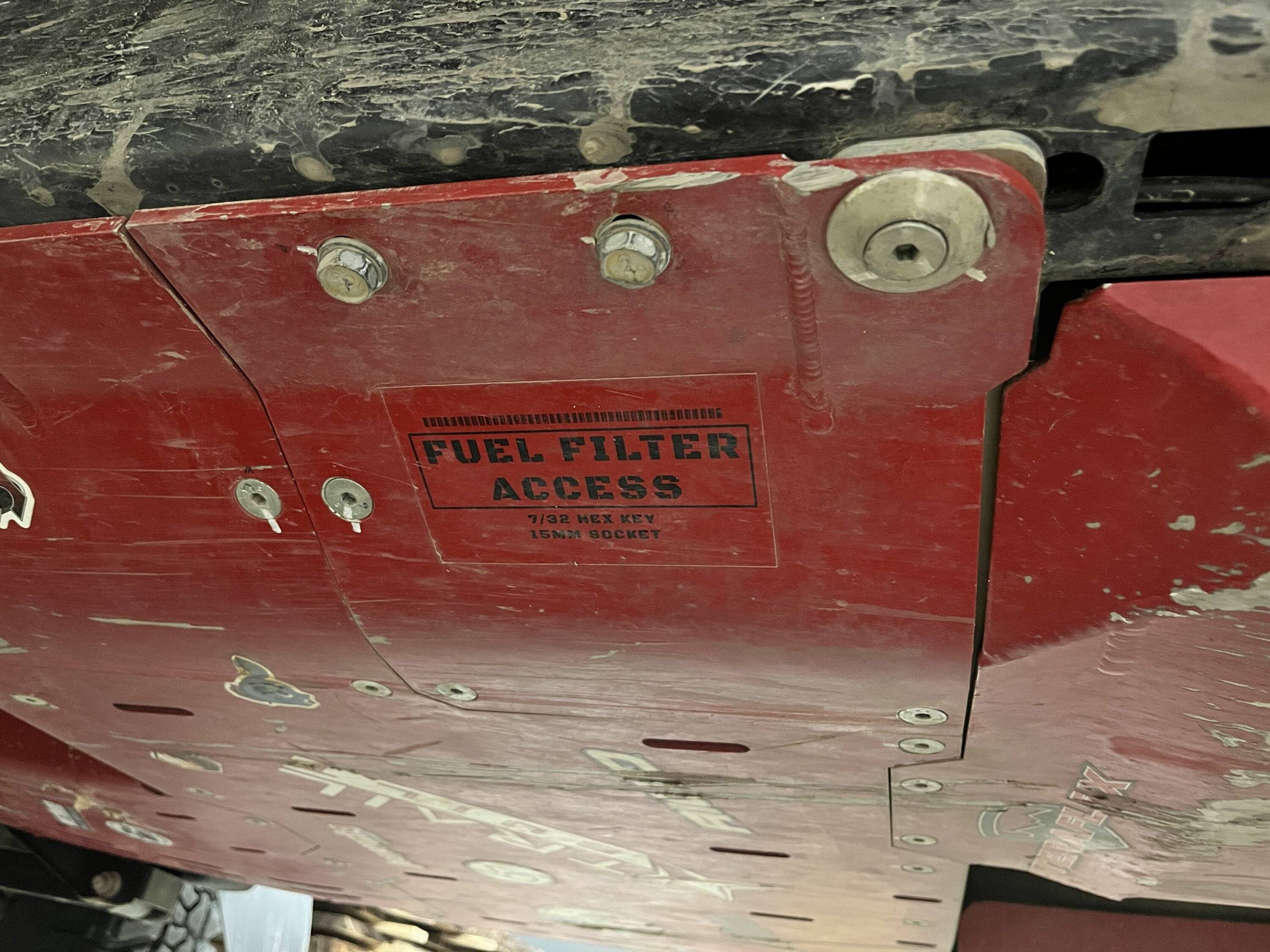

I sort of used the same process @grimmjeeper described but instead of doing a tire rotation I replaced the fuel filter.
1) Start draining oil with Fumoto valve through attached hose​
2) Unscrew oil filter​
3) Get a snack​
4) Remove access hatch over fuel filter (Artec Belly pan...)​
5) Remove oil drain hose, cap off fumoto valve​
6) Drain fuel from draincock into catch pan using Fumoto hose attachment. Rinses the oil out and prevents diesel from splashing everywhere.​
7) Replace fuel filter, close up hatch​
8) Replace oil filter​
9) Fill with 9 quarts ($100 worth) of unicorn juice​
Side note: Posted elsewhere, the manual supplement provided along with the HPFP recall now has a fuel filter replacement interval of every oil change instead of every other.
