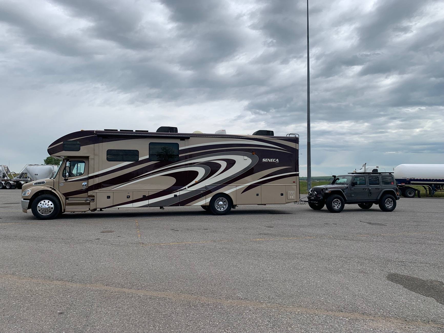

I’ve towed cargo and travel trailers for decades but today was my first ever flat towing experience.
Towed the Jeep in Cranbrook BC today and it was still attached when I arrived.

I just used magnetic trailer lights on the rear bumper. I didn’t want to tap into the Jeeps wiring for the lights.

That's what I use. Nice Seneca. I have an XT version.
My wife and I love to flat tow our Jeep to wherever, and then go Jeep wandering, with the dogs, after we've arrived.

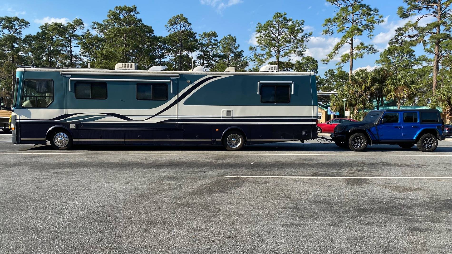

It's a bias based in reality! Put the transfer case in neutral. Leave the transmission in park. Jeeps have no steering wheel lock. All of this means that you don't have to leave a key in the ignition! No stopping every X hours/XXX miles to run the engine, and shift the transmission through the gears like most other towables. Jeeps are almost as simple to tow as a trailer. Easy-peasy!
When it comes to using the Jeep, they are great for being out in nature and exploring where most vehicles can't go. They are just as capable in crowded tourist areas where parking is at a premium. They are relatively small (especially 2-doors), and the wheels are out at the corners which makes parking them easier. Run the soft top, and you have a convertible!

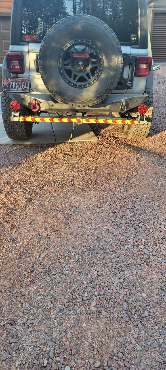

Jeep Wrangler JL First ever flat towing experience. towed lights
My Rube Goldberg Mark 1, mod 1.
At may garage/"work pad" on my 1/2 mile gravel driveway.
$20 scrap steel 2x3 tube. $12 hitch, $20 welding to hitch, $30 HF towed lights with magnet (seriously strong magnet btw). Leftover reflective tape. Leftover spray paint. Sort of impressed i put tape on correct to get folks to pass left.. 2 days at my leisure.
$80vs 1,000.
Wired a separate 4 wire line from rear to front of jeep and located 6pin on etrailer towed base plate for hookup to RV. Nothing hooks into jeep except brake controller power, and I'm using a NOCO waterproof 5a 110v charger, hooked to an inverter in RV trunk, using 12v.
Yes I know wire not hooked up yet, oddly will not fit oem trailer plug on jeep, HF plugs nop problem. OK, add $12 for 4 hose clamps to make sure the mag lights dont walk away.

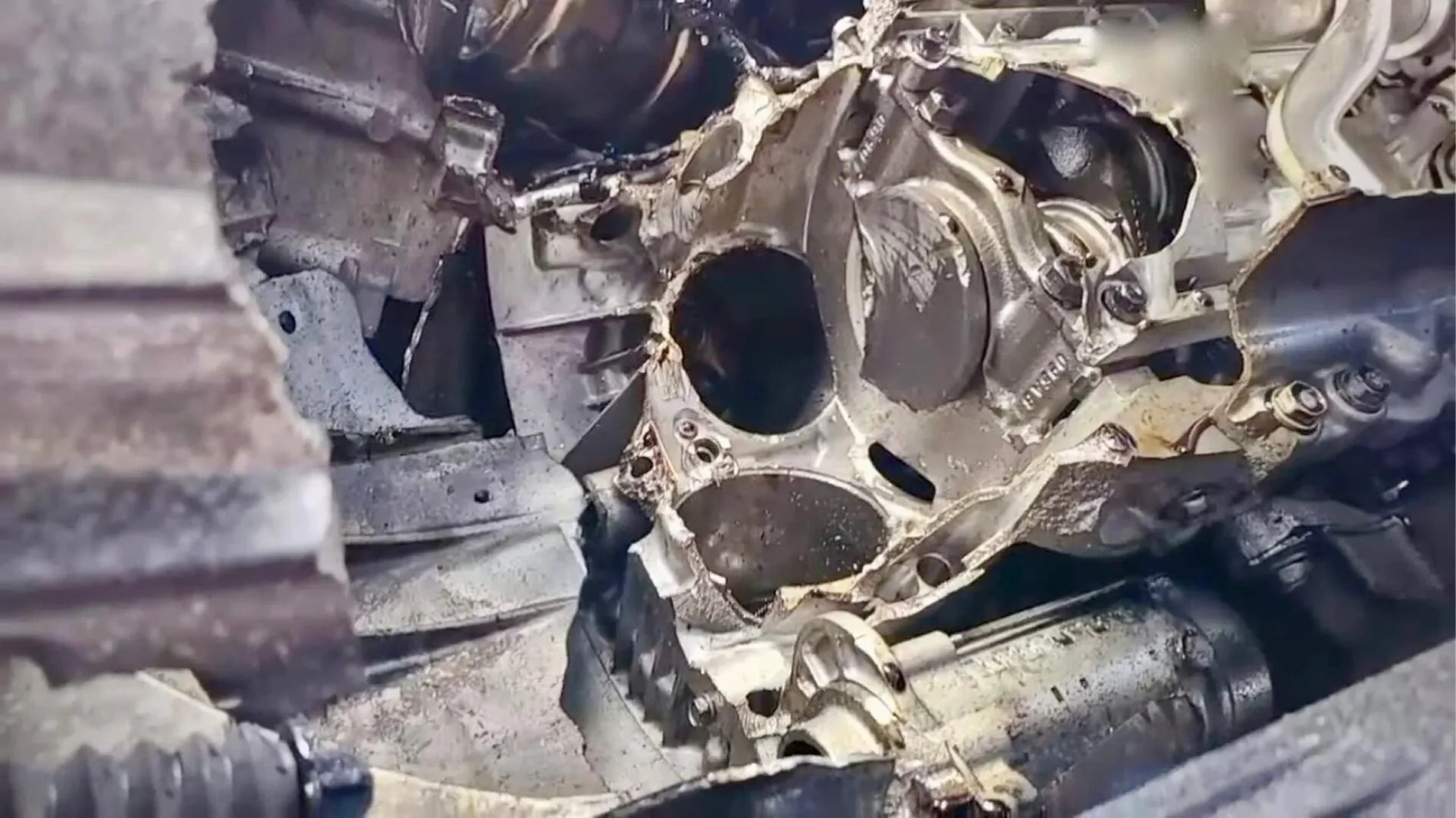

I guess the mileage on the rv took a dump pulling 4 low? In reality, it was probably a mess of parts within a minute of being towed.
