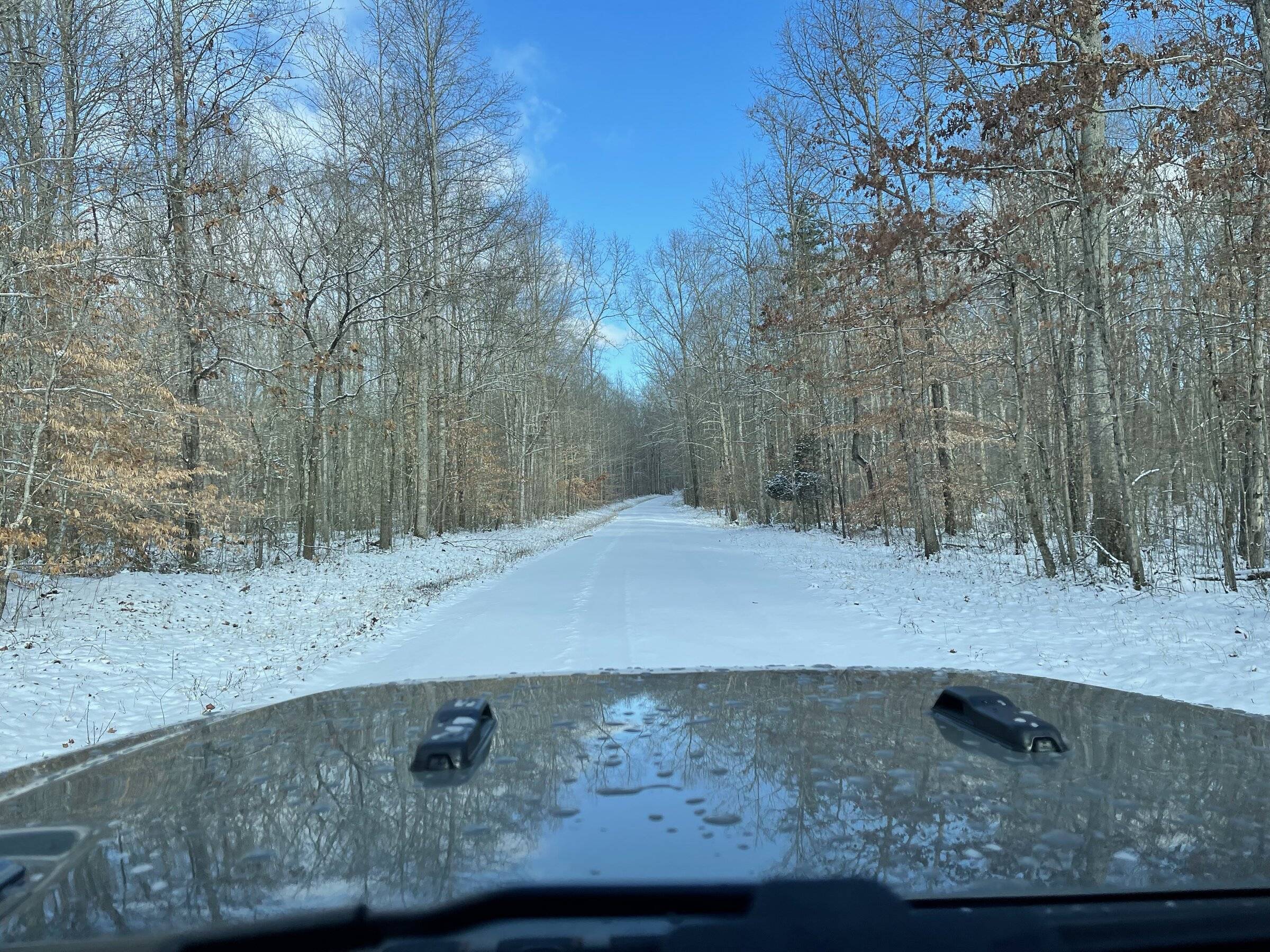

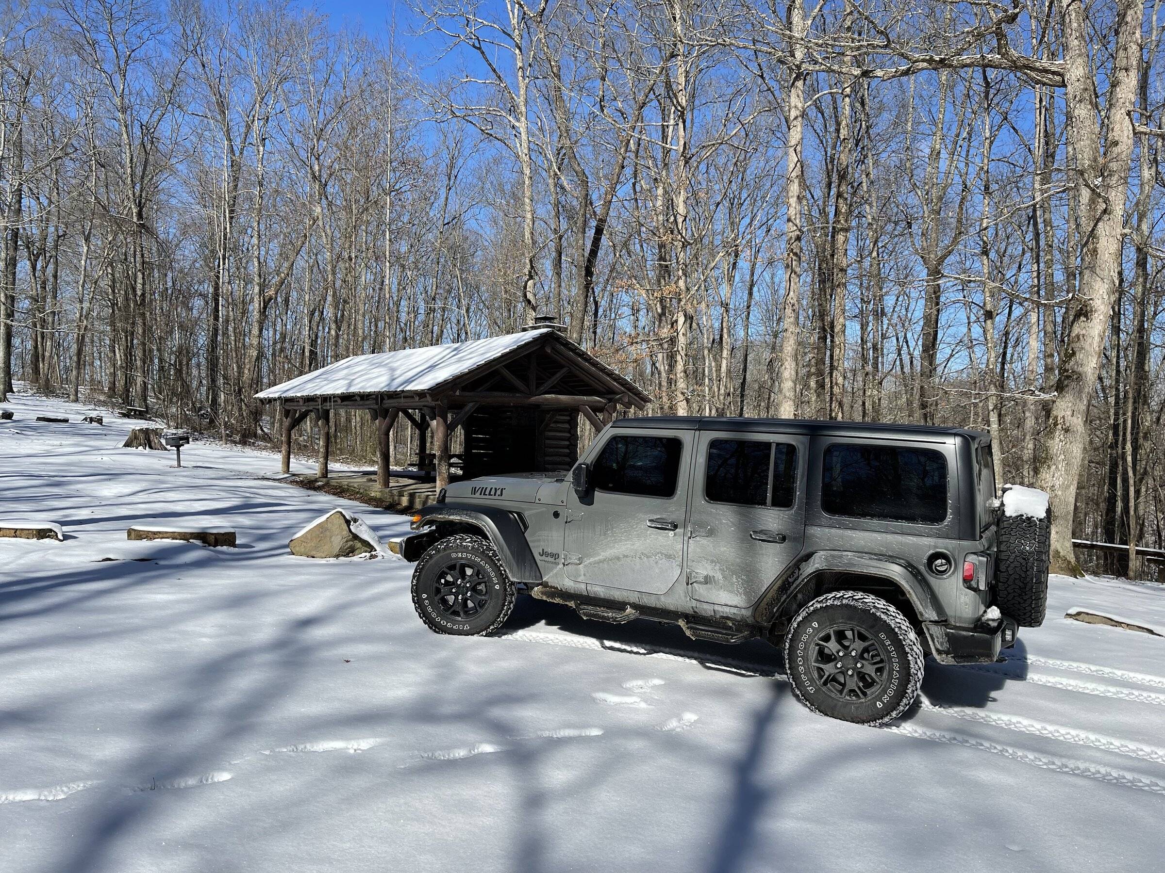

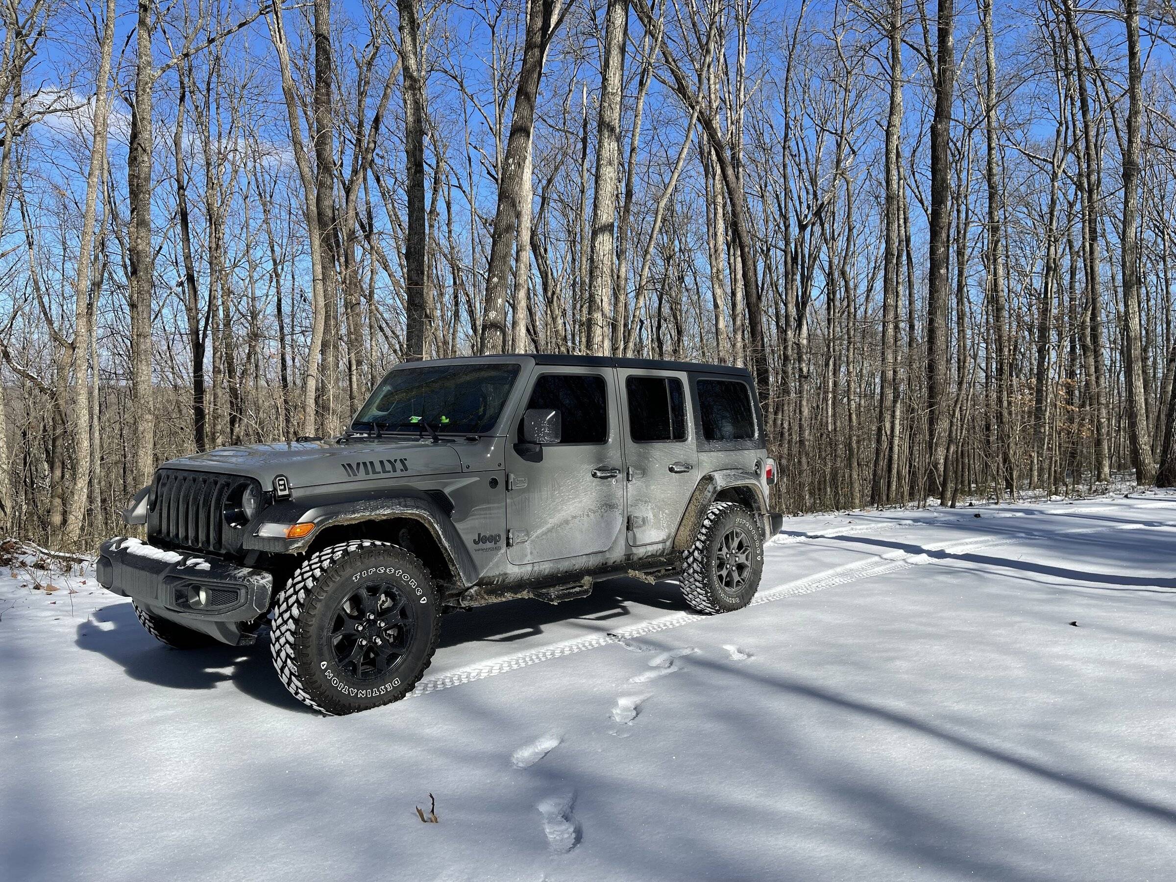

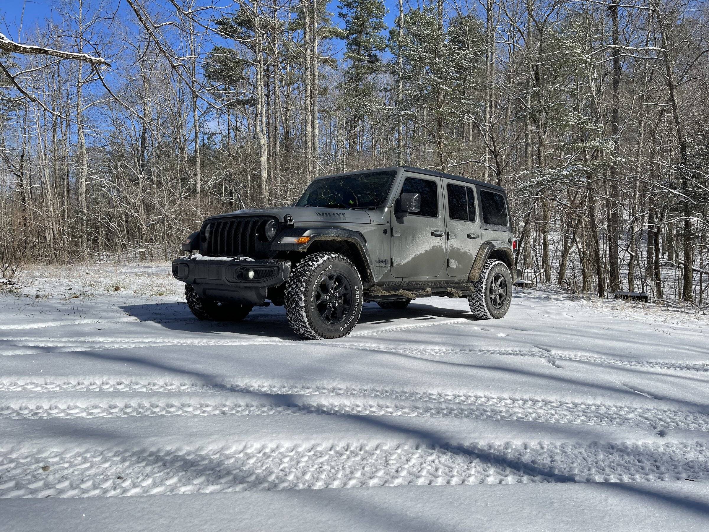

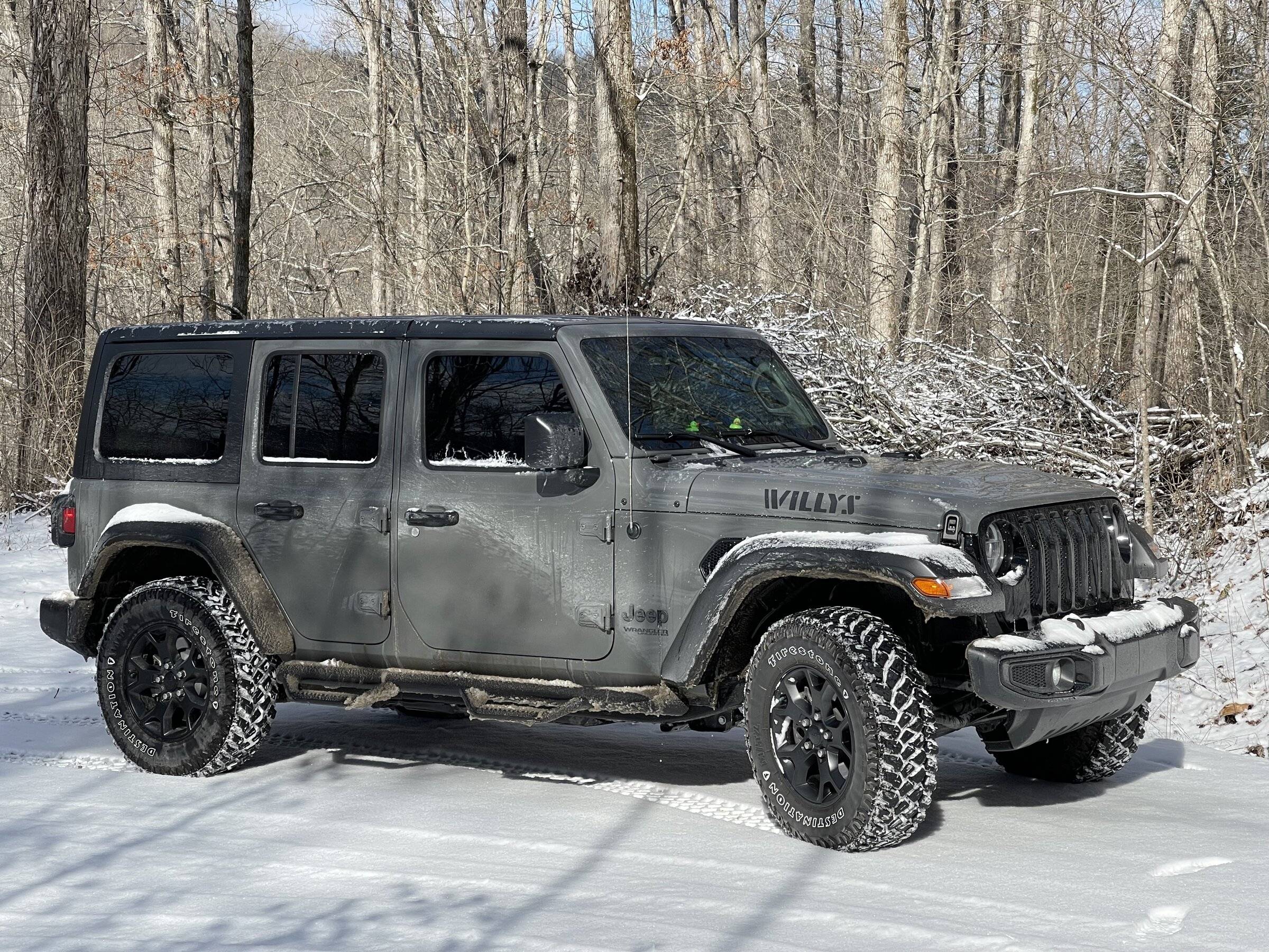

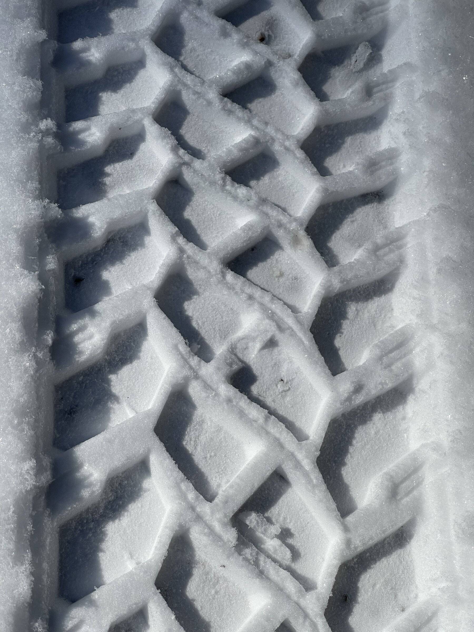

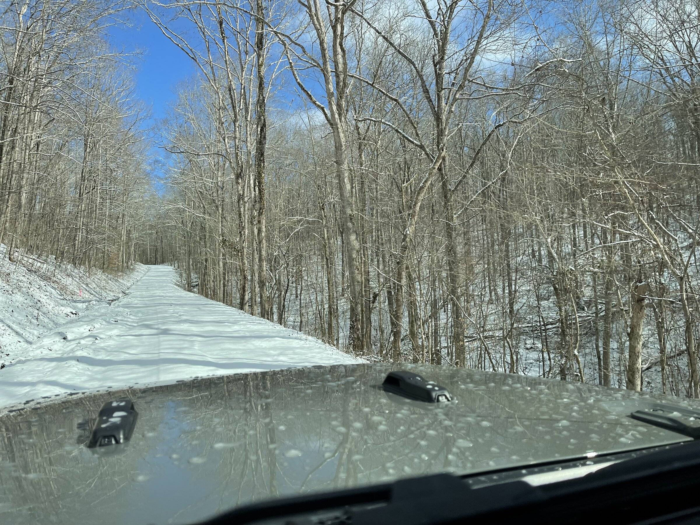

The KO2’s will always do better in the snow than any mud tire due to the amount of siping. With that being said.....my Destination MT2’s did well this past winter on fresh, untraveled winter snow on some government land in the Daniel Boone National Forest near home.

Get them siped and they will be good. We've siped MTR's (original ones) and Mickey Thompson Baja MT's with excellent results. The MTR's were horrible as they didn't have any siping and Mickey Thompsons were ok as they had some siping. After siping both sets, they performed very well, good enough as to not need AT's while driving in snow in the mountain roads.
In fact, they act like a very good hybrid AT/MT. The large void and big lugs are great for going through deep snow while all of the siping does well with grip on snowy/slippery hard surfaces.
