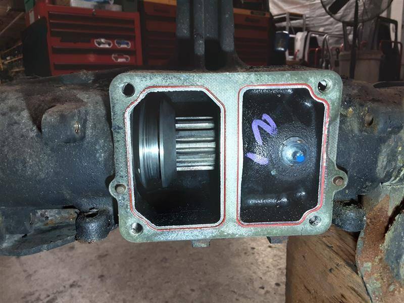

Here are two things.
one is the axle housing with big open for FAD function. People concern this weak point no matter you have or not have the FAD motor. My pic shows it is just covered by a four bolt plate from Jeep line.
Second, for a rubicon, 3.6 etorque with full time 4WD option, does anyone else see FAD motor is replaced by a plate? Will this plate be put on in the future even for other trims with auto 4WD, or just a mistake made by Jeep? Is single piece axle put there or two piece axles locked somehow?

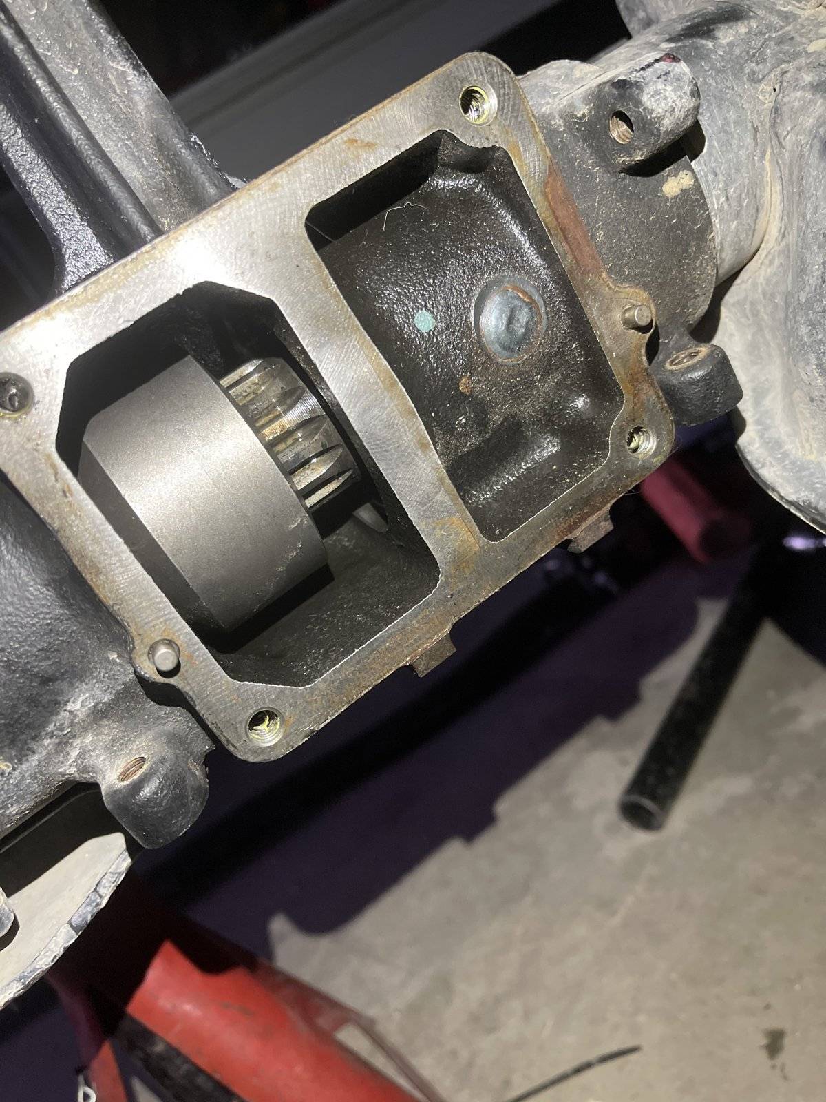

I would be very surprised given that Dana is supplying the shafts that it is a one piece. I have not seen one on the market.
My guess is if you pull the plate you will see this:

Instead of this:
Jeep Wrangler JL FAD gone on 2023 Rubicon? s-l1600

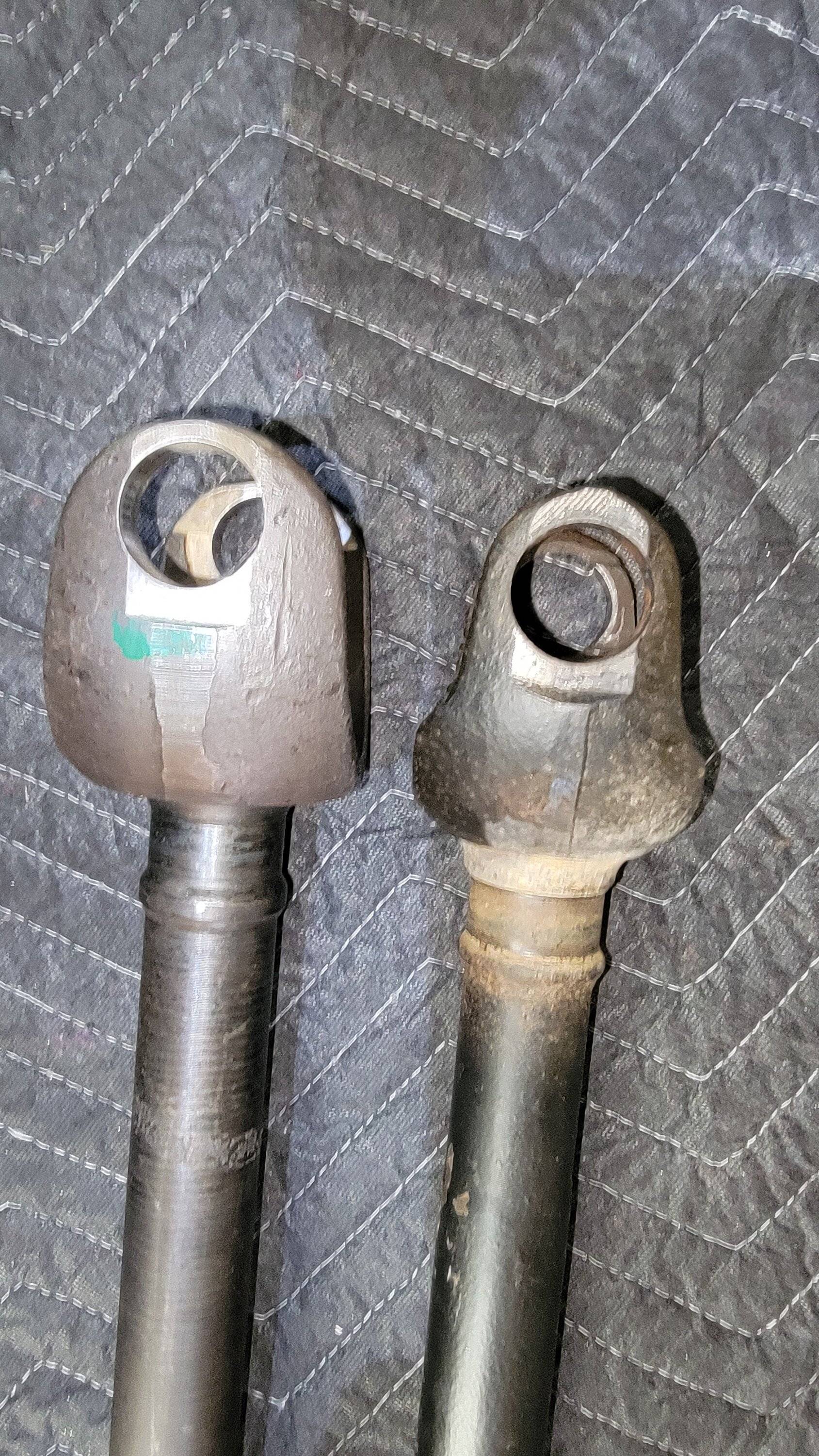

They may also be chrome moly, but less certain about that. The yokes may provide a clue.
CrMo on the left and OEM on the right:
