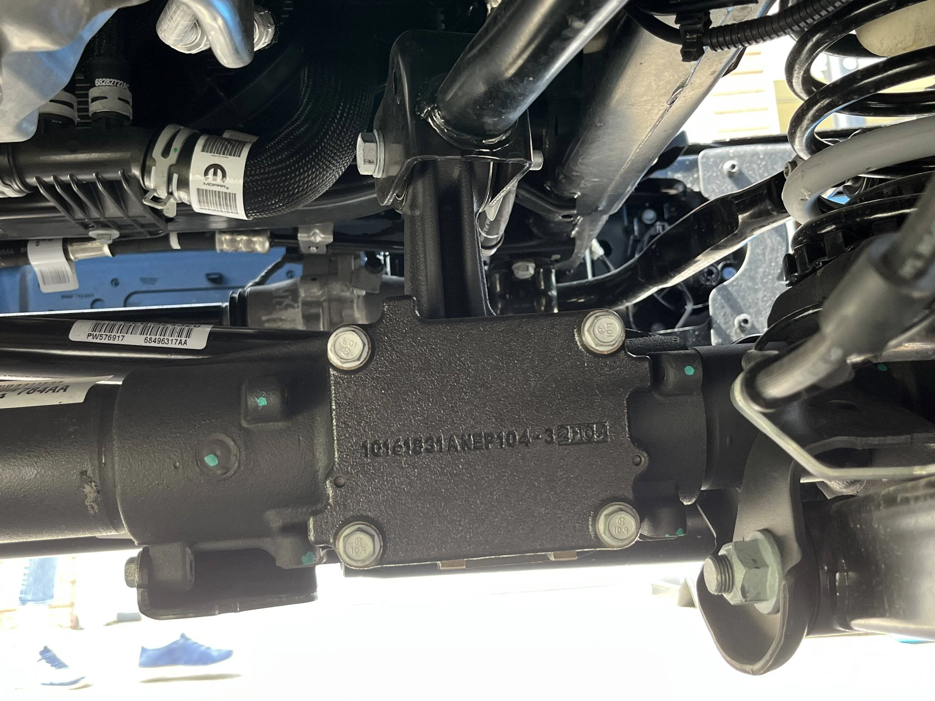

FAD gone on 2023 Rubicon?

I wonder if it is indeed a one-piece shaft or is it the FAD delete kit that has a very heavy-duty collar connecting both shafts.

I have auto 4wd and a FAD.
The FAD is removed with the 4AUTO option where you do not have a 2H option.
You likely have a 2H option.
The answer should be clarified like this.
I was under the impression only 392s are like that. This person has the 3.6, 4 auto and no FAD. I have a 2.0, 4 auto and a FAD.
