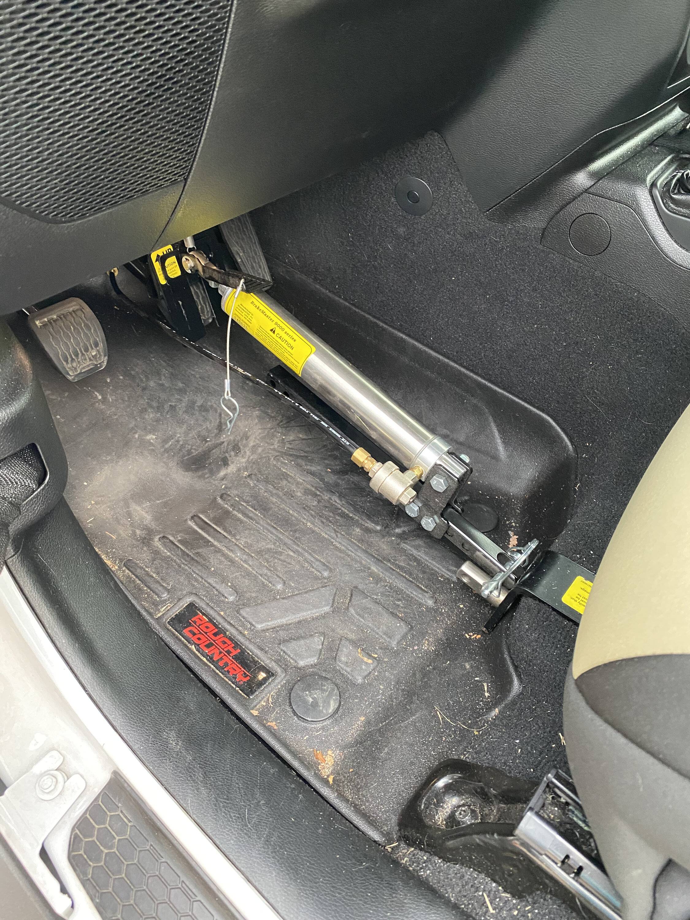

Great! Do you have an aux braking system that moves the Jeep's brake pedal?
Yes, I have Roadmasters Brakemaster's unit which is plumbed to my air source in RV.
