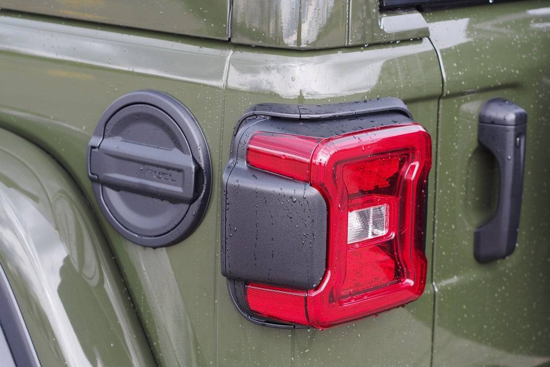

I have need for two additional tail light extensions but can’t find the part number anywhere. Any help would be appreciated.
Here is a picture with the extensions.
what's it for ? what's the purpose ?
