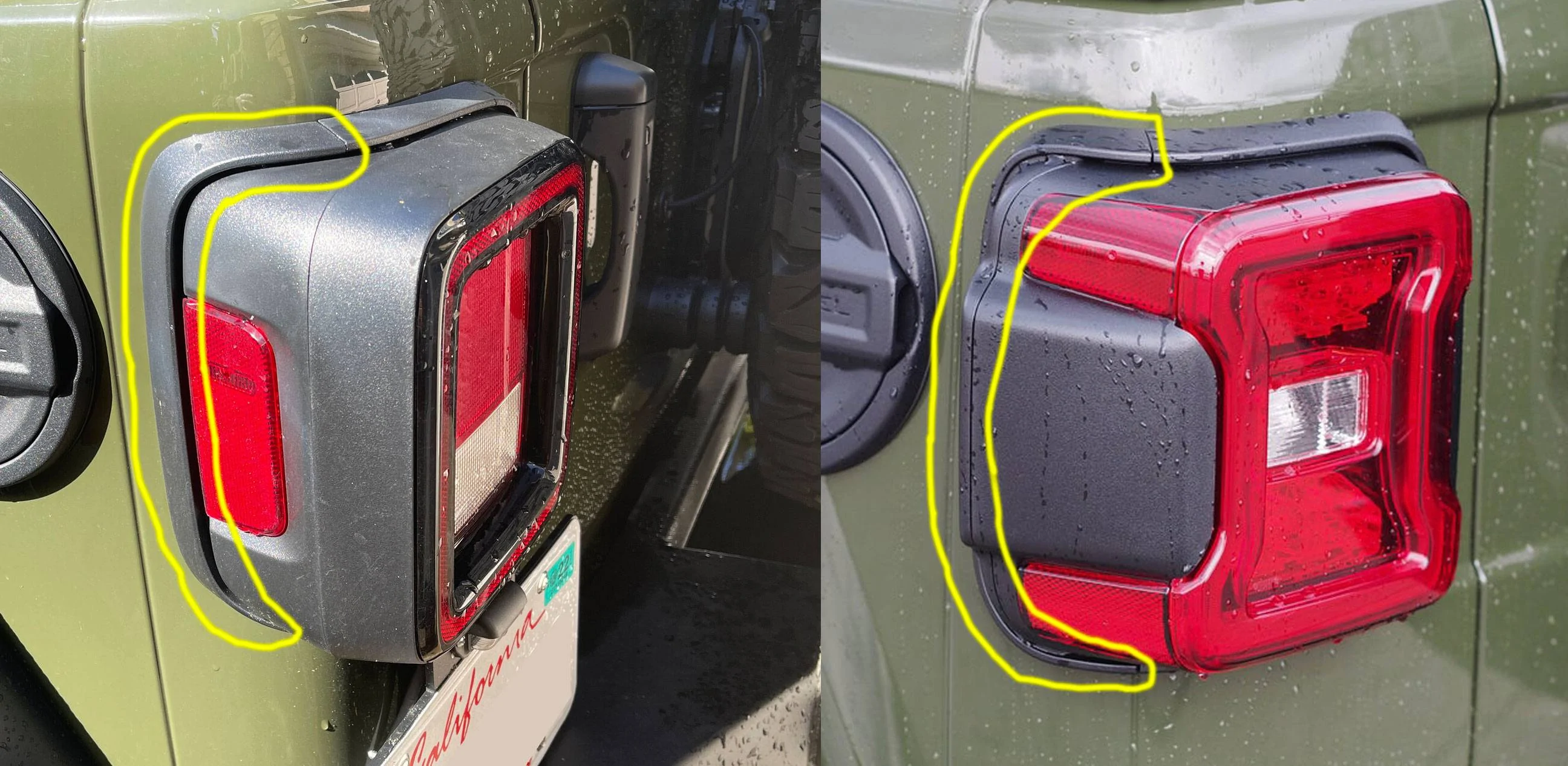

After some investigating and confirmation from someone with who owns XR non-LED lights, I believe that the non-LED extensions will NOT fit LED lights. Seems to be missing the XR LED closeout panel. Notice how different these two pieces are. So if you want LED extensions, you have to buy the whole expensive led tail lamp assembly.

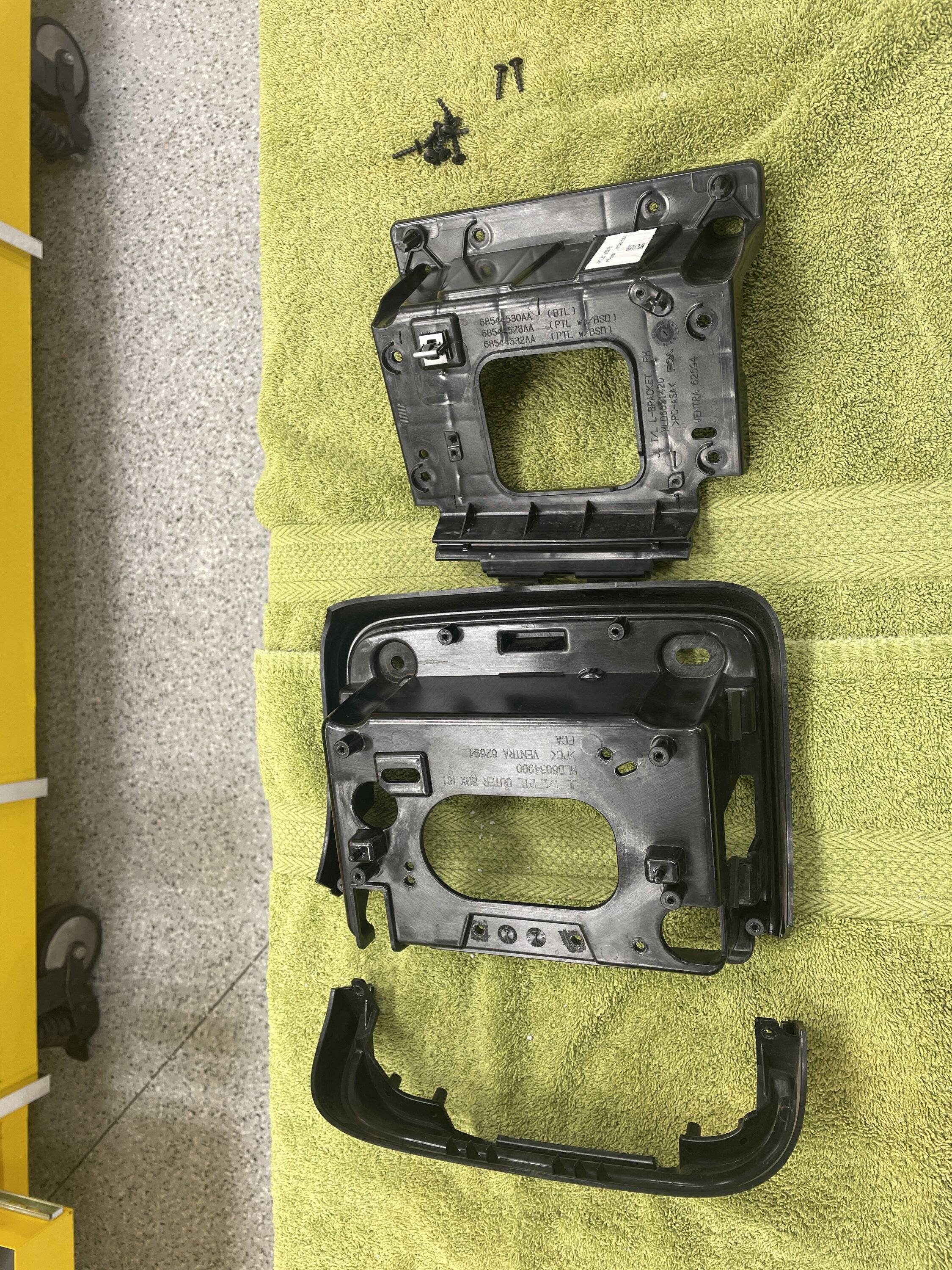

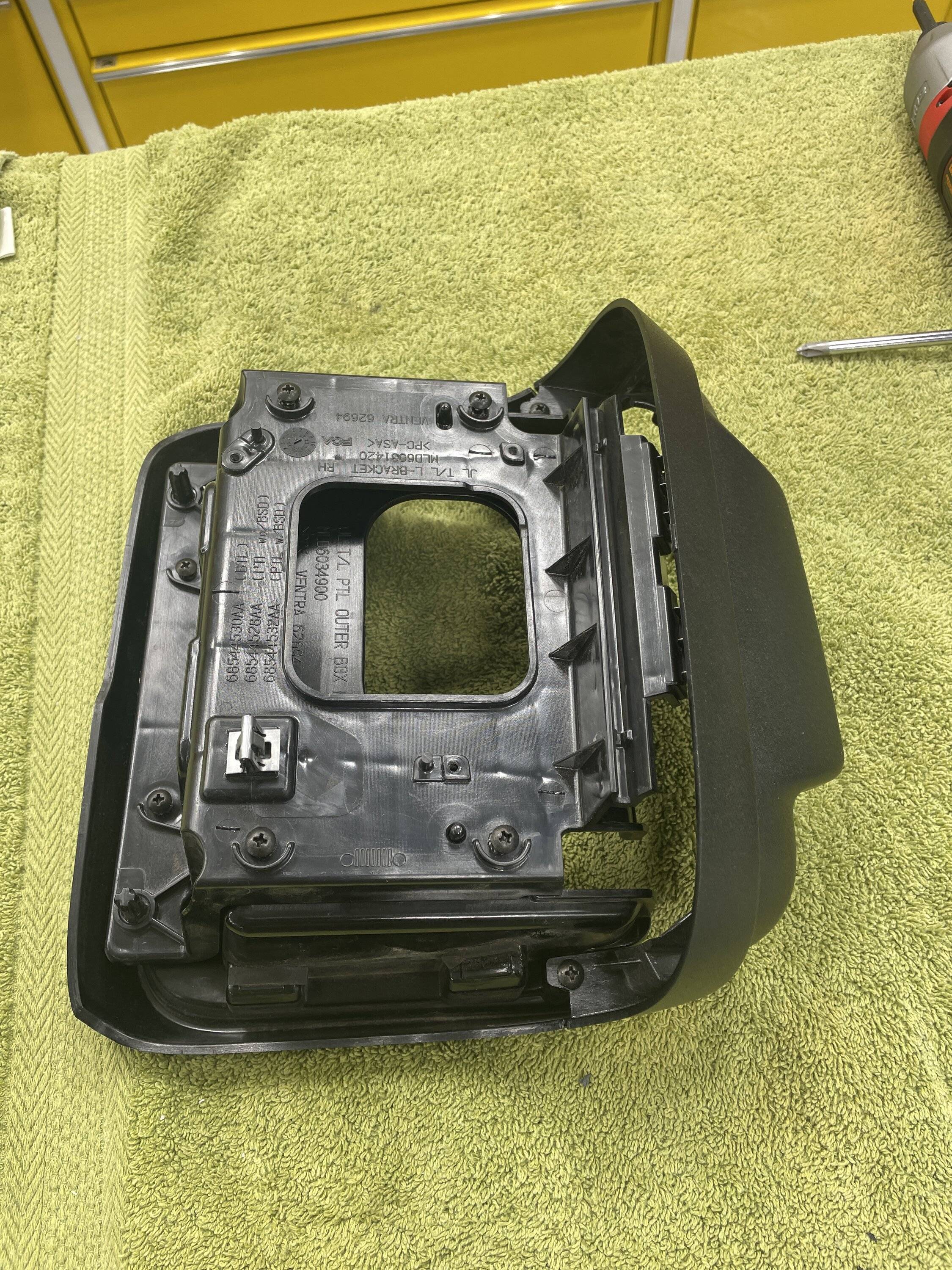

I thought that I’d have to get a set of stock non-XR taillights in order to replace my XR taillights. That’s not true. The extensions are actually three separate parts. You can remove them from an XR taillight, however you will need the non-XR side filler pieces. The parts were $23 shipped to me to buy new parts. Or swap with somebody wanting to add the XR extensions to a non-XR taillight.
Parts needed to remove the XR extensions are 68376509AA and 68376510AA.
I don’t know what the part numbers are for the XR extensions unfortunately.
