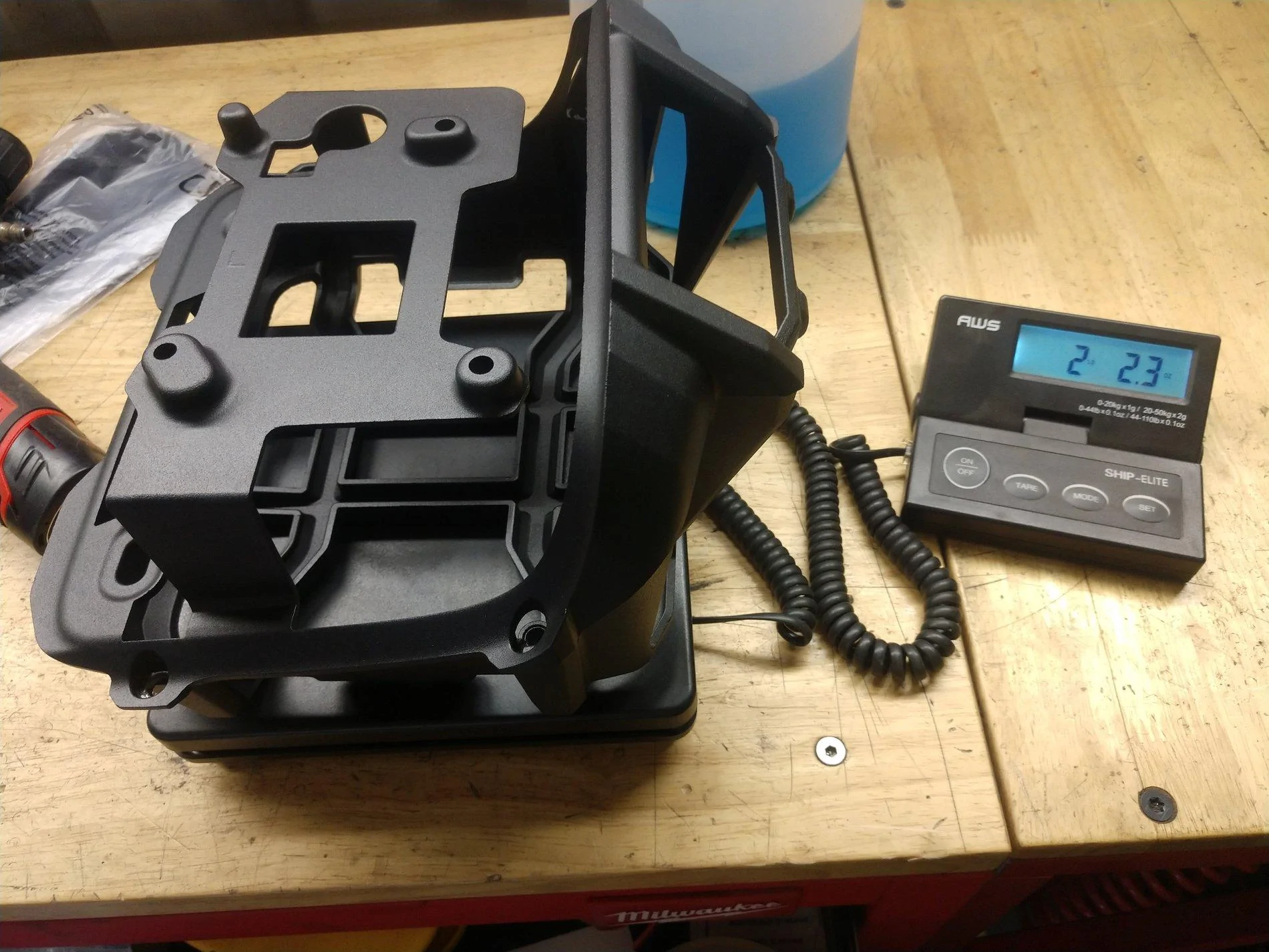

So I just installed the Rugged Ridge model on my '19. I got 'em on the recent sale from Northridge, although it wasn't much of a discount - I think I paid about $120
Given the cost of the LED light assys I figured a little protection at ~$60 per lamp ain't bad.
I really wanted to build something but when I learned these are Al I figured they were worth the expense. Each guard weighs in at 2.2 lbs but I'd say for what they are (and more importantly how they anchor) they provide plenty of protection

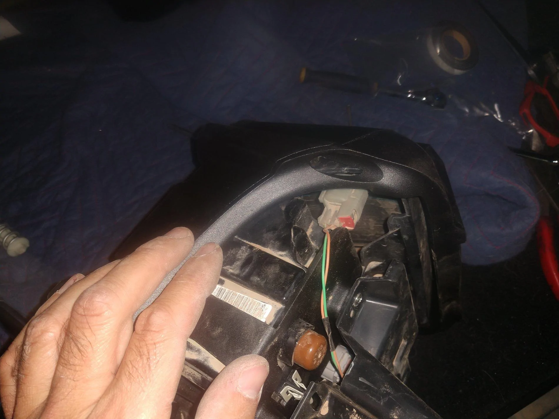

I'm not completely thrilled with how the upper electrical plug (come to think of it I don't know what this does as I don't have BSM - thankfully) wires ride over their mounting bracket. It's a little snug and *could* chafe over time, but truthfully will likely be just fine for my entire life. Still, adjusting the cut file to angle this corner would be a simple revision
edit, with coffee now consumed: that's 2lbs, 2oz! Not 2.2#

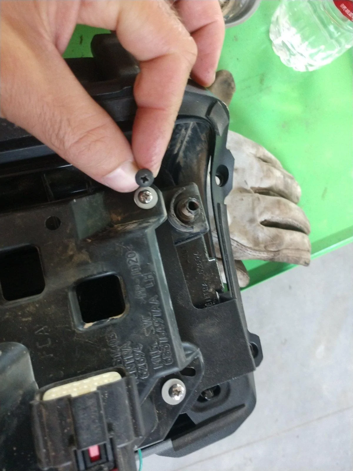

Their mounting bracket screws into the light housing with three screws. Factory uses true plasti-screws but RR seems to have just included longer sheetmetal or wood screws. They seem to grab the plastic housing fine but the head of the factory screws is .307" (call it 5/16") and the new screws have a noticeably smaller .260" head dia (call it 1/4")
When I snugged 'em I really felt like that tiny head was going to bore its way through the plastic. The smallest washers I had on hand were for #8 and were technically a bit too large but still fit well enough to distribute the load under the head on the plastic
I thought I snapped a pic of this last night but it doesn't exist on my phone (shrug)

Ok here's a shot of the screws and washers I mentioned. I'm holding the factory screw (black) and while it probably doesn't look it in pics the factory head seems much larger in person

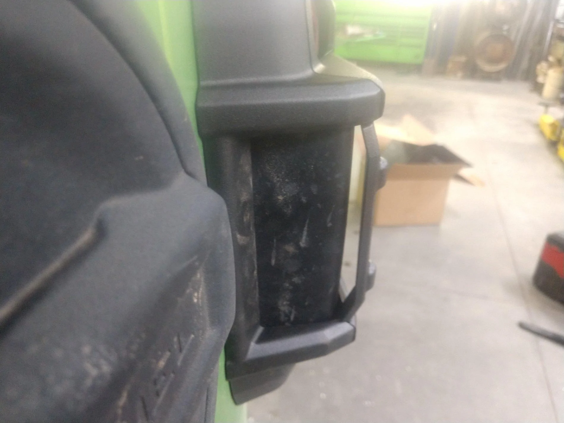

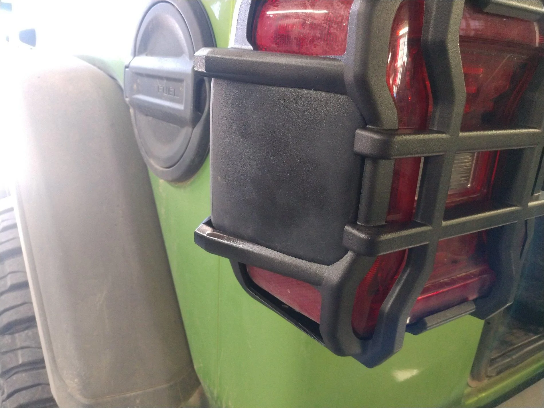

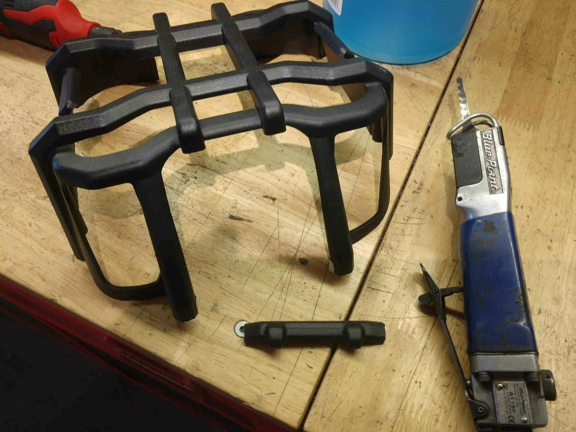

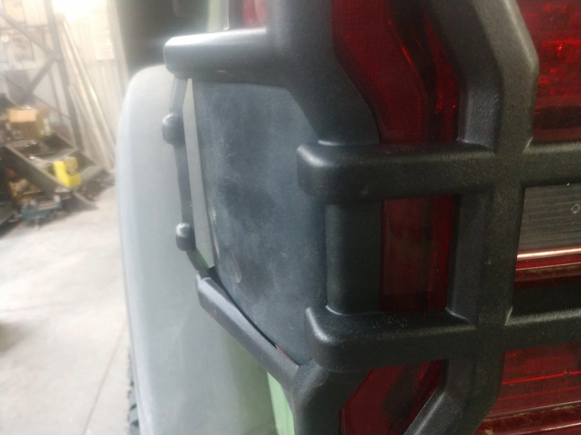

So my biggest problem was these bars on the side. They sit a good distance from the side of the lamp housing and looked to me like they were begging to rip the whole assembly off.
I mounted everything and convinced myself I'd try them for awhile, but each time I walked by it it literally made me stop in my tracks, frown and give a disapproving grunt.
So, out came the air body saw and I chopped 'em out. Kissed the cut with a sanding disc to blend it, and hit it with a rattle can. Now, personally, I think it is SOOOO much better
I understand it was maybe intended to protect the side of the plastic housing, but I felt that *at best* it created as many problems as it solved.

I saw that on mine too, but thought (no evidence to support the thought though) that they want the screw head to pull through the mounting plate as the weak point to minimize damage if you hook or hit something with the lights. Not saying that is their plan and wouldn’t be the first time I am wrong (just ask my wife).
