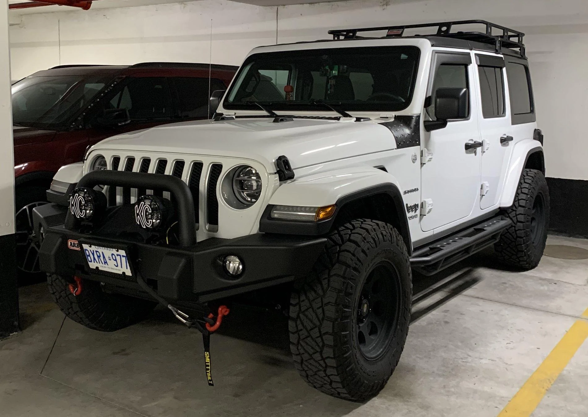

U wanna talk weight on front end? This is my sahara on 1.5 inch teraflex spacers with 34s lol.
i have winch, full bumper and lights. I sagged 1.5 inches but it rides cushy as hell now. Total front end weight 230lbs
Oh wow, great looking setup. So what you are saying i shouldn't be worried about a measly 160ish pounds.
This is probably how much lift you need in order to run that amount of weight in the front without sagging. You will probably need a 1 or 1.5 inch front spacer lift to level things out.

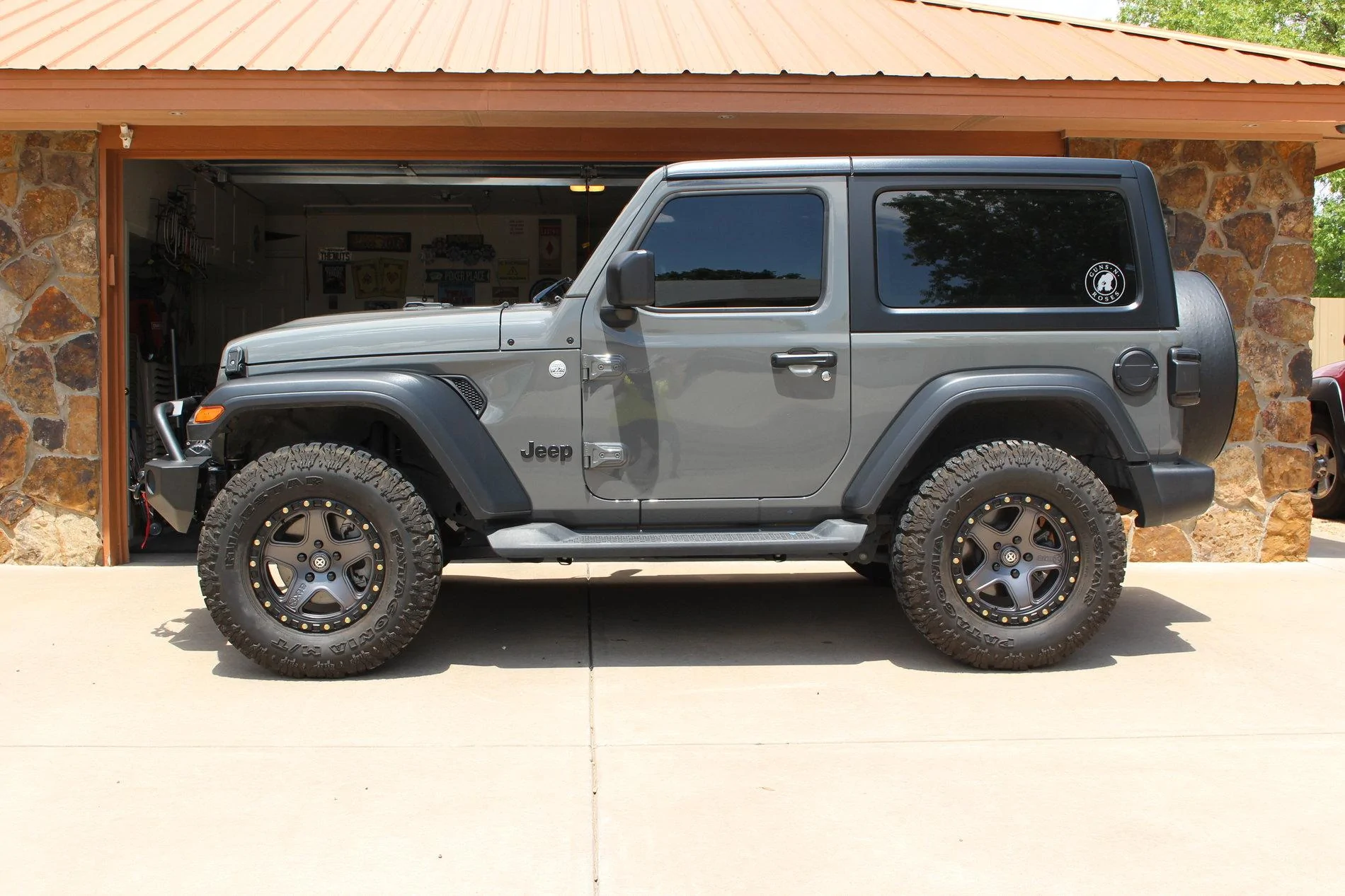

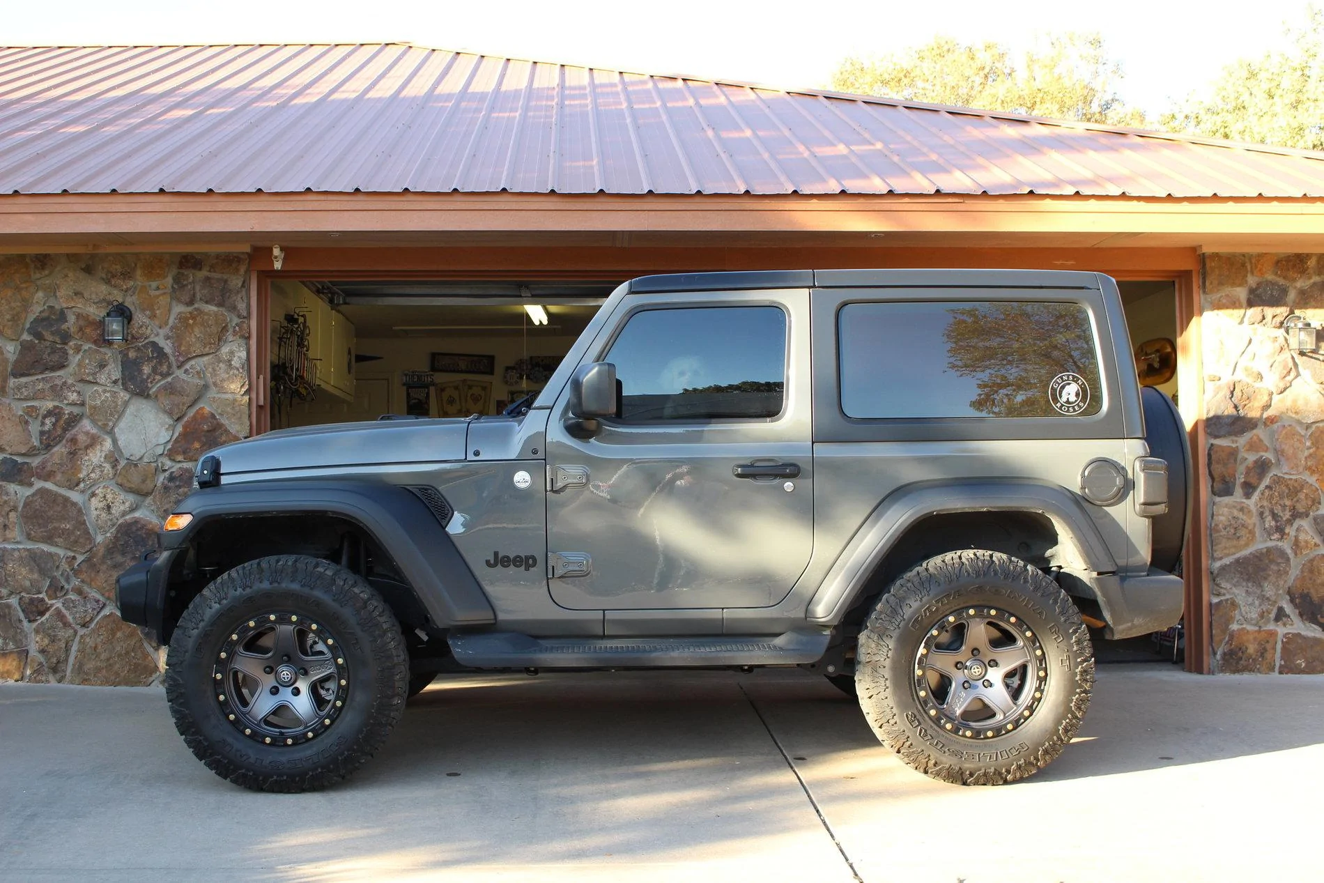

Here's my 2dr w/ Rubicon spring swap, then added a 110lb Quadratec Stubby bumper and an 80lb Smittybuilt winch, dropped a 1/2". I'll probably add a 1/2" spacer if I get bored, lol, but it's not bad as is.
Not bad at all, new bumper looks good.
