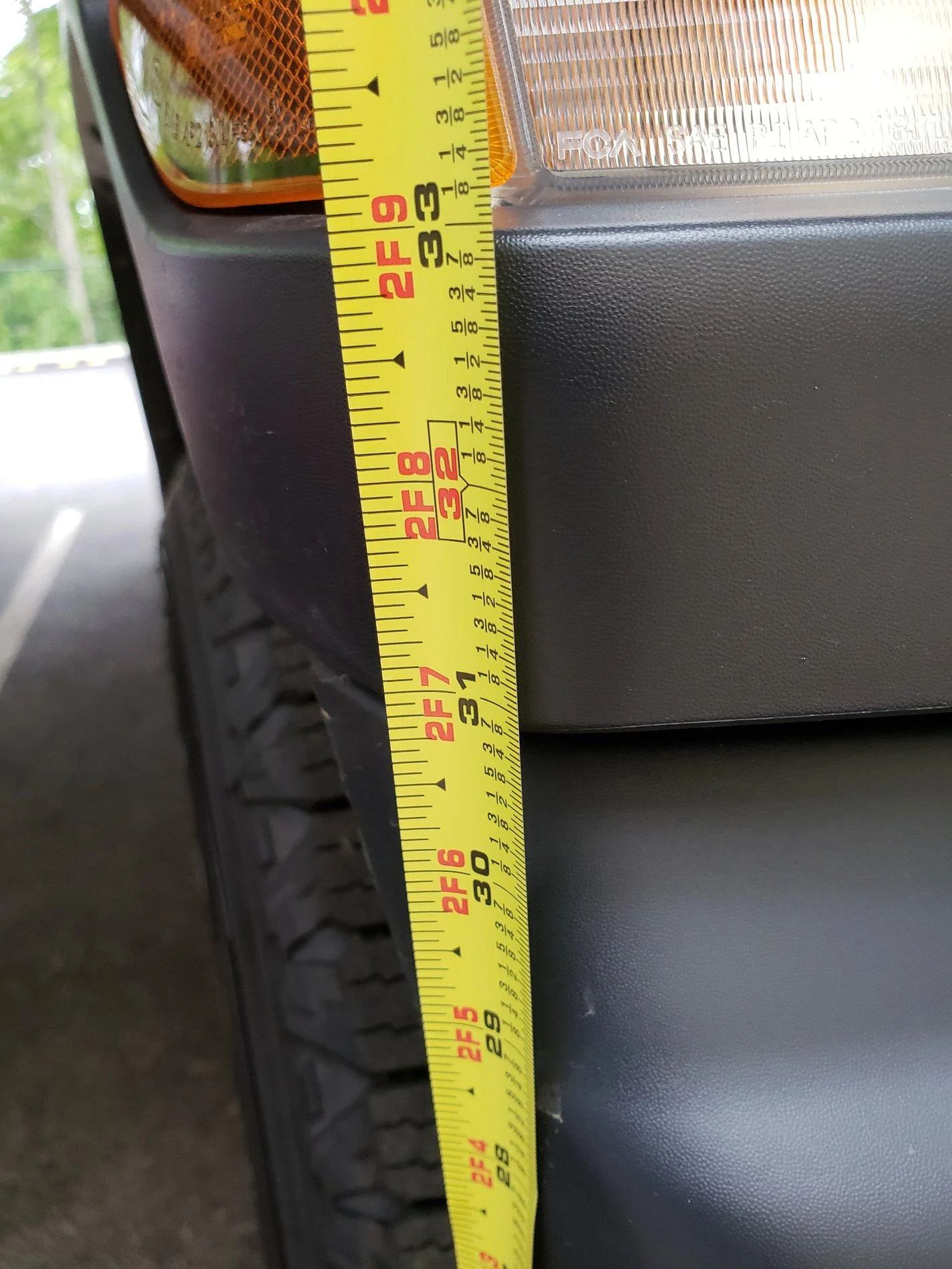

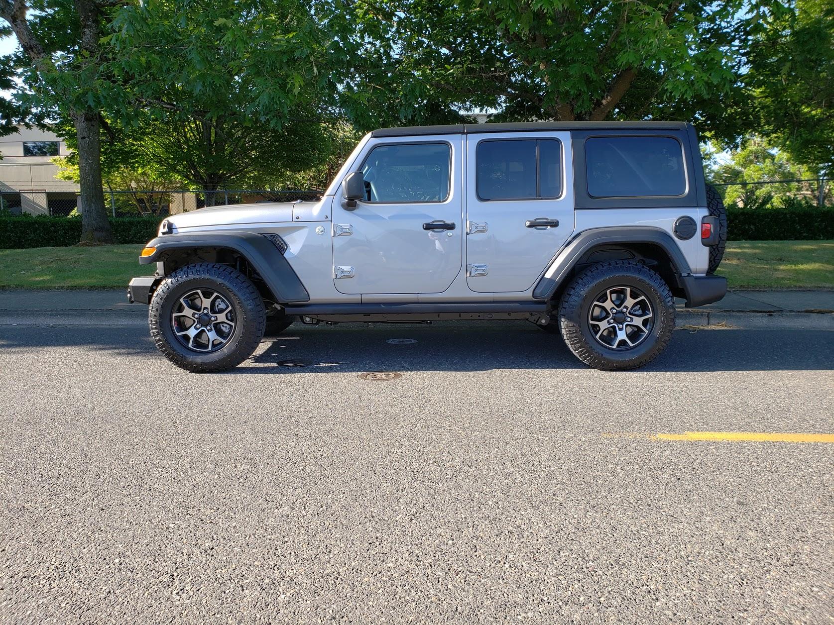

I lost about 1/8" when I installed my Warn Elite Stubby and Warn VR8-S winch... Not bad all things considered. I have since added a Rough Country .75" front spacer leveling kit to not only balance out what I lost but also raise the front up a bit more.
Before adding bumper and winch: About 32 15/16"
Jeep Wrangler JL Winch Weight on Suspension befor

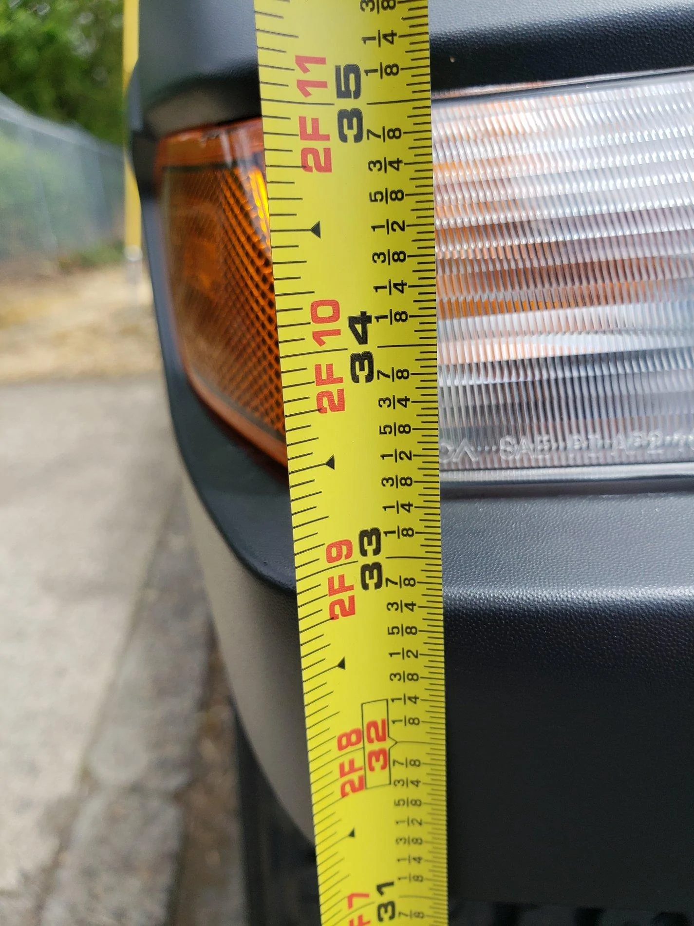

After adding bumper and winch (but before .75" leveling kit was added): About 32 13/16"
Jeep Wrangler JL Winch Weight on Suspension after

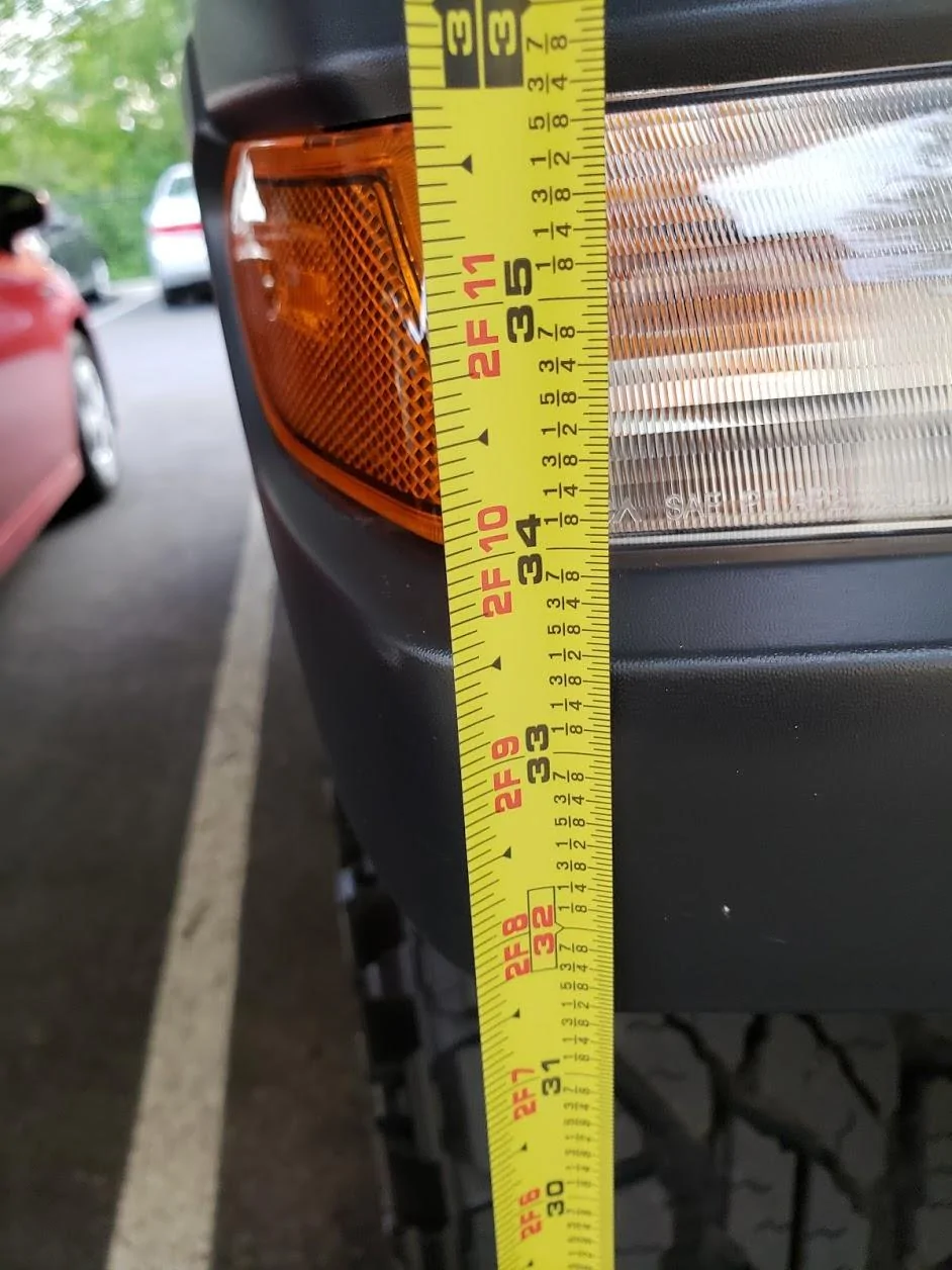

After bumper, winch and front leveling kit added: About 33 1/2"
Jeep Wrangler JL Winch Weight on Suspension 20180624_201713
Jeep Wrangler JL Winch Weight on Suspension 20180621_180834
