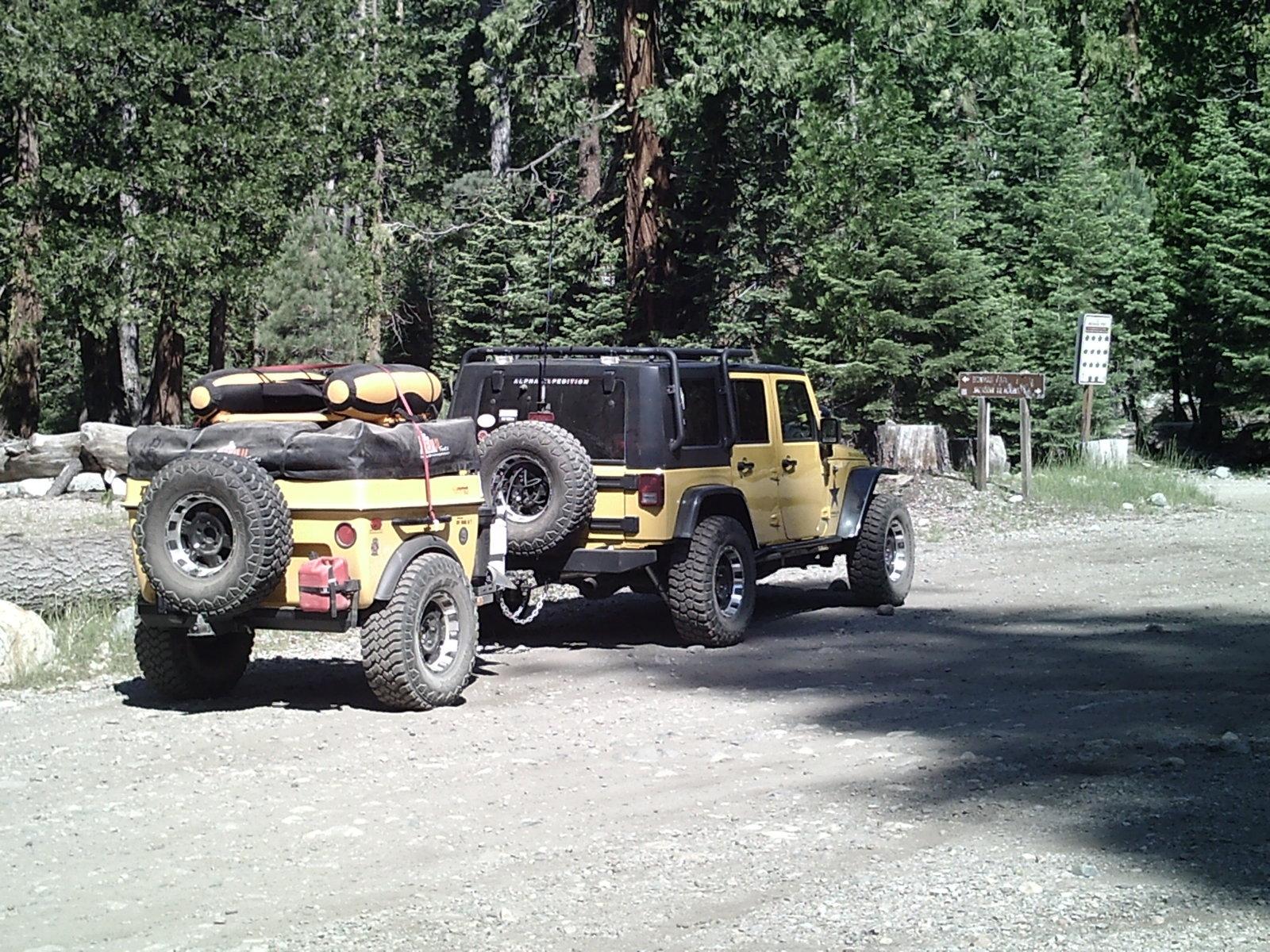

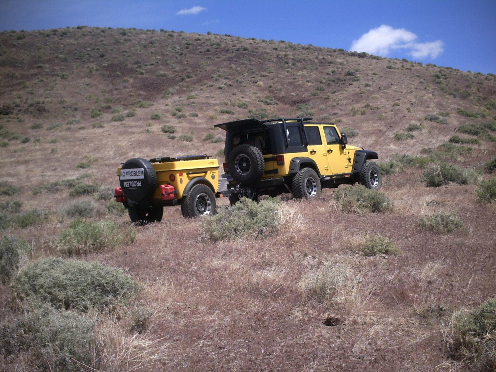

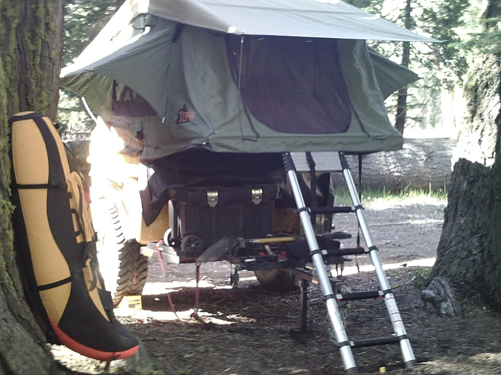

Getting a trailer, 11 years ago changed our whole camping/hauling life--
Then I put an RTT onit and that really freed up my jeeps-++I haven't had a chance to towit with my JL YET, but soon I'll be back in Nv-
