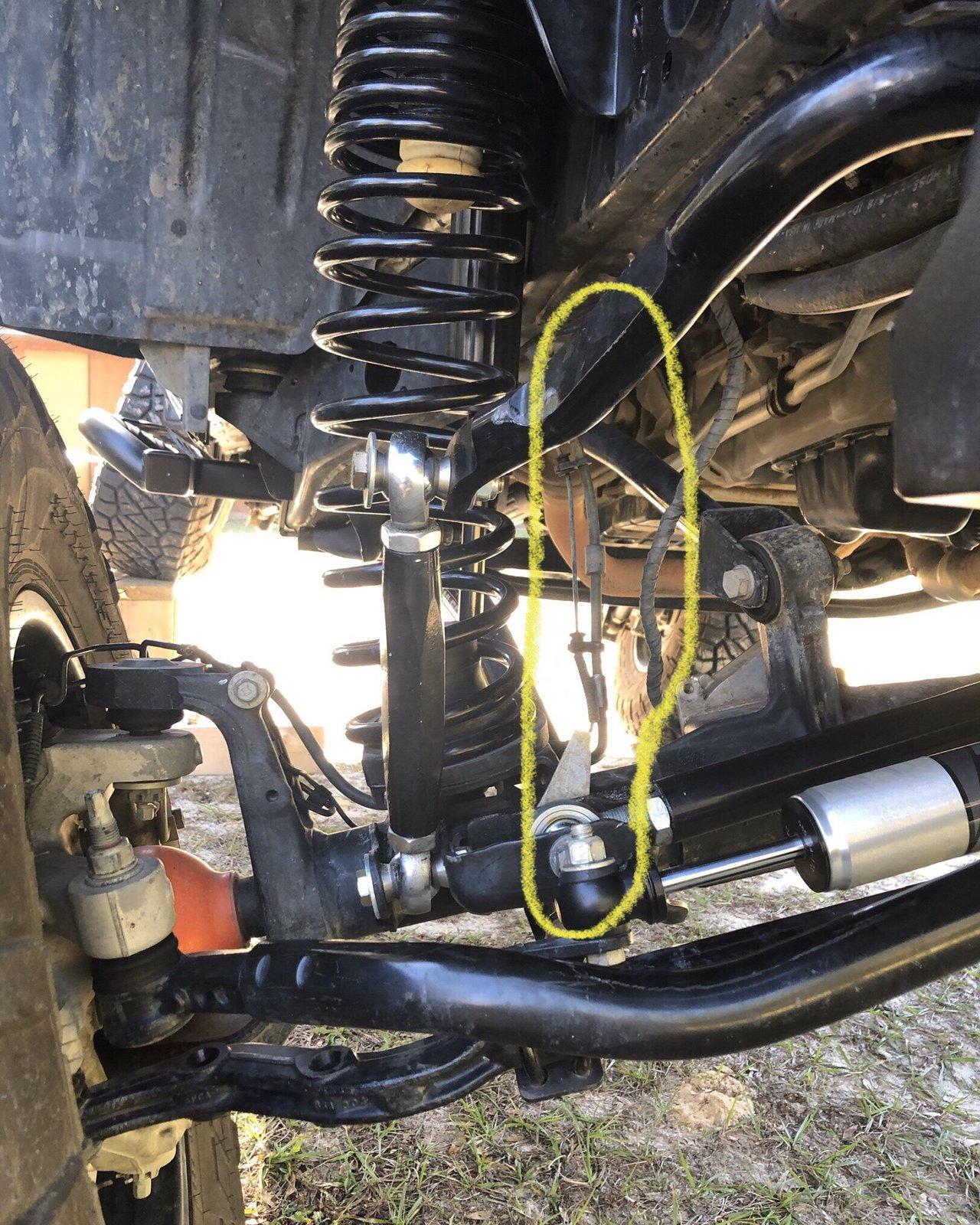

As these guys said, your fine. I’m on 3.5” and here’s pic, might help........

Yeah...... I didn’t trust myself to pry bracket off that hooked to stock control arm, I used grinder and cut the bracket off, left the pinched on piece on the brake line. Lol.

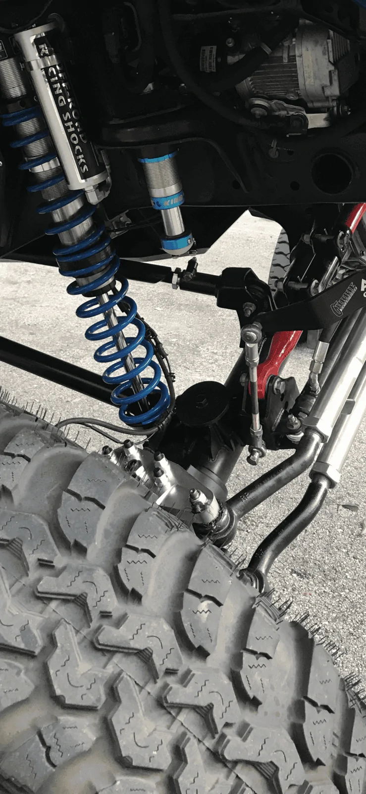

I attached a pic to the above post so you can see how I routed it.
Sweet dude, thanks. I’m not having any issues with my current setup, but am planning to increase shock travel, so this is a must do.
appreciate it...... just ordered a set.
