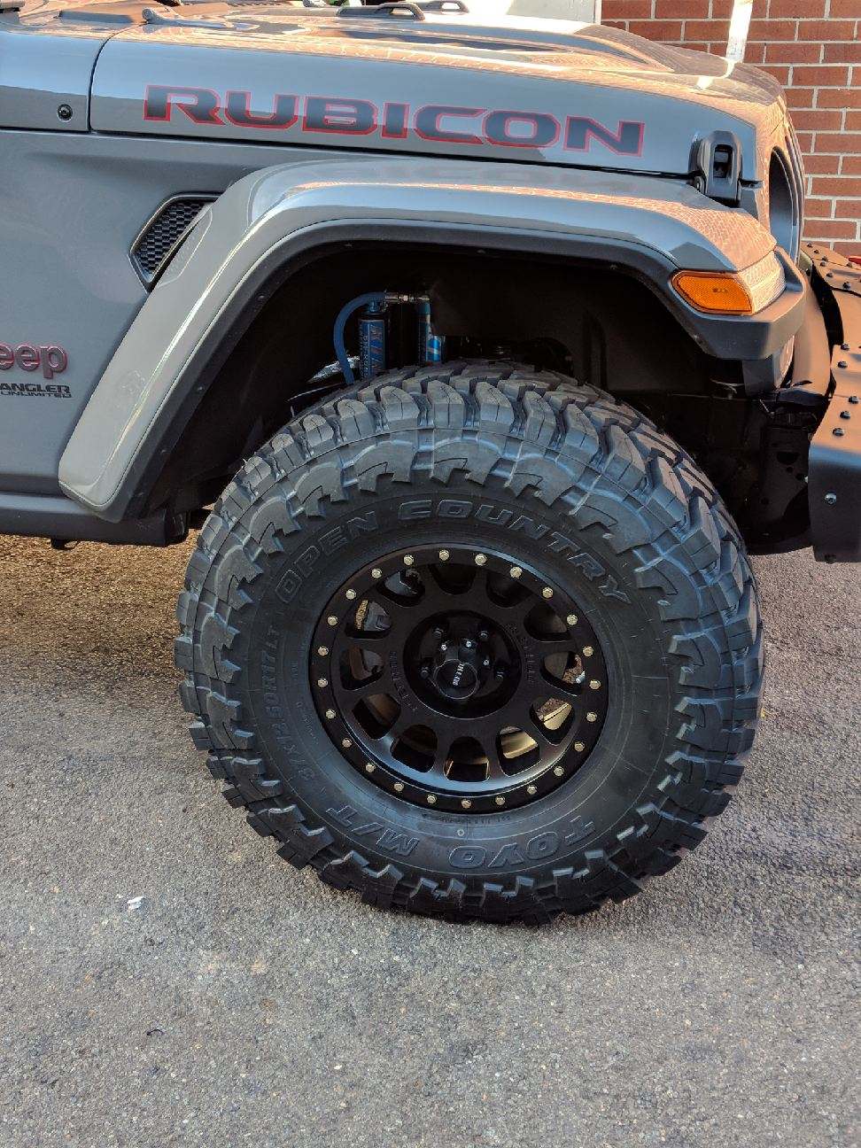

Noticed the installer has the fender liner behind the reservoir. The King instructions say to have the liner on the outside. Not sure if it makes any real difference but the hose does move when the suspension moves and you might end up with the liner edge rubbing on the hose. Might be worth an email to King and show them the picture. They were pretty quick to respond to a couple silly questions I had.
I just sent him a message w/what you just provided...hope it's not a huge issue or if so, an easy fix.

I'm sure it will be fine but its an easy fix. Not trying to cause a panic. I actually ended up doing a bubba on my install and cut the fender liner so I could get at the top bolt more easily. One of these days I'll trim it more neatly.

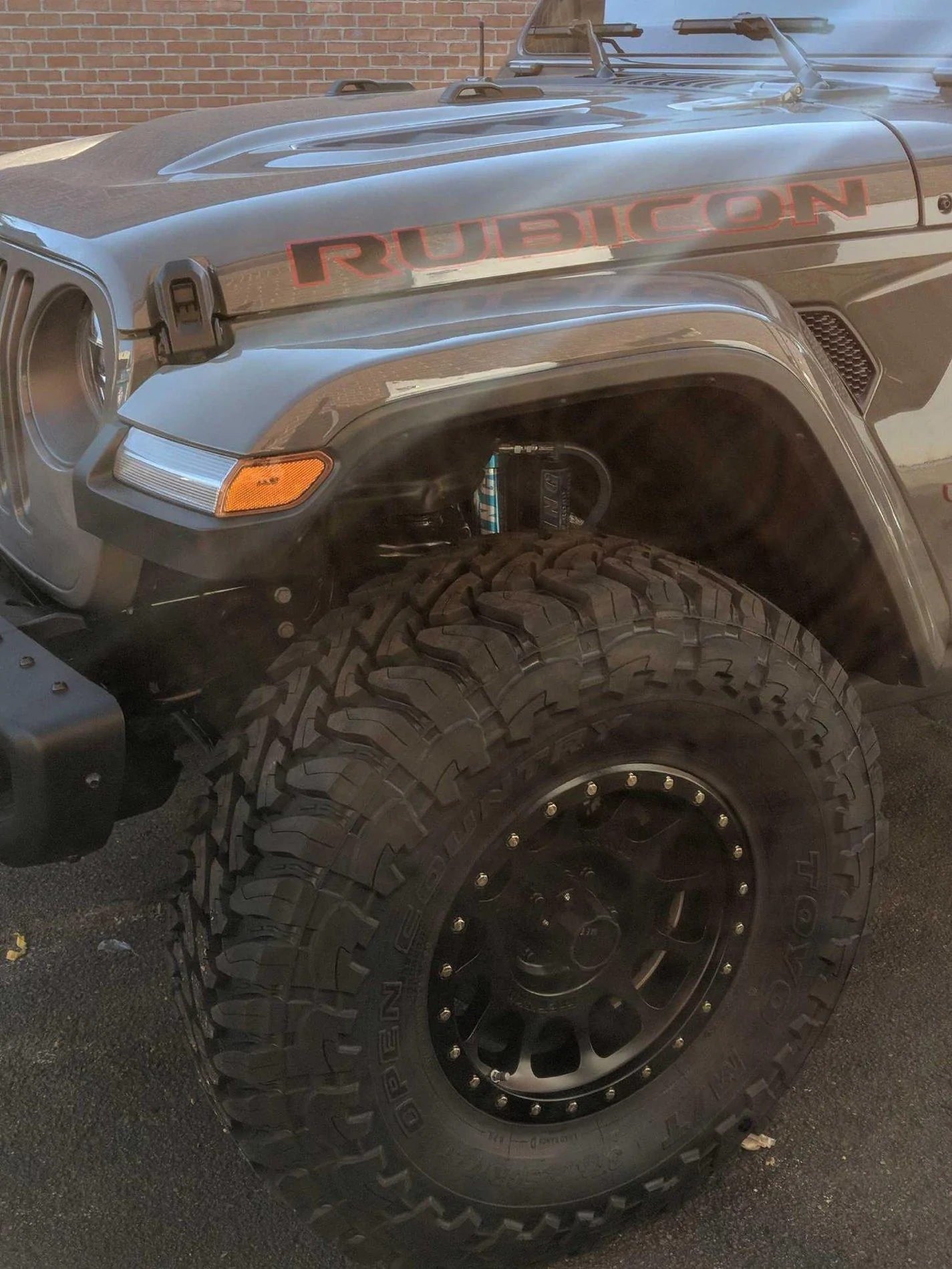

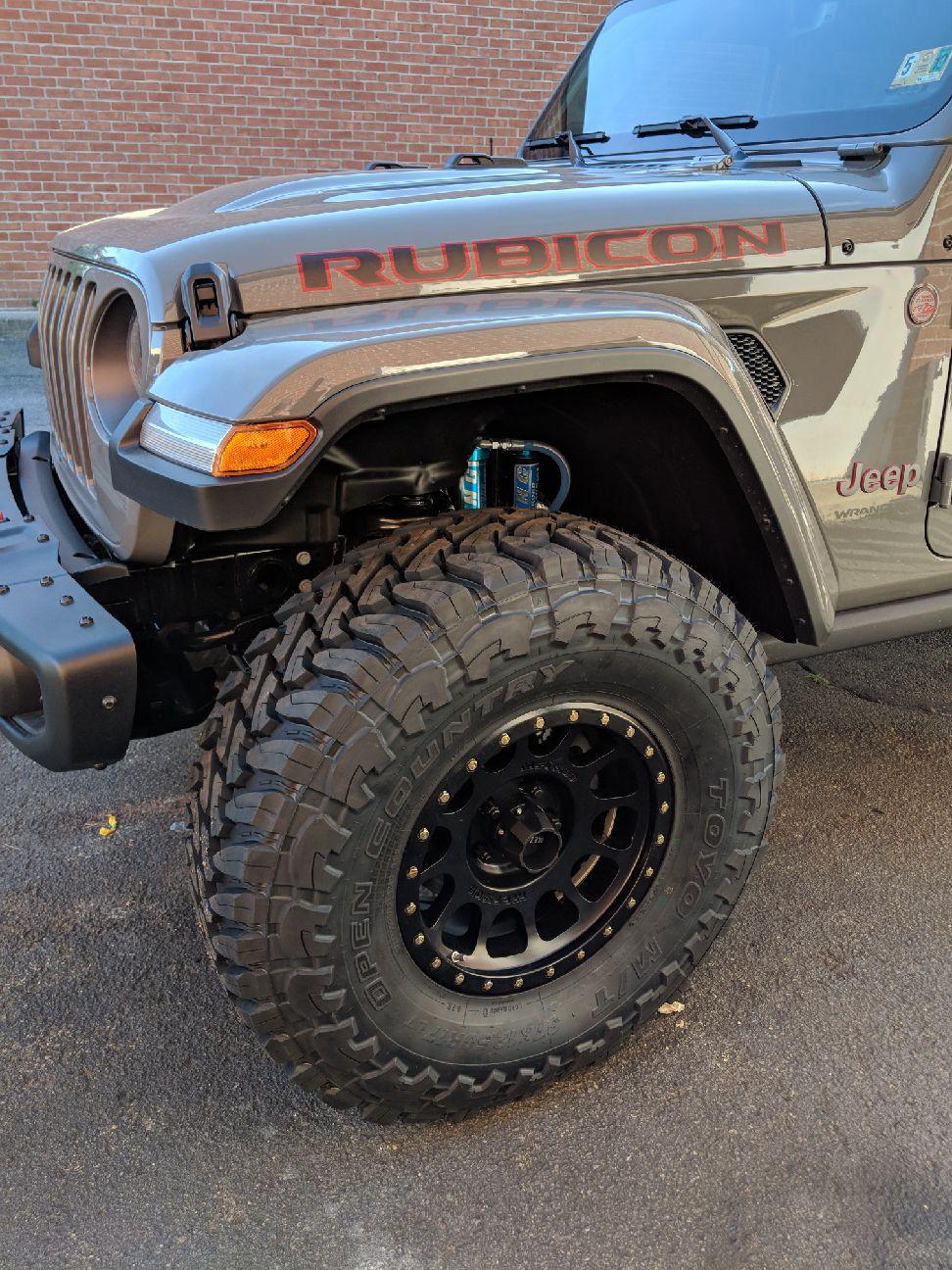

A few quick pics.
