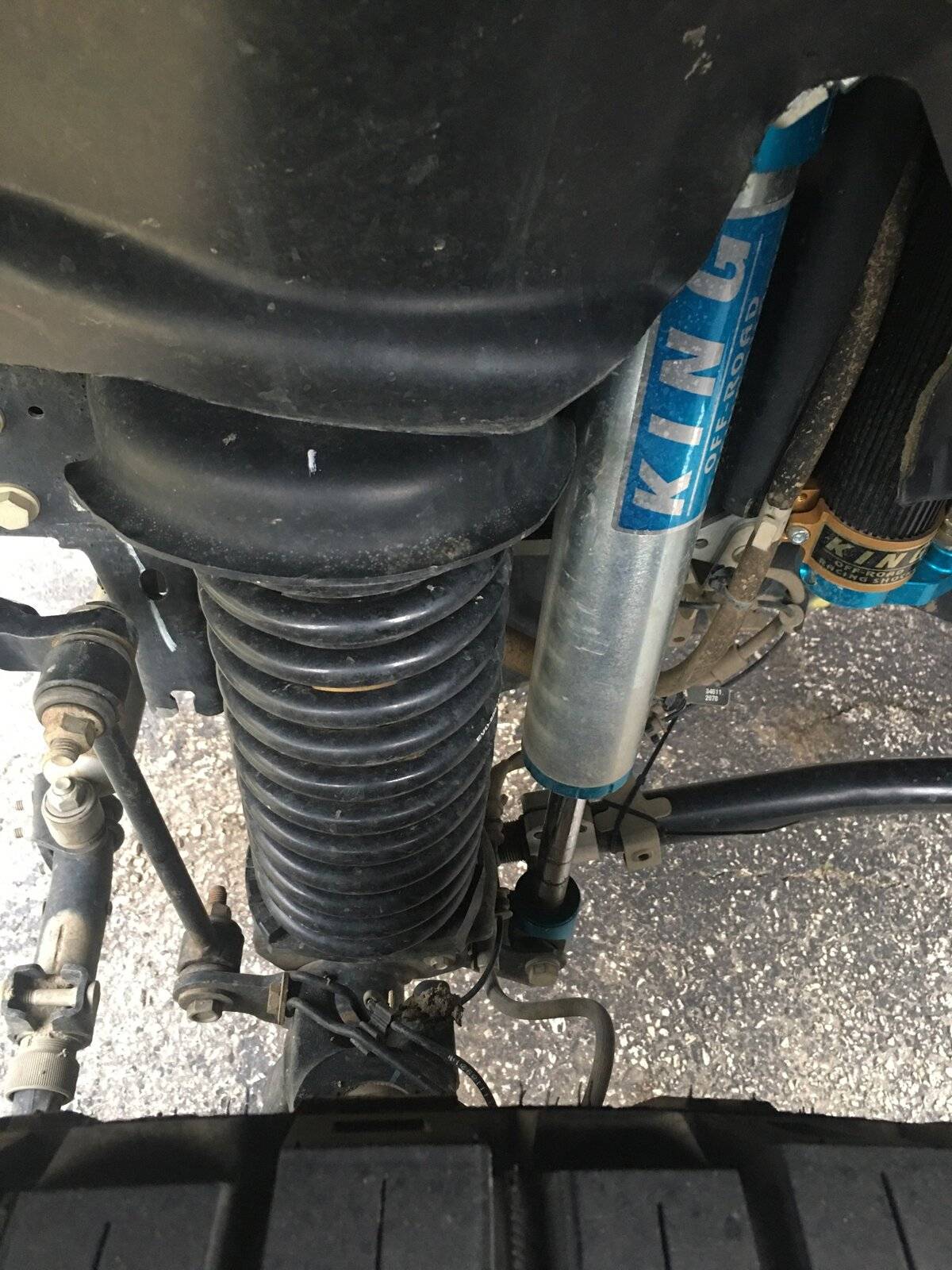

I recently purchased an evo lift kit from northridge4x4. After the install, I noticed the passenger front spring had a massive rearward bow to it almost touching the shock.

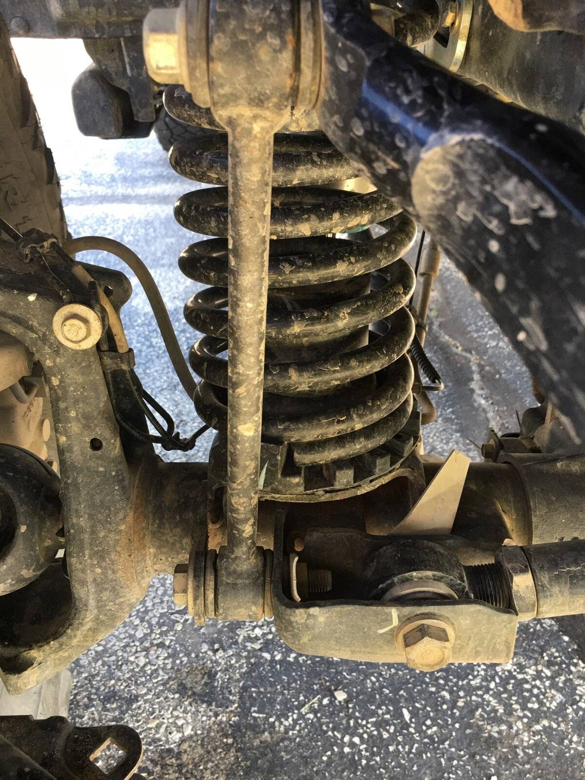

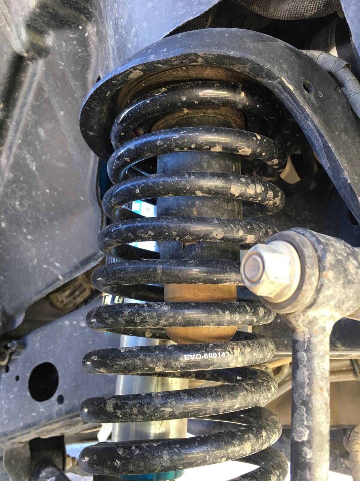

I checked the driver front, no problem there. I then checked the part number on the spring to see if it was on the correct side and checked the make sure it was seated correctly on the top and bottom isolators, everything checked out.
Jeep Wrangler JL Evo Mfg extreme coil spring bow IMG_3333
Jeep Wrangler JL Evo Mfg extreme coil spring bow IMG_3335
I then emailed northridge4x4 support to see what my options were. After a few email back and forth, the suggested I use a drivers side spring isolator ( Mopar Part #: 68342245AB ) on the passenger side spring where I'm having the problem. Ive personally never heard of this and it was also never mentioned in the evo instructions. Is this a legitimate fix for spring bow or is this a quick suggestion just to get me of of their back? I'm not sure whether I should actually try that and potentially waste my time or just ditch northridge all together and buy a new set of coils from a different site.

Can I see pic of drivers side ?
Roky
Roky
Oct 4, 2018
10,704
29,331
Being that the drivers side looks good, then my best guess is that it’s an isolator issue. You can get some RK bottom isolators for around 30.00. They correct the problem most of the time. I have to ask, even though it’s probably not the case, but are the control arms the same length side to side (passenger to driver).

I have an EVO overland lift, and both of my front springs bowed. I put Rancho spring perches/isolators (probably incorrectly mixing terms) on and the springs were immediately straight.

I did the same with my 3.5 EVO Enforcer lift, Rancho spring isolators fixed the bowed spring issue for me too. I had heard EVO was now including the spring isolators with their lift kits, guess not.

Nope. Rancho isolators didn’t fix my bowed springs.
I have the 6.5” plush coils and they bowed so badly forwards.
My passenger side was made to bow more rearward but now inboard bowed, after cutting the rear of the Rancho isolator.
Driver side spring bows back and hits my trackbar reinforcement bracket even when driving over very small bumps.
Can’t cut the Rancho isolator on that side because it already slopes the way I would need.
Tired of this.
EVO said,”One out of every 10 or 12 spring sets will bow. It’s normal. Add isolator pads and more caster.”
