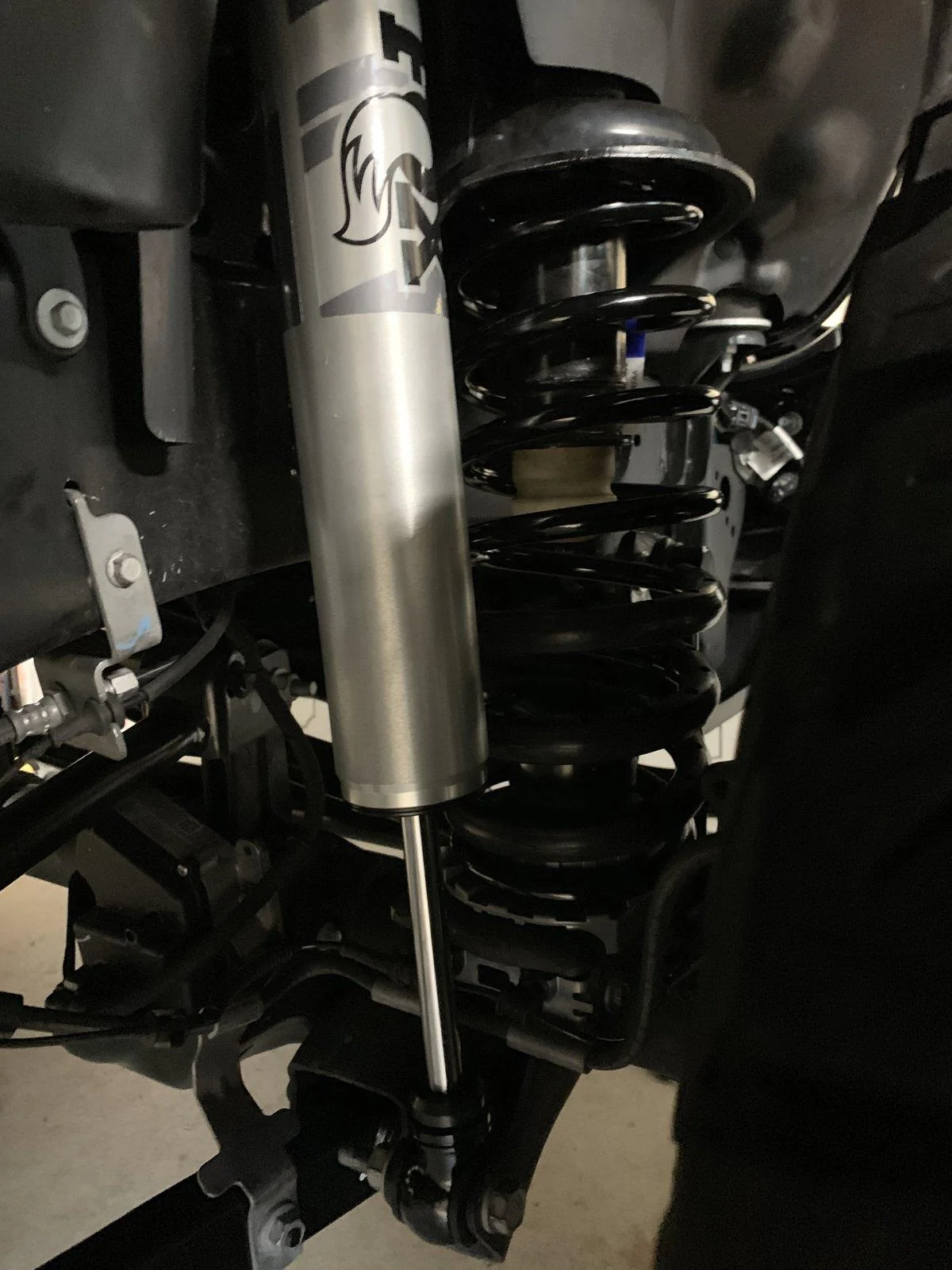

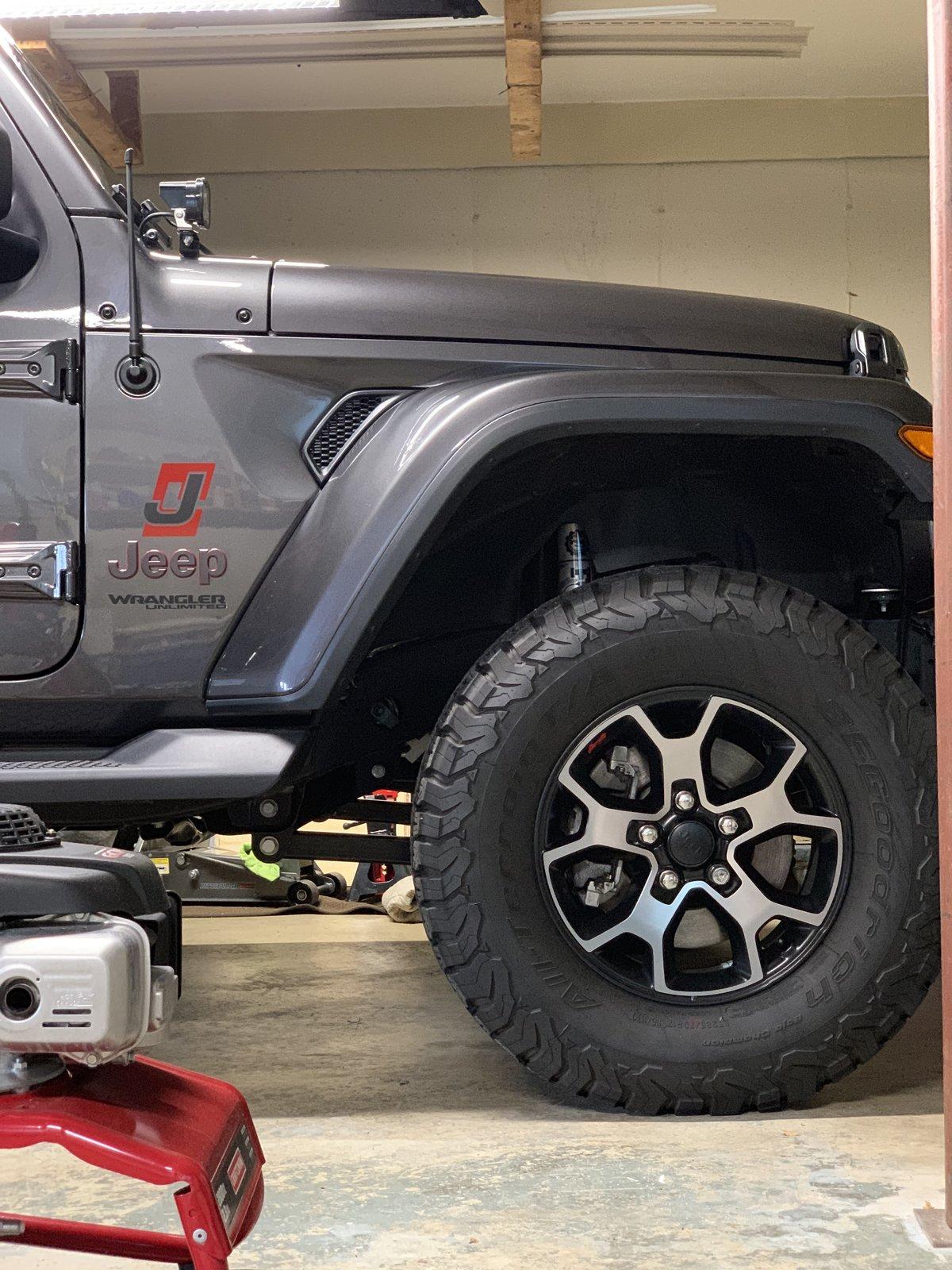

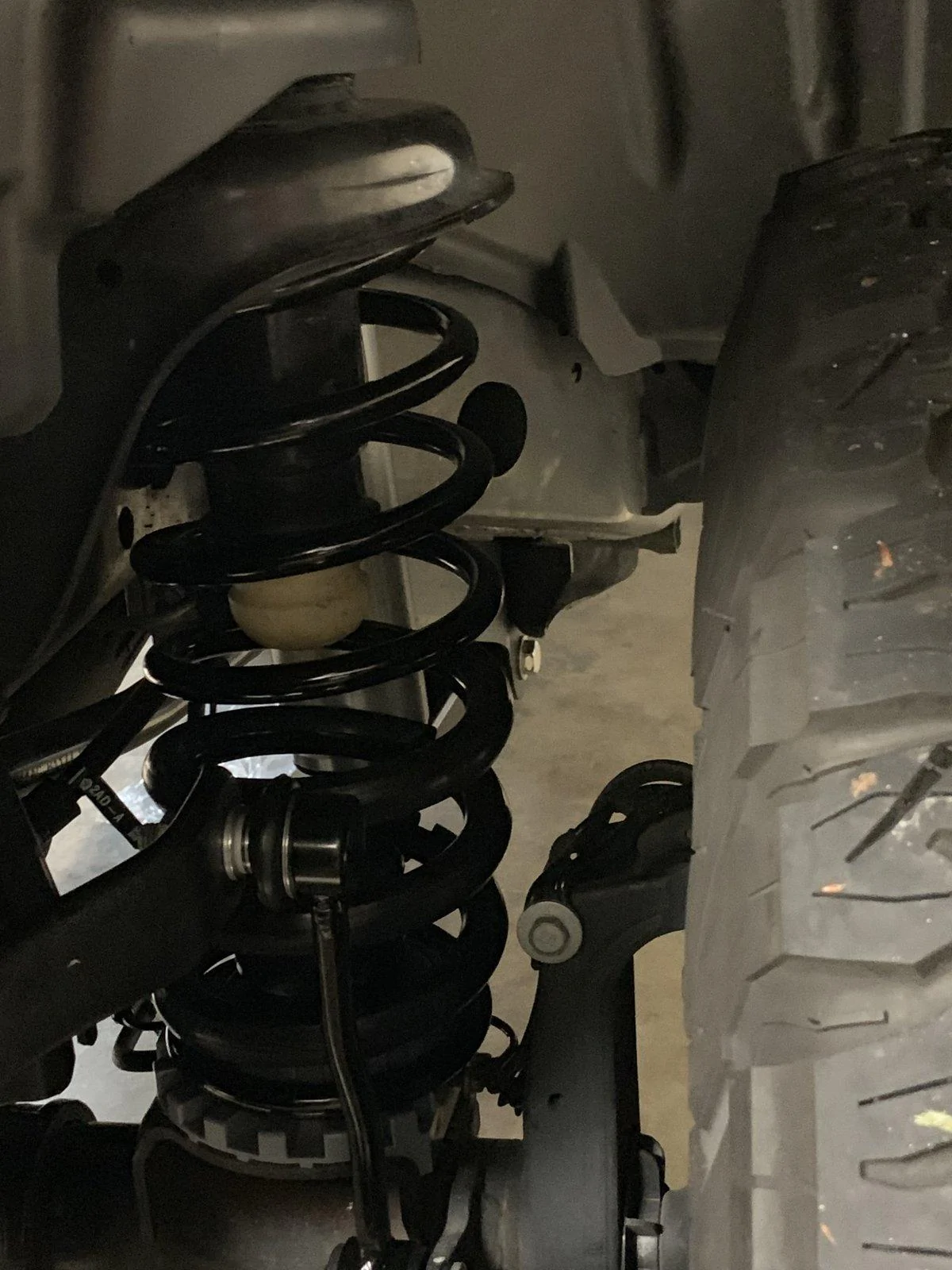

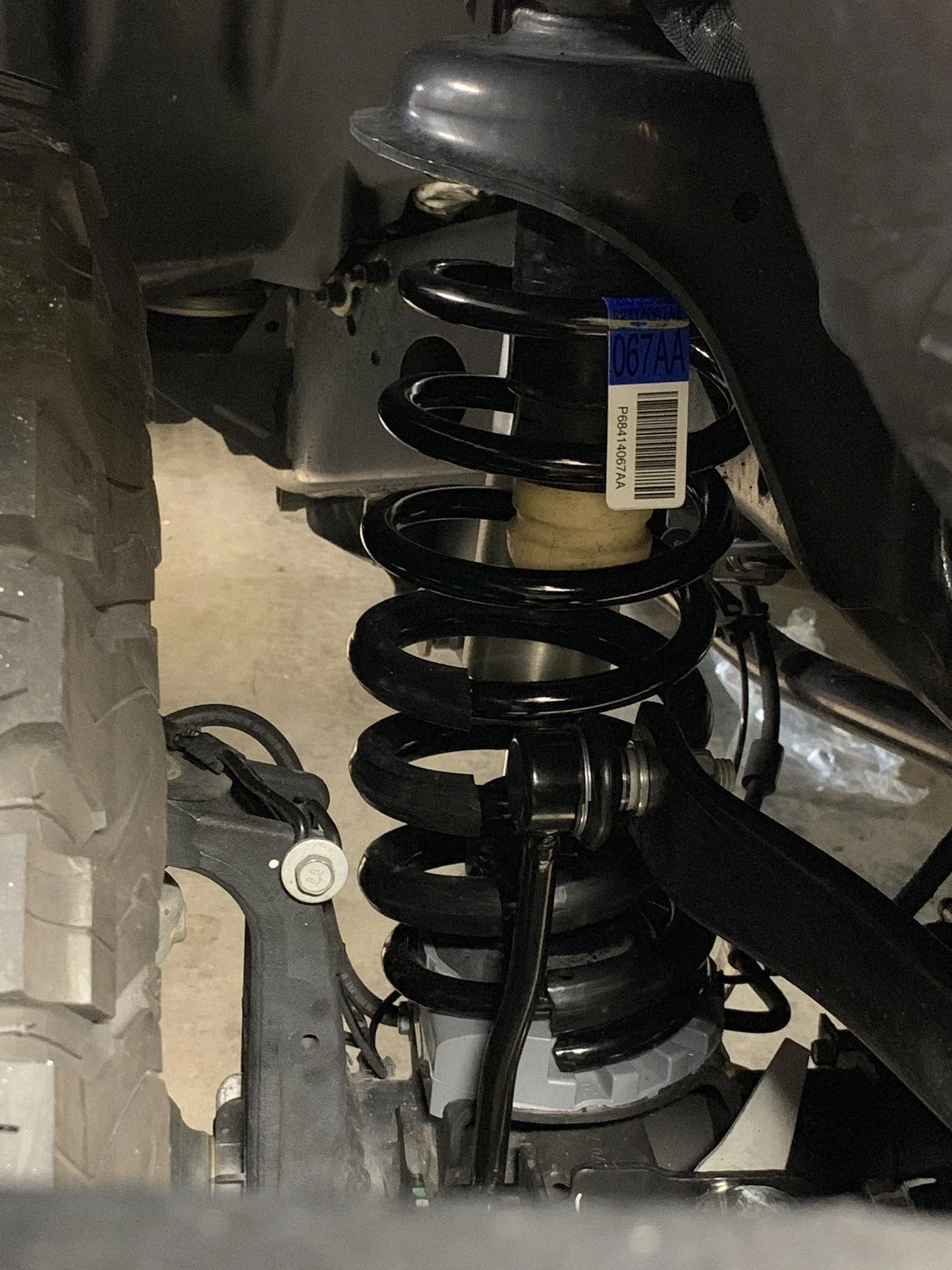

Just wrapped up an install of the Mopar 2" lift, with the addition of RK adjustable front track bar and EVO MFG Correction brackets. I have to say I'm impressed at the ride comfort over what I had before (RC spacer lift), I have much less body roll and a smoother ride. As far as steering is concerned I haven't notice and wandering on the highway or bump steer, however I do have a fox steering stabilizer as well. I also decided to use the Mopar spring pads instead of the RK correction pads, I wanted to see how these performed first. As far as spring bow is concerned its minor at all if anything it looks just like the instructional guide shows but time will tell as I put more miles on the kit.

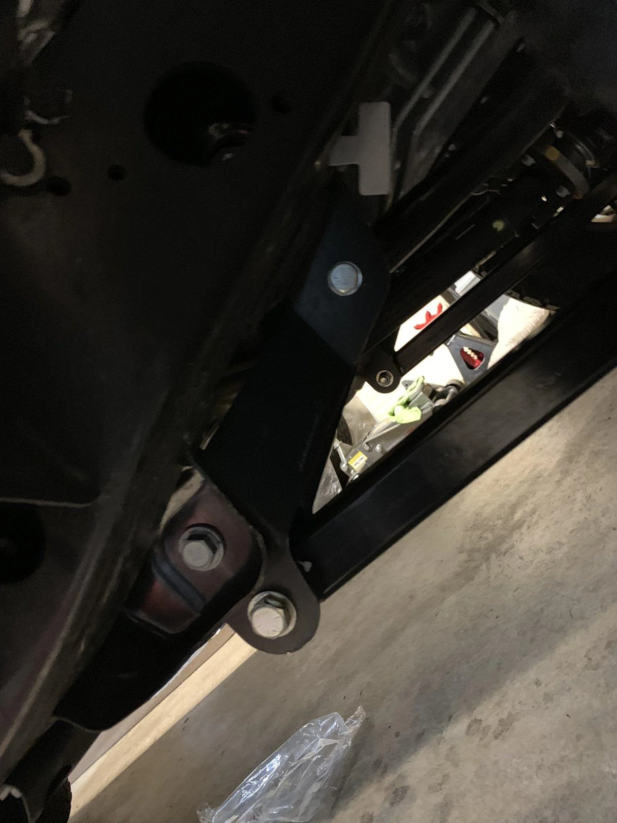

Jeep Wrangler JL Mopar Lift Installed with EVO MFG correction bracket 2F0881A7-3D38-497D-8381-8DA0B1FECD2C
Couple of questions. After having the Evo drop bracket for a month, is it a big improvement to the your ride? Does the bracket adjust to the size of your lift? How far below the stock LCA does it sit now?
So before I had the LCA bracket I had a RC lift and the steering was a bit loose. When I installed the Mopar lift and the LCA bracket I can drive on the highway at 65 and let go of the steering wheel and it tracks perfectly. It sticks down about 1.5-2 inches compared to the original LCA mount. Also as a side note I do have front and rear track bars from RK. In the picture you can see the bracket clearly.
