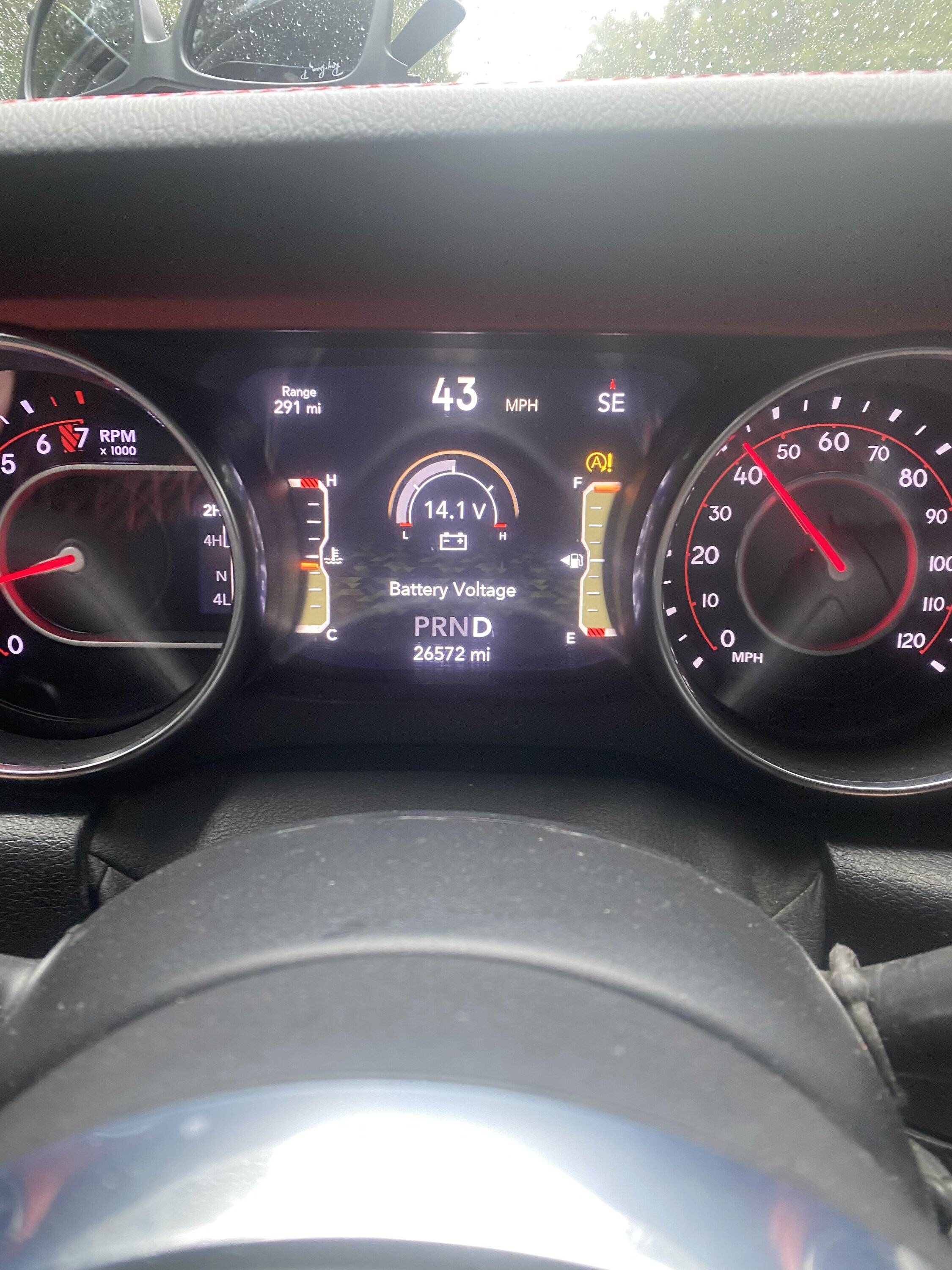

So my warning light came on yesterday. Not batteries were replaced last Friday. I also have a Tazer mini installed. And had the system shut off. Any advice on how to reset it

A faulty hood switch could cause that.

I had this happen from bent pins in a door connector. If you had the doors off, check them.
