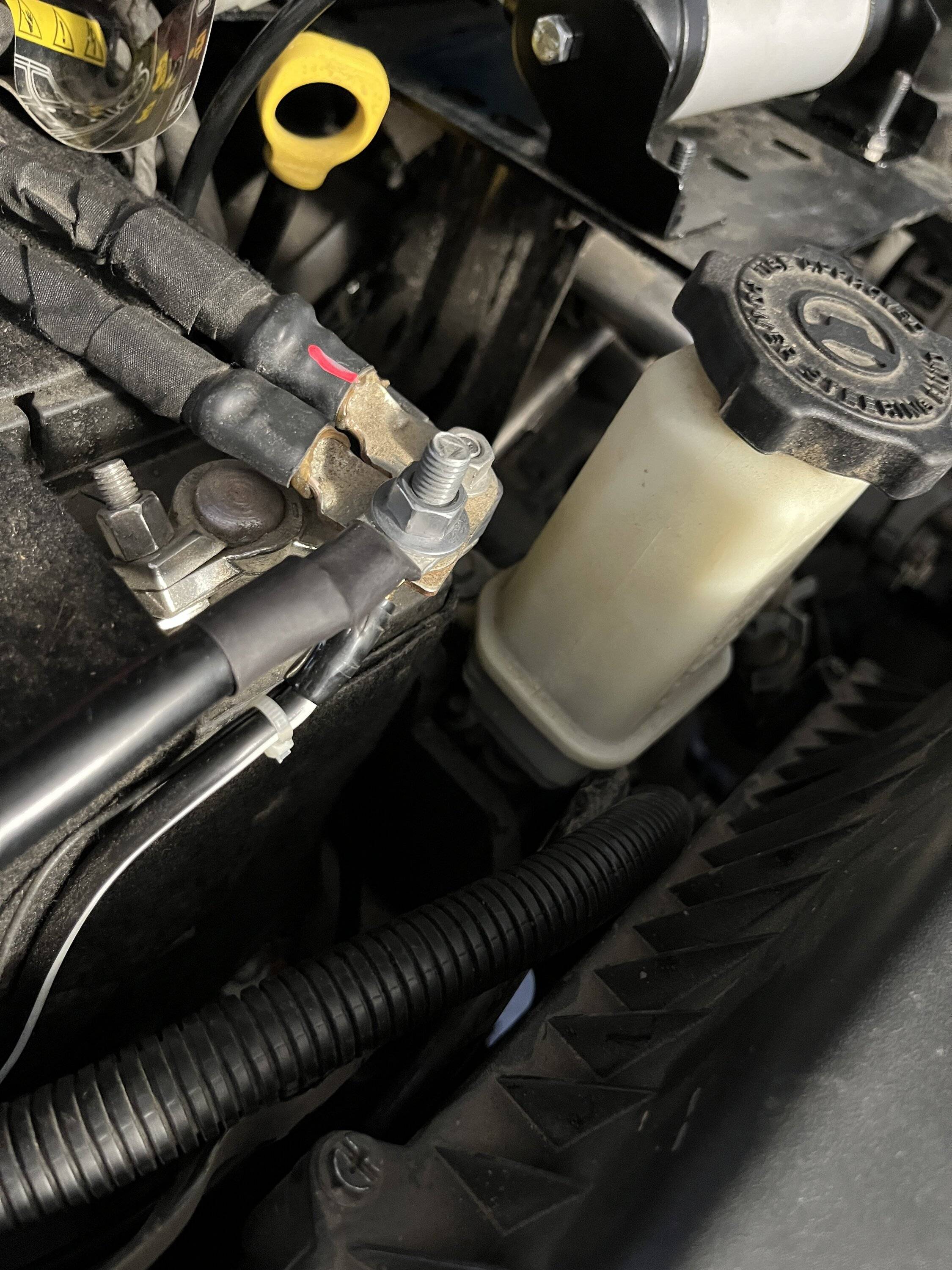

I just re-geared and came upon this thread. Just want to make sure I'm doing the correct thing. Pic below of my battery. So I need to disconnect all 4 of those wires, make sure they are separated, wait a bit, then hook back up? Do I kneed to disconnect the positive at all?
