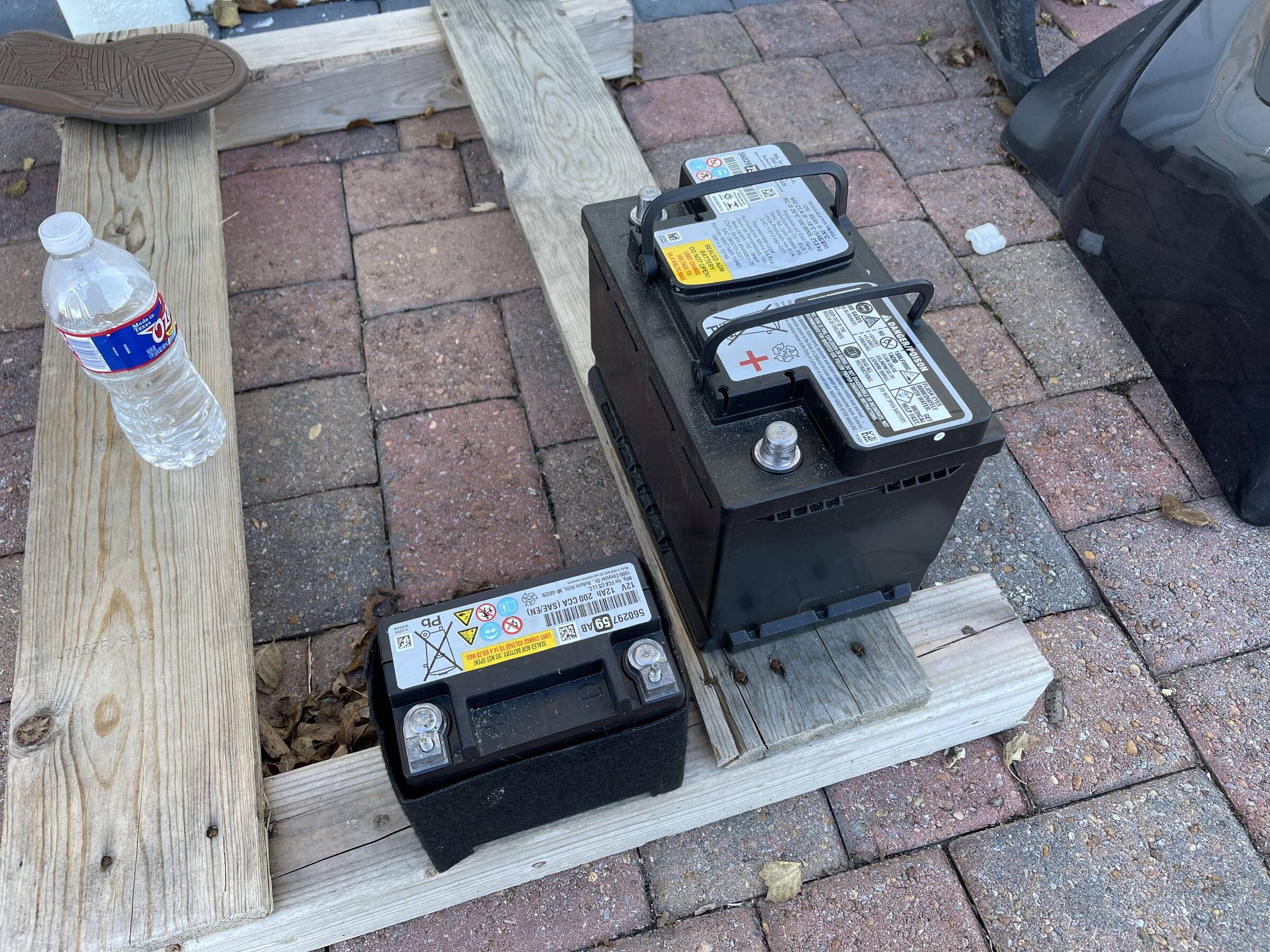

Hello Tord from France, here the 2.2 diesel is very common. The ESS battery is a reference Mopar 56029759AB and model YTX14-BS and exists under the brands Yuasa, Varta, Exide etc. etc. do a search with this reference. The price here in France varies between 45 and 75 euros for the most premium . Features 12V 12AH. Dimensions approximately 150x87x146. Your garage has a price of 750 dollars??? he's a thief!!!

I wonder which galaxy brain at Jeep thought it was a good idea to run two different sized batteries on the same electrical system.
